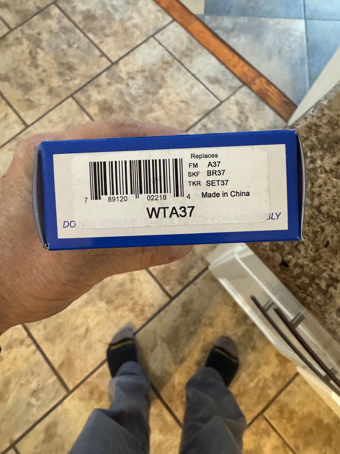

going to need springs as well. buy this bearing break it open and use the tapered bearings as slugs they tap right in about 9$
ca phs=aser lock out still allows for 1-2* of movement. no the best thing. ditch it all and do a vvt delete single bolt cam c5r timing chain and lme cover

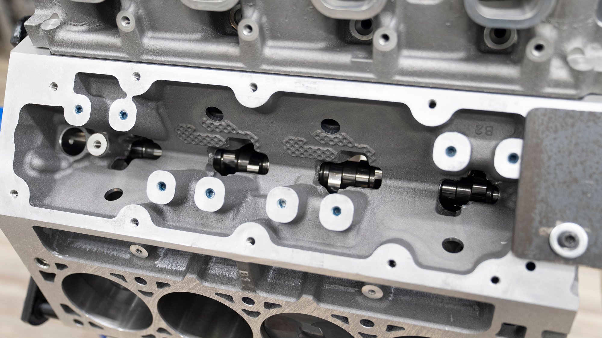

In the below pic of mine, the holes in the lifter valley are plugged. In my case they were tapped and the plugs screwed in. For an engine in the car, just buy plugs that can be tapped in.
Gen V cam swaps are not quite as straight-forward as the old Gen 1/2 SBCs. For instance, you have to pull the heads to get to the lifters. Soooo....read up

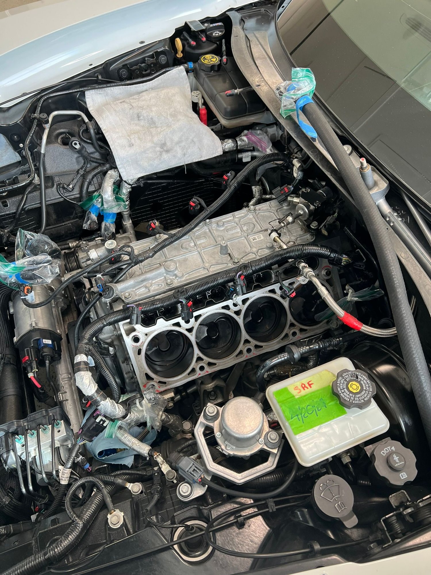

This pic of mine shows how far you have to go for the cam swap....almost. Keep in mind that even in this case, the front cover still needs to come off, the balancer needs to come off, etc so so there is still be work to be done. It's easy to see why insidious disease of "while I'm in there...." is costly on a Gen V. While I'm in there I may as well do headers....and ported heads....and an intake....and....an ATI balancer and ..... Pray for strength to resist this disease!
Edit: And with a big cam you'll need really good tuning. Find a good Gen V Tuner. They are not like tuning older engines.
