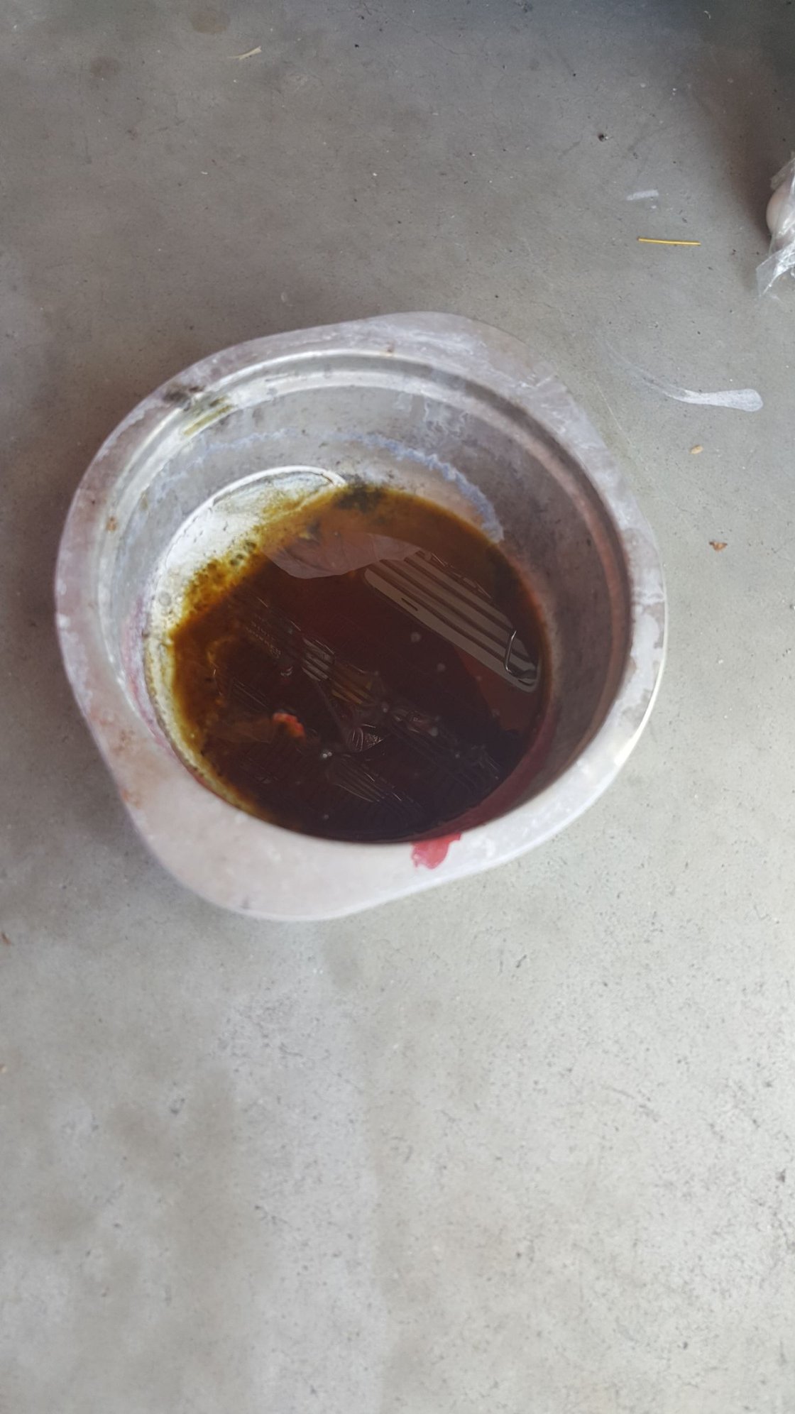

If you think you don't need one, I guess you don't mind this junk going down your intake?

Cars haven't needed them for 60+ years......... Whatever gets in the intake as the pic posted, is designed to be that way. I have never seen a documented case where an engine catch can saved an engine from anything. You can't quantify effect unless you have accurate data on each end & a control.
