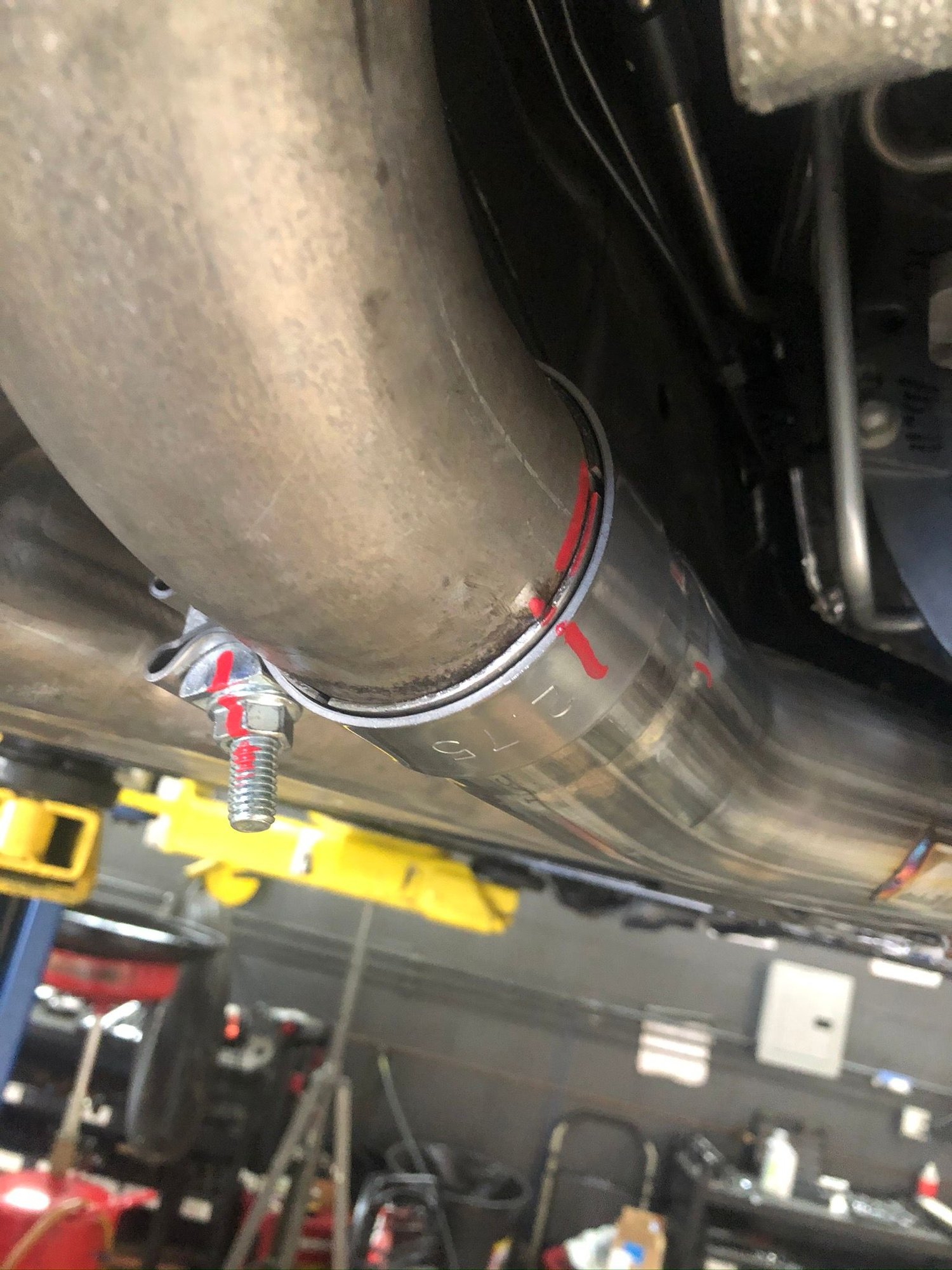

Sounds like someone did something to the ARH x-pipe. The muffler pipe should slip inside. The x-pipes for ARH, Kooks, LG (which I have now), AFE (which I had) all work with the stock mufflers. As I recall, the muffler pipes are 2 7/8" OD but it's been years since I looked.
In the below pic you can see the factory mufflers going into the AFE x-pipe. Somewhere I have the same shot with the LG x-pipe.
