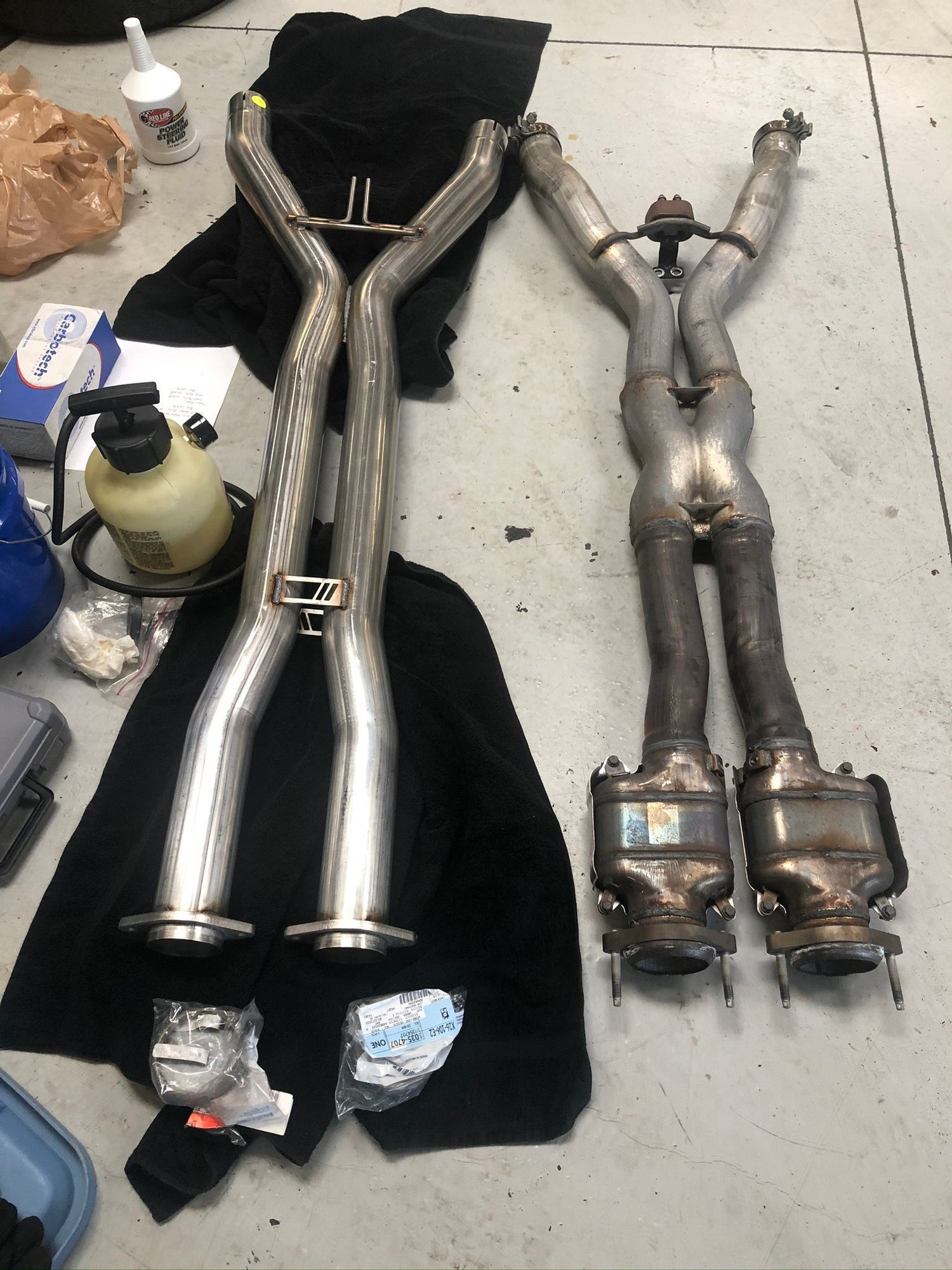

Originally Posted by 96GS#007
It replaces the OEM x-pipe that has the secondary cats welded in place. My old x-pipe was from AFE but it's the same point vs the OEM pipe...

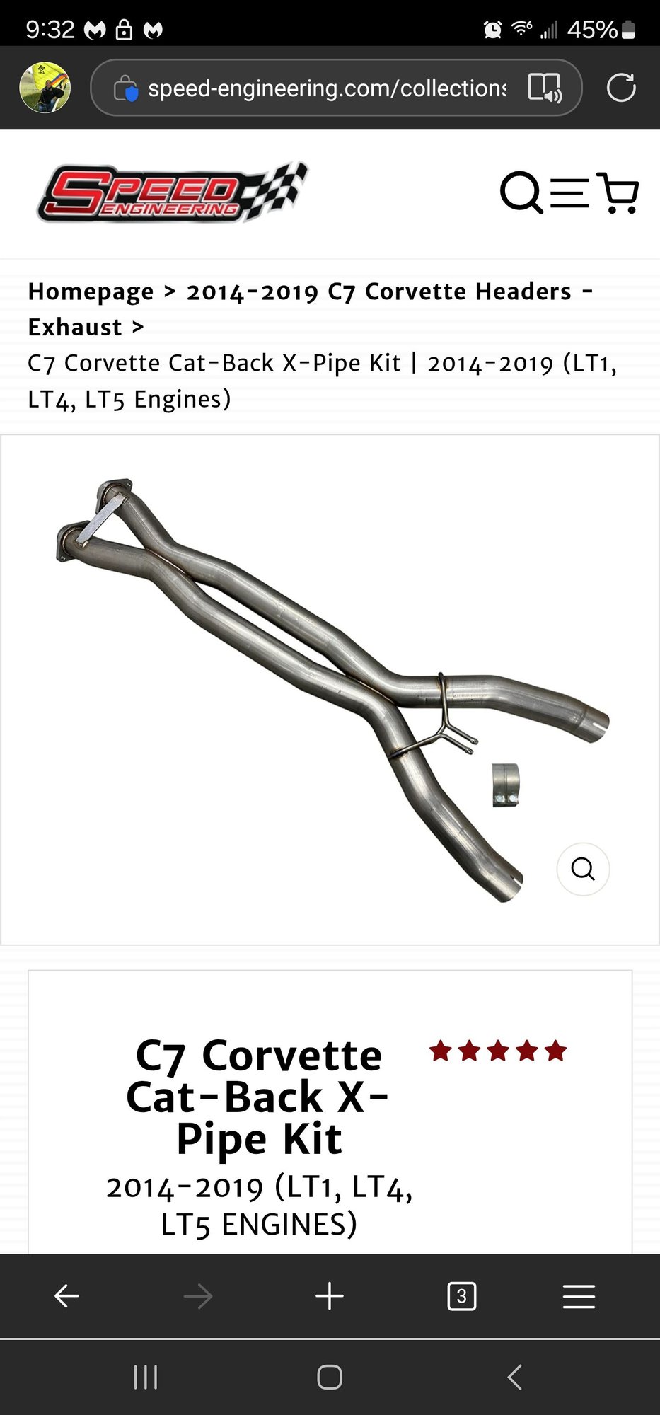

I have never seen the underside of my car so I feel like a bit of a moron: Based on what you say and how it looks, the stock exhaust includes an x-pipe?!?
And if so, rather than replace the entire exhaust, couldn't the same thing be achieved by just eliminating the secondary cats?

Probably,,,, but the cost of eliminating the stock cat's and installing the revised pipe would cost more than just getting the x-pipe.
The new x-pipes are supposed to have better flow.
Yes, the stock x-pipe is on the right of the photo and yes it has the secondary cats that are welded in place. It's not unusual for people to remove the x-pipe, cut off the cats, weld in pipes to replace the cats, and then call it good. Most people like to retain the original parts in case they do find that rare inspector who discovers the cats missing and/or they return the car to stock prior to selling it/trading it in and then they sell the aftermarket x-pipe. When I moved to full length headers, I sold my x-pipe for something like $400 which means I recouped ~75% of what it cost new.

Yes, Sort of.
The aftermarket X-Pipe from Speed Engineering is a double X design that gives better sound than a single X.
