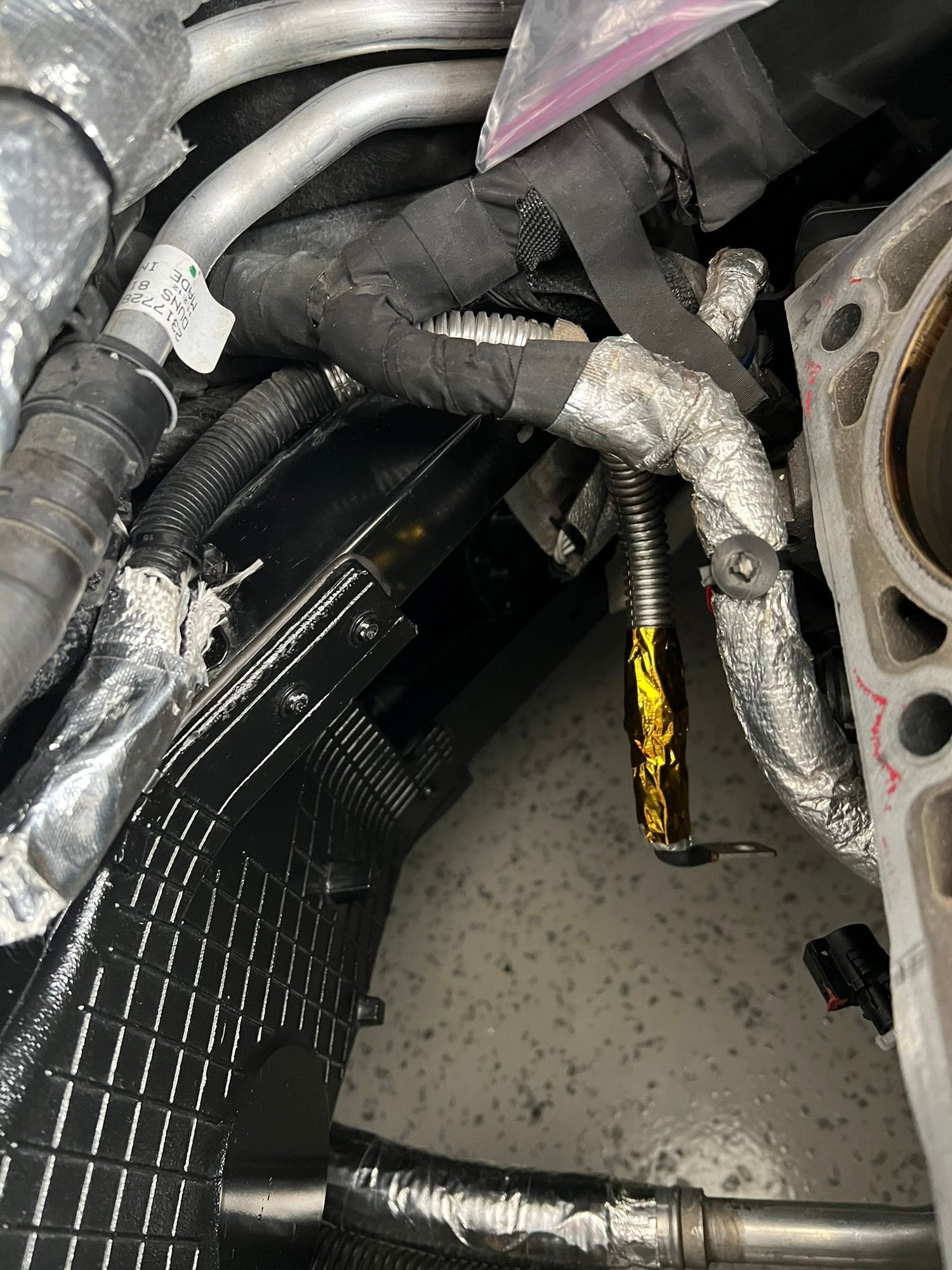

Where I did have an issue was the positive cable that runs to the underhood fuse box. The insulation on mine was starting to melt where it goes to the starter so it's wrapped with gold foil tape now. In addition, where the cable runs across the frame rail to the fuse box was starting to melt and was much worse than near the starter. I wrapped that area with a blanket and (not shown in the pic) and with gold foil as well.

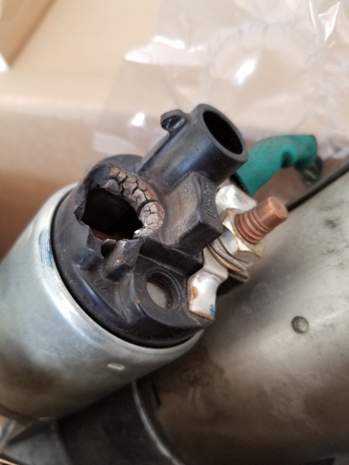

I to had a C6 with headers and experienced a fried selonoid but I think most of the heat damage was caused by the stock exhaust as I did not have my headers on that long before I had issues . Changed the selonoid and drive it for 70,000 miles
Dave
My C6 starter

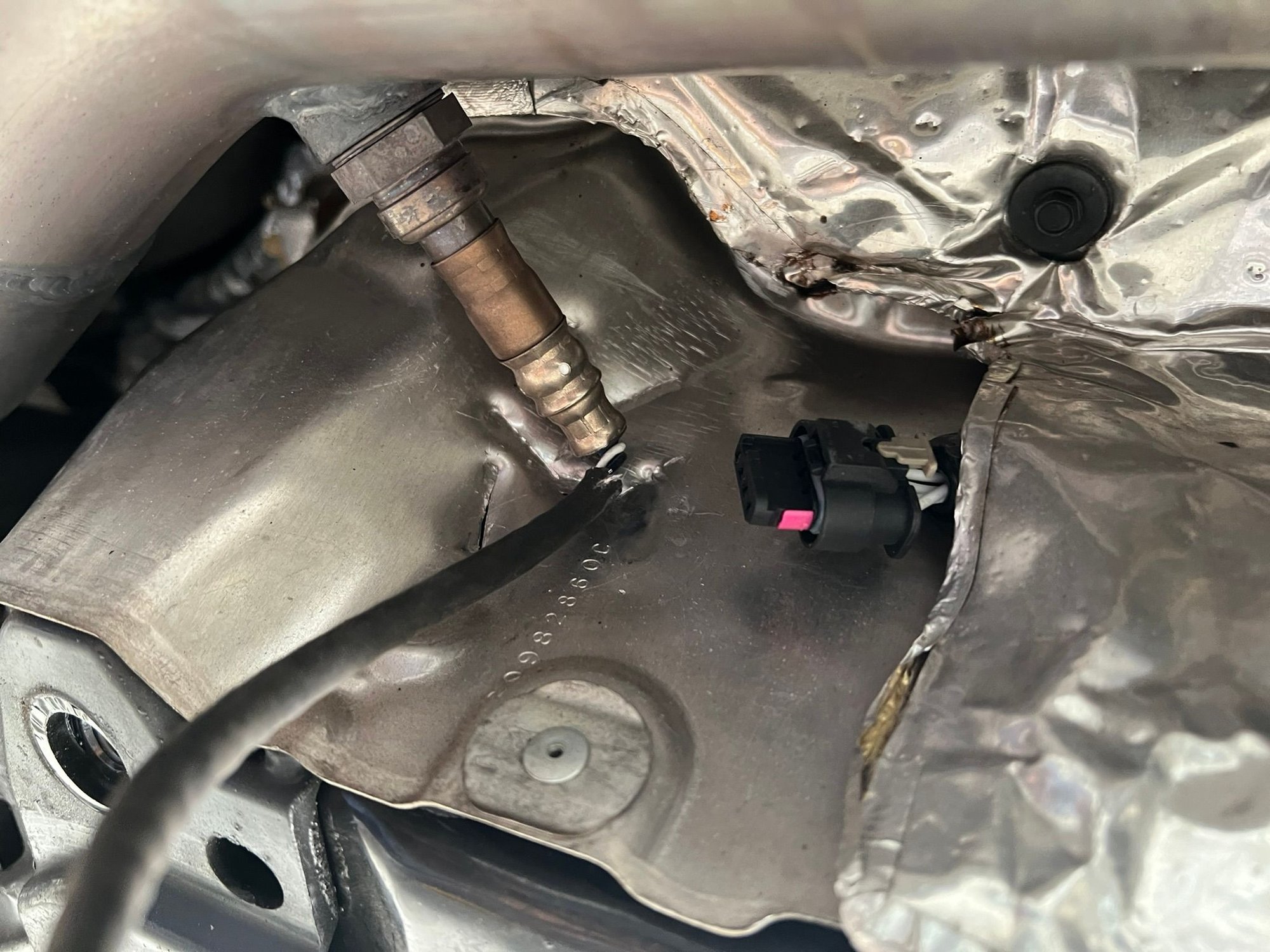

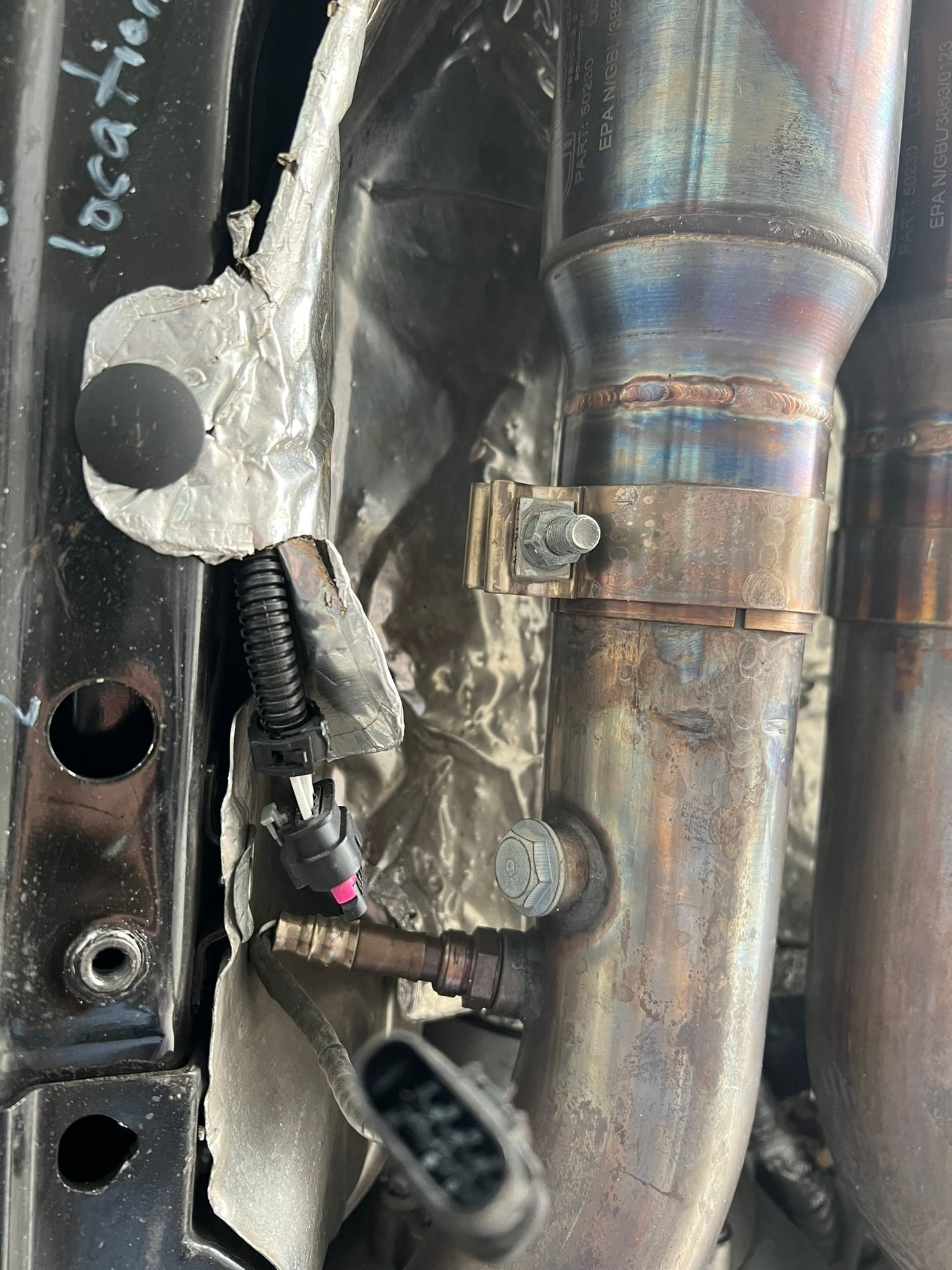

Here is the issue with LGs.....the bungs are located in the wrong place so the O2 sensors get jammed into the heat shield in the tunnel. This is all part of my long and sordid tale of ****-poor workmanship. I'm spending a bunch of money to have the headers reworked to move the bungs before I have them coated. If I didn't already have them, I'd be buying Kooks or ARH.
