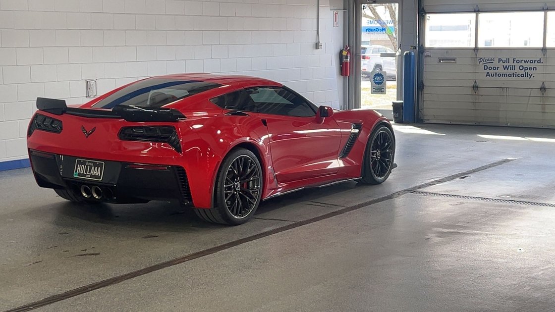

PFA. 2015 Z with Haltech Cold air intake, Haltech Ram air mod, Corsa Double X pipe, Flex fuel sensor, 5% over Lower Pully. Tuned and running on E35(stock fuel system).
Car went into limp mode during some spirited driving and check engine light went on. Dealer said the fuel pump is failing and didn't recommend replacing with OEM unless I'm going to stop running E. Also stated the transmission fluid temp is erratic and recommended replacing the temp sensor.
Looking for recommendations for a new fuel pump and any other thoughts before I take it to the local speed shop.
