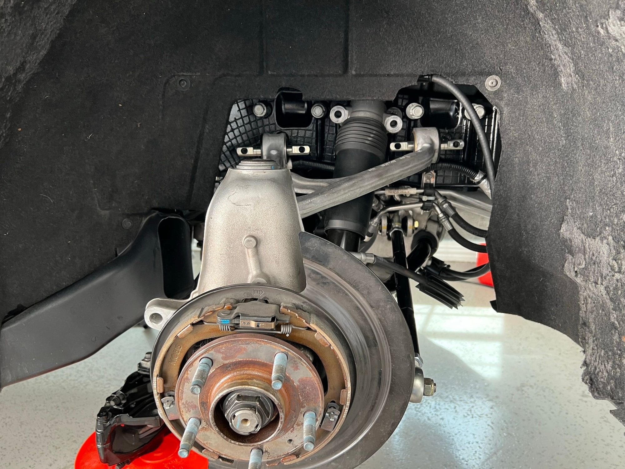

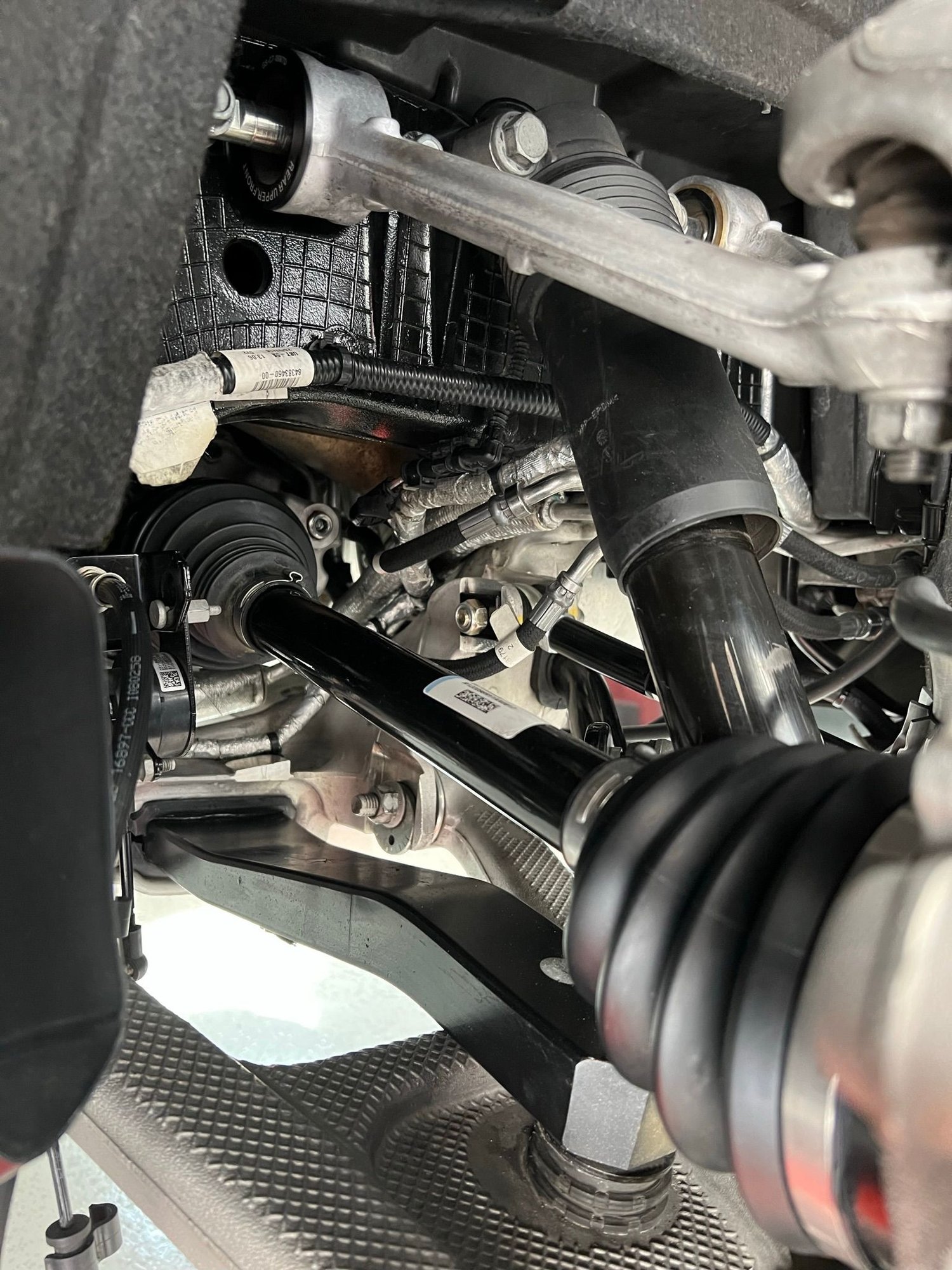

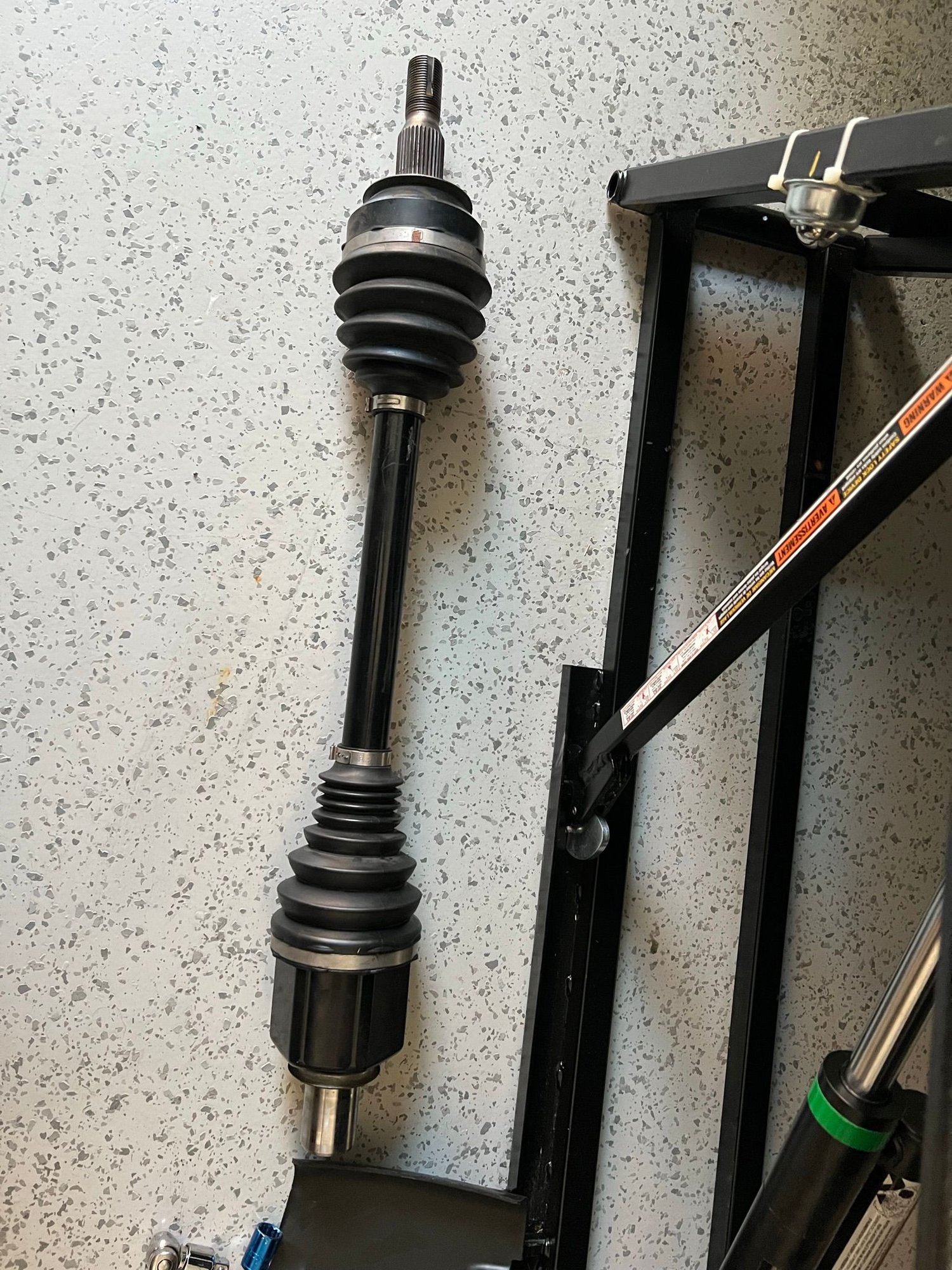

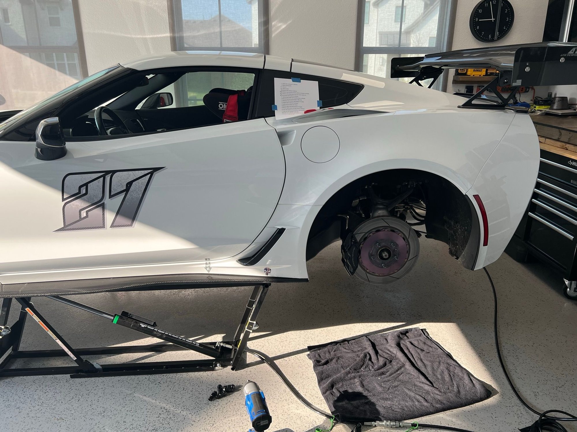

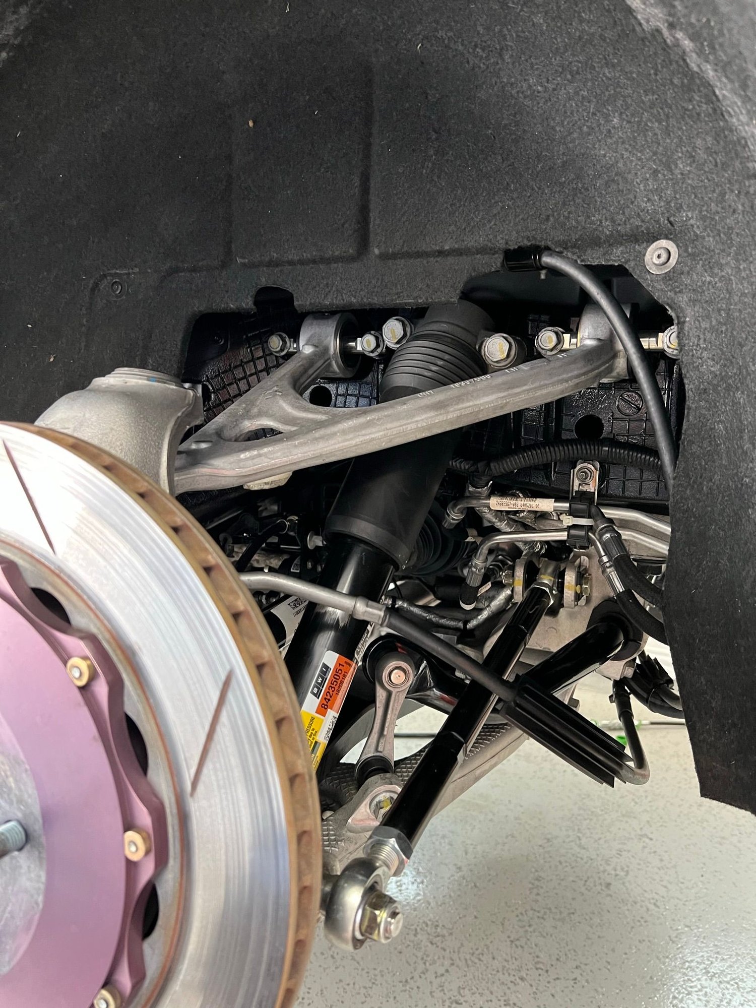

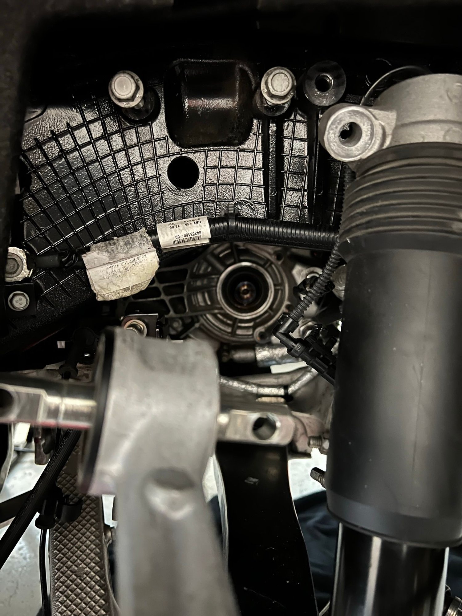

You have to pull the axle shafts. Then you remove the old seal and install the new one. A shop is probably going to tell you around 2-3 hours per side.
Pretty rare for these seals to leak. Usually the rubber boots on the axles tear. Even though they're packed with grease, they will spray some liquid out of them.
"DIY" depends on your skill level. I needed to change an axle. The below gives you an idea of what to expect.

Thank you for your responses and sharing the photos. I checked the fluid and it's definitely gear oil.
It looks like axle removal is pretty straight forward. On some of the previous cars I have had, the axles were locked inside by a circlip, necessitating removal of the entire differential assembly, so it's good to know the C7 axle removal is somewhat drama-free.
I will definitely check the breather. Is this accessible if the rear is raised 10" on ramps? Or does breather access and removal require a bit of disassembly ? What's the best way to remove it (on ramps)?
