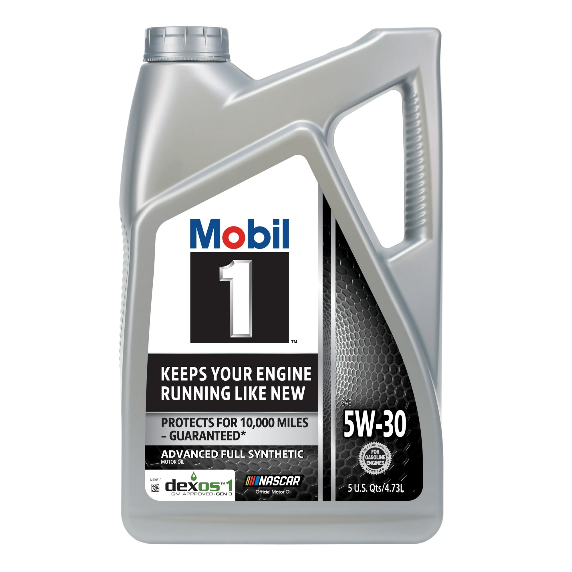

So much confusion in that post. I thought Mobil 1 was full synthetic. The stuff I've been buying says full synthetic on the bottle. Is that not true?
https://i5.walmartimages.com/seo/Mob...0&odnBg=FFFFFF

There are many types of Mobile 1 oil. The change is from 5W-30 to Mobile 1 0W-40 "Supercar" oil. Did you read the, Corvette-web-central, article? Every thing GM said about the correct oil, changed in 2019. "ESP" was the original name of the oil, it is now called "Supercar" oil.
When they say, "the switch back to Mobil 1" they are talking about the 0W-40 oil.
The page I sent you was updated in 2025, so it is the latest change to oil recommendations.
