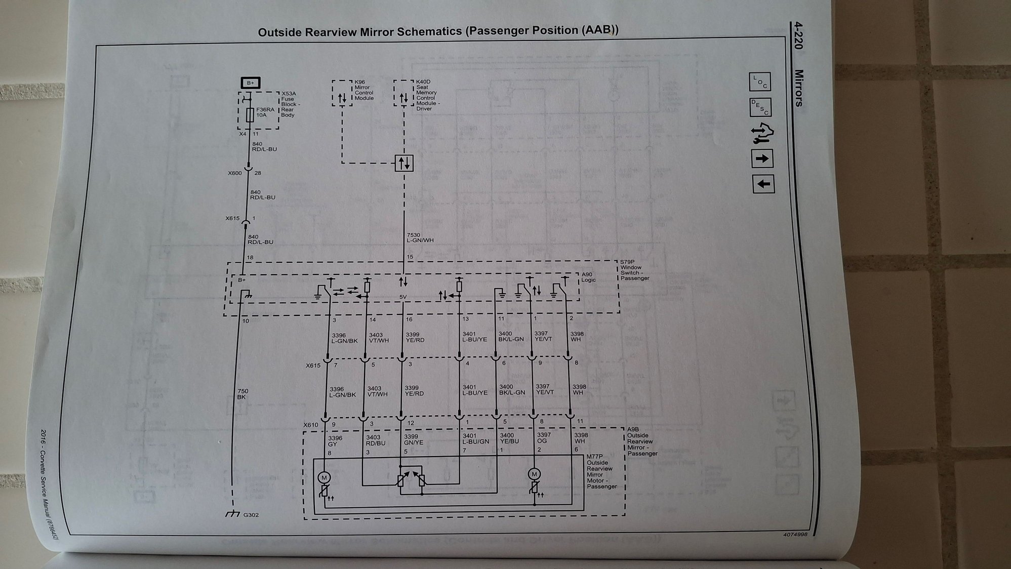

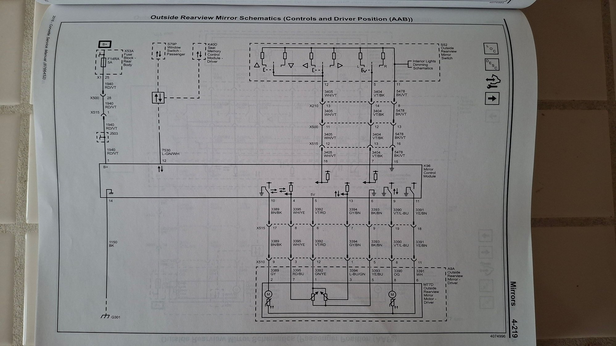

Hi, i am Sjaak and new on the forum.
I have a pair c7 mirrors that i put on my c6 but the mirrors have different wire colors.
I thake the small part off the c6 mirror and put that on the c7 mirror .
But now i am looking everyware for a wiring diagram for the c7 mirrors so that i can rewire them.
Now i am hope that here is sombody with a wiring diagram, and wil share that with me
regards, Sjaak Verlaan (netherlands)

With memory or without memory?

Thanks for replay, i have the mirrors with memory.

Laserdude2215 and Stevettec7 phanks to both of you.
thuis wiring diagram are very helpful for me.
Thuis weekend i go to rewire the mirrors and i let you know the resultaten.
Both thanks for your time and help.
