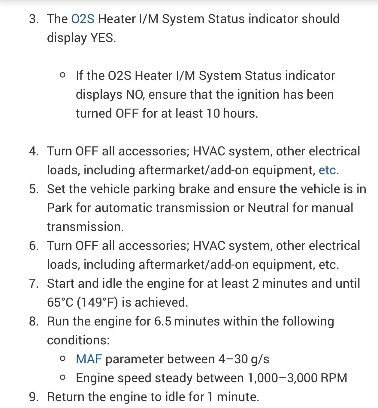

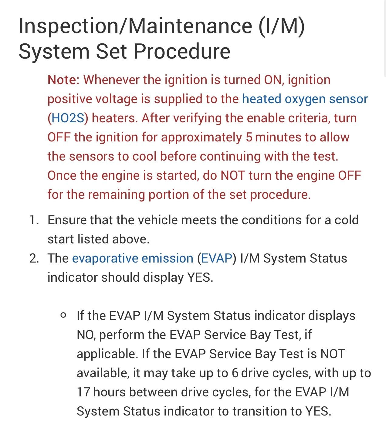

You can’t just “drive around” to have the monitors set…a very specific “drive cycle” has to be completed which is pictured below taken directly from factory service info…do you have a “pending” O2 trouble code present ??

C5 Diag while I can see this procedure would work well on a dyno where you can control everything but not as much on the street with varying traffic conditions.
I have found just driving the car each day from a cold start within the designated parameters with a half full tank of gas usually works well.
It does take a little longer.

Just one of the main issues is holding the cars speed at a certain level for 'x' amount of miles without moving the gas pedal or touching the brake is almost impossible in traffic.
Also after idling the engine for 'x' amount of time and then immediately accelerate to a higher speed, highway, for 'x' amount of time and holding this set speed all the while without moving the gas pedal or touching the brake. This is almost impossible on the street with traffic and especially when there no highway close to your location.
There are other issues as well.
Now if you have a dyno no problem but on city streets all you can really do is just drive it.
