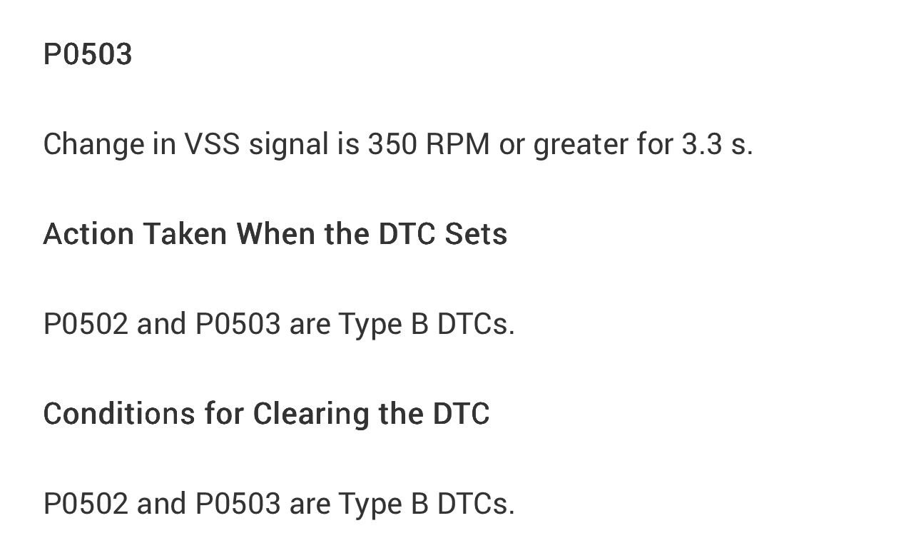

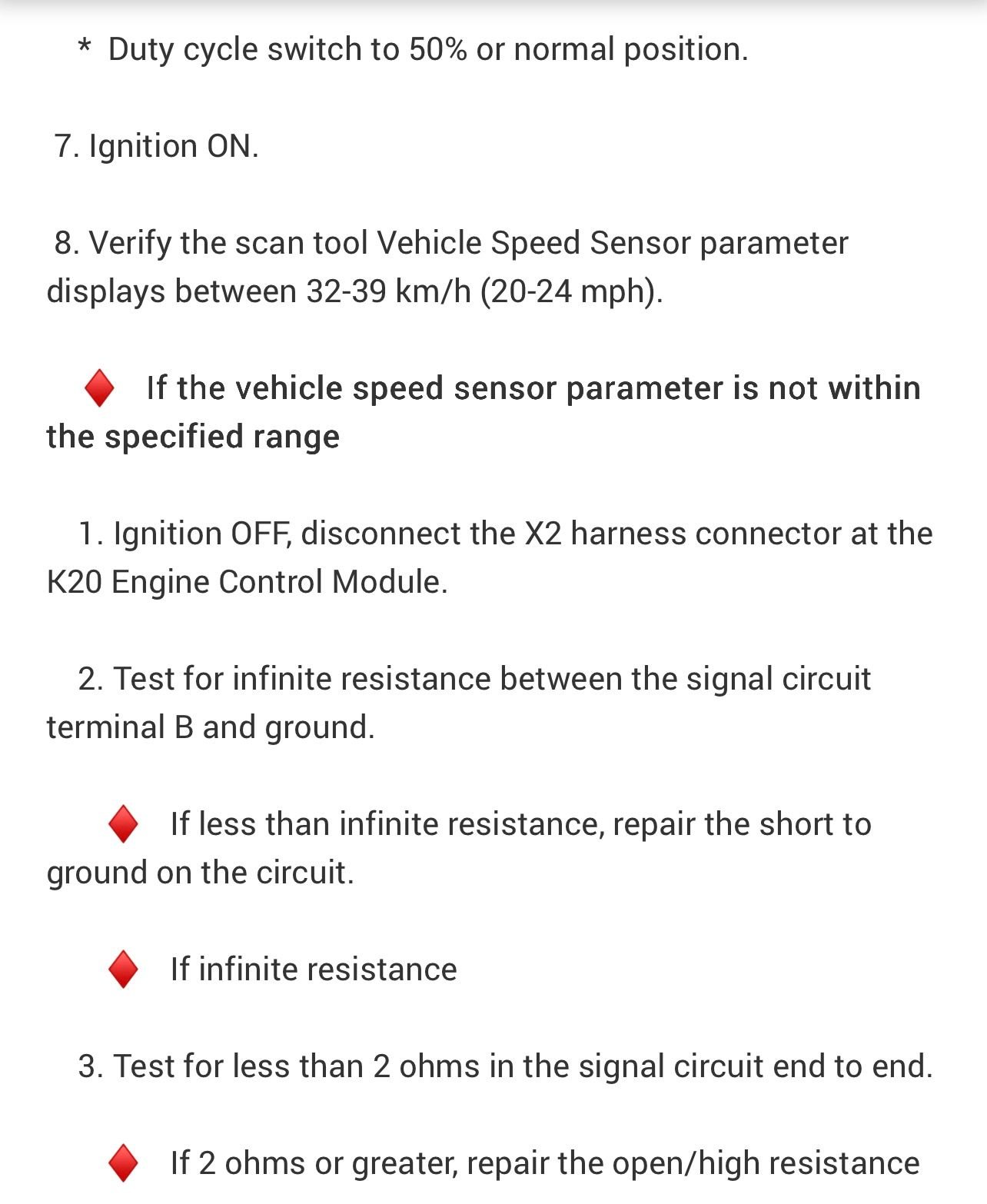

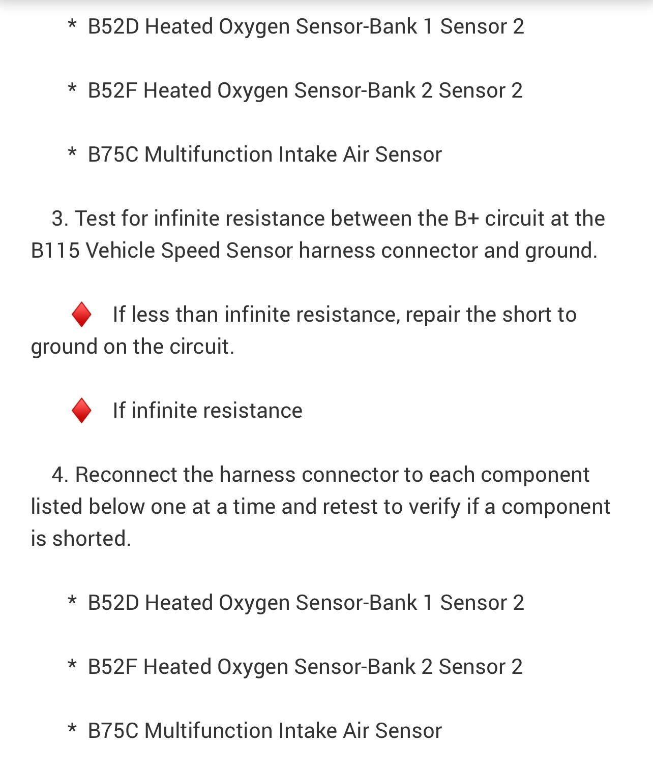

Below is the circuit description as well as the troubleshooting flow chart…did not see any TSB’s related to this…being an intermittent issue using a lab scope would be the best way to diagnose this…may be the sensor, wiring issue or even a bad ECM…best bet is to seek out an auto electric shop in your area that uses a lab scope if you are not knowledgeable in electrical troubleshooting.
