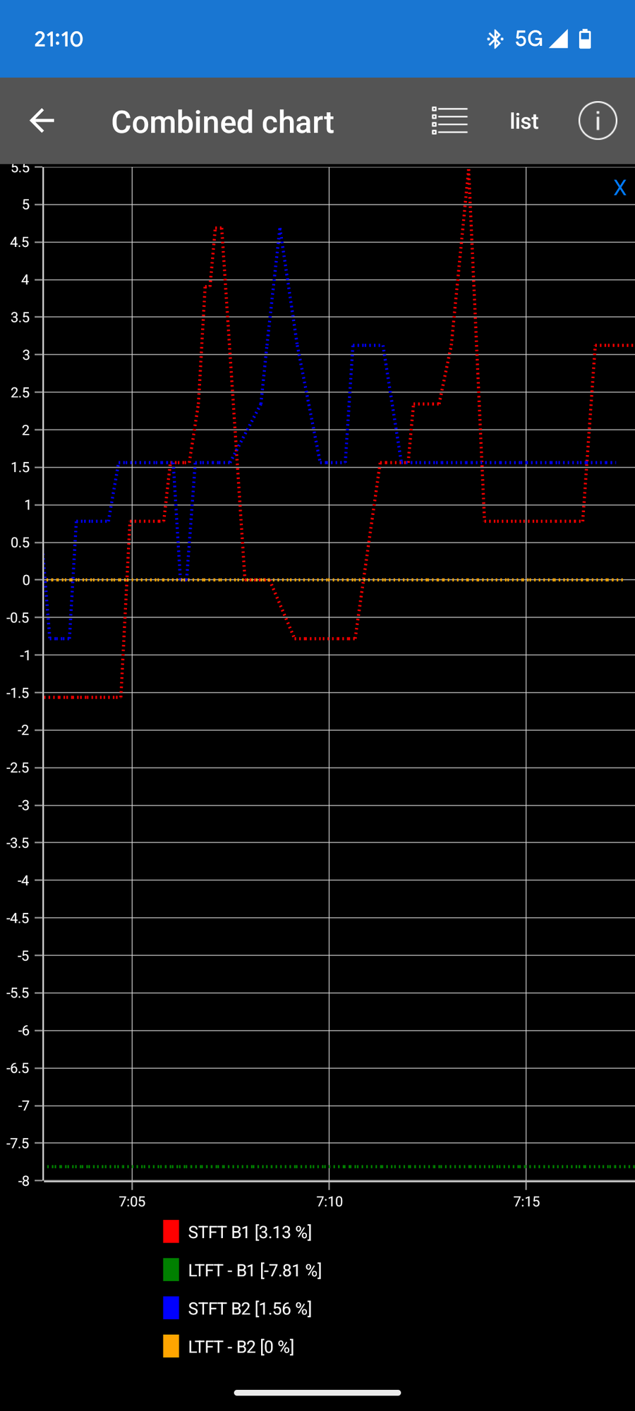

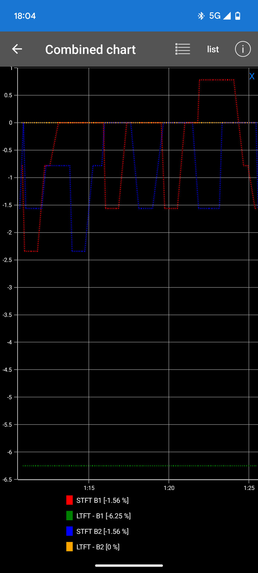

Anyone have fuel trim data they can post from their car? STFT and LTFT for both banks.
My 2015 C7 Z51, shows the left bank operating at -5% to -8% after a long drive.
Where as the right bank is usually at 0%, sometimes +/- 2%.
Note: i recently replaced 4 injectors on the left bank, right bank is original to the car. I dont have data before i did the work.
Car runs fine with above specs. Moreso wondering if this is a common thing, or my new injectors are simply adding 5-8% more vs stock. Or a sensor is slightly out, etc.
