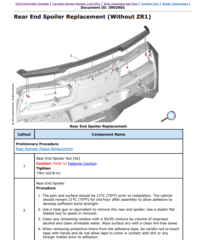

I found a spec for 62 foot pounds - that maybe high, I will check my torque hopefully in a day or two and see if I can get a good result.
Good grief. Any torque specs on those bolts are going to be in INCH pounds.
If you're talking about the actual spoiler to the rear bumper cover, it's 62 in/lbs

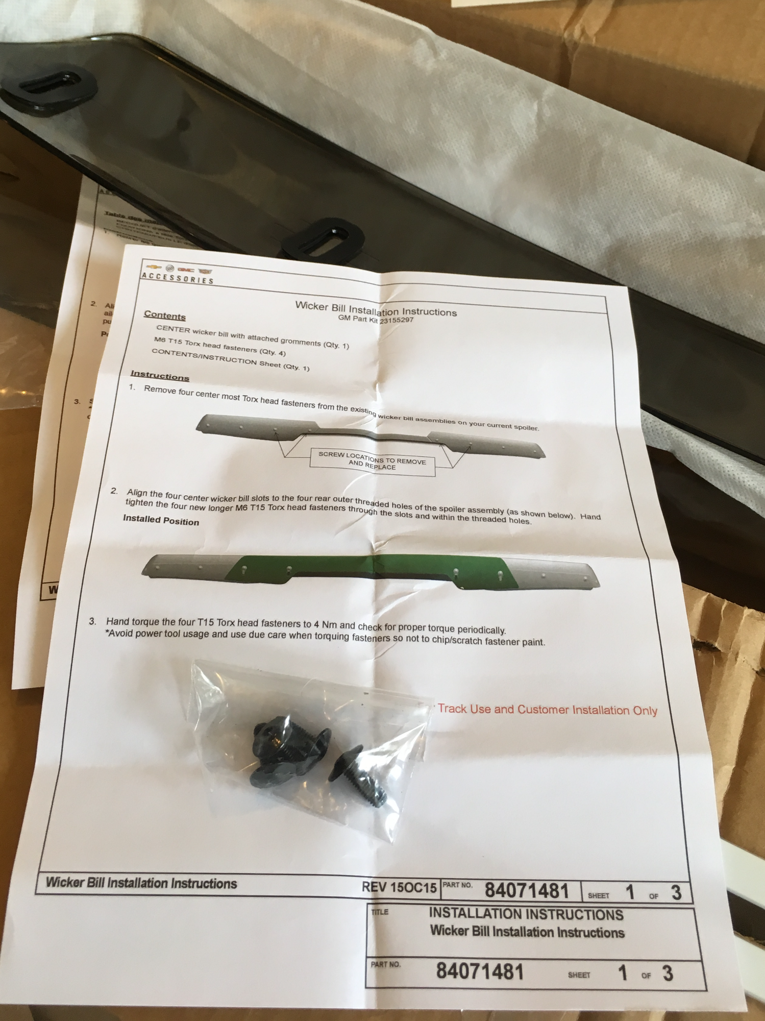

If you're talking about the wickers that bolt to the spoiler and/or the center wicker-bill....4 Nm
