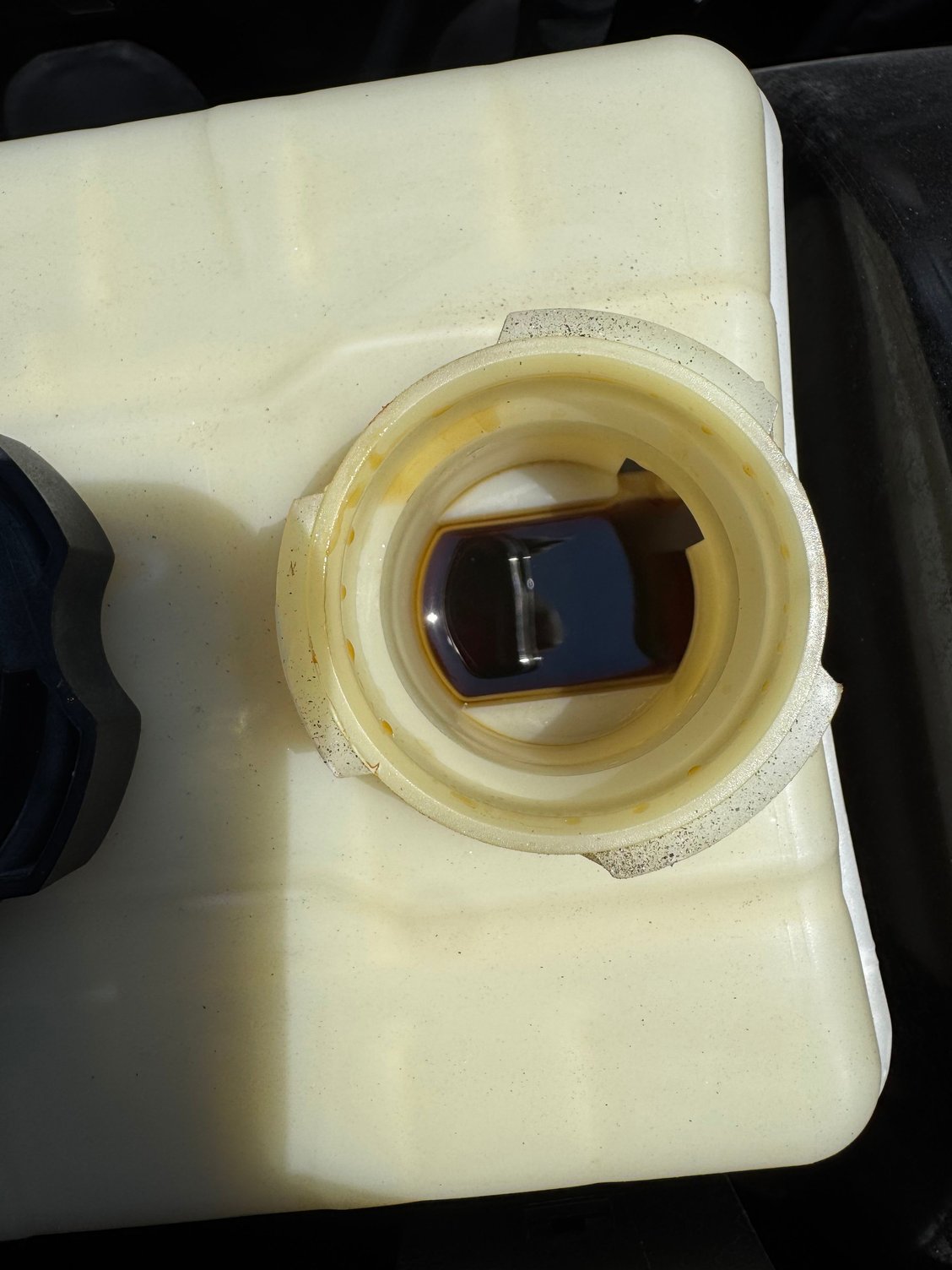

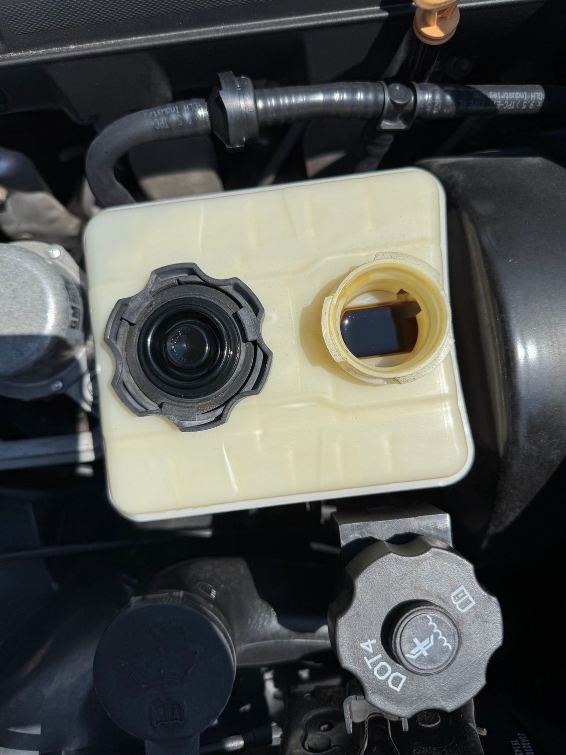

So, the Hunt continues
Son recommended that I consider a Convertible
found one two owners, reasonable miles for each owner (50k) 2016 M7 1LT
out of town, so asked for photo of Brake Reservoir

just needs to be changed out. will look like that a week after you bleed the old oil out

Yeah it's old, but I wouldn't base my purchase on the condition of the brake fluid.

Not a deal breaker. I would look for a 2LT though.

I see brake fluid as an indicator of preventative maintenance and care the car's received. I shudder to think of what's in the clutch reservoir.
Assuming you have other options, including patience, I'd look for another. If other options or patience are in short supply, I'd dig deep into the cars maintenance records and look closely at its mechanical and cosmetic conditions. Good luck!

Personally, that would not bother me at all. The clutch fluid will likely look the same - it happens quickly especially when you drive them. Since we don't know a lot about the car (price, visual condition - under hood condition, cleanliness of door jambs, wheel wells, calipers, wheel drums - built up brake dust, seats/bolsters/console cover/HDMI screen, maintenance records, carfax, etc.). Do you have a link to the pics in the sale ad? Might give us a little more insight than one thing.

IDK about you two, assuming @Flattman is talking about the brake fluid, but I have NEVER had that happen to me. My cars all had fluid changed last year on the same day in spring and I have NEVER experienced that. While the fluids are darker than new and there is some additional water content (as verified by my tester) vs fresh from the bottle with the seal just cracked open, I have NEVER had it turn that dark after a week of driving in ANY car I have ever owned.
When I flush, I use a vacuum thing that they use to suck out old oil from an inboard boat motor to suck out all the old fluid, dump fresh in and suck it out again. After which, I flush. I use a quart to flush all 4 calipers on any car I own. I did this for all my MBs and the standard was 2 years so I did that for every vehicle I own including the motorcycles.
All said, this dark fluid is what I expect to see on used cars especially domestic ones since people don't seem to grasp the concept that the brake fluid gets old. I am always told "Well, that was how I have done it for 30 years. No problem." but the fluid tester seems to disagree that it is a good idea.

You're correct, I was referring to the clutch fluid if they were to check that in addition to the brake fluid. The brake fluid does change shades at a much slower rate so in the OP's case, it's been awhile.

As expected, brake fluid was a reasonable indicator of the maintenance and care the car's received (or hasn't). What are the odds the oil change included the right oil and a quality filter...?
You made the right decision - take your time and get one that's been properly cared for. I don't think you'll regret doing so. Good luck in the continued search!
