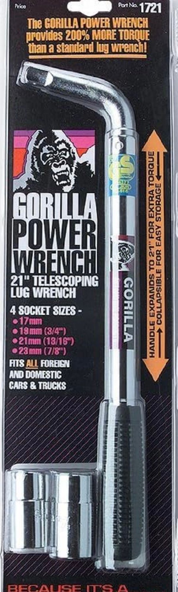

Gorilla wrench - check Amazon
I just ordered a similar one to this, Thanks
