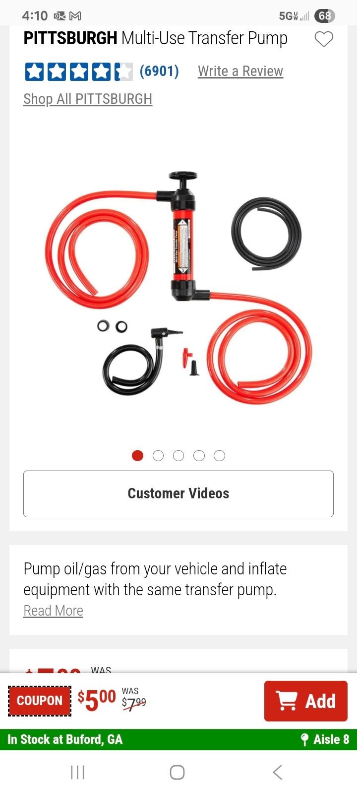

I use this to fill ..... works well for the rear and for the transmission... plus its cheap
Dave

Exactly Dave. The HFT transfer pump works great for all kinds of fluids.
