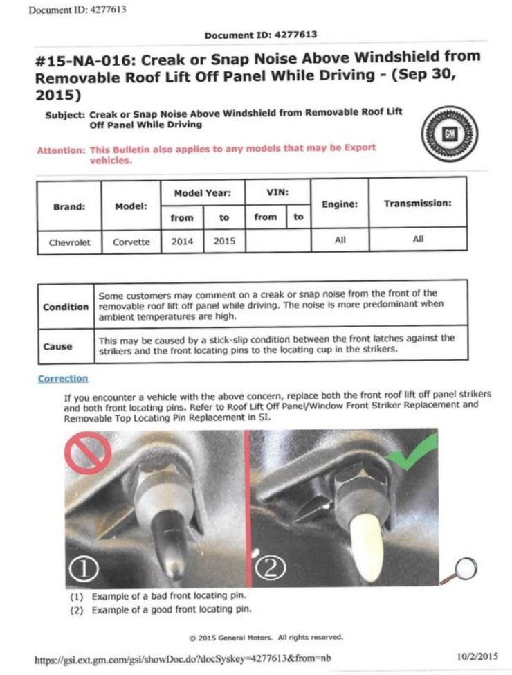

Thanks. Did a little research myself. There was actually a bulletin from Chevy couple of years ago. To fix this issue. Part number 23507291
Per the bulletin you need to replace the strikers and the pins.

Yep,,,, Still didn't fix the clicking.

Dealer Robbed me by changing the two front pins and replaced "rear torn weatherstripping" charging me $1,300.00 and it fixed absolutely nothing. It's definitely some kind of body flex which becomes more apparent in the higher temperature weather. I don't believe that there is a permanent fix for it.
