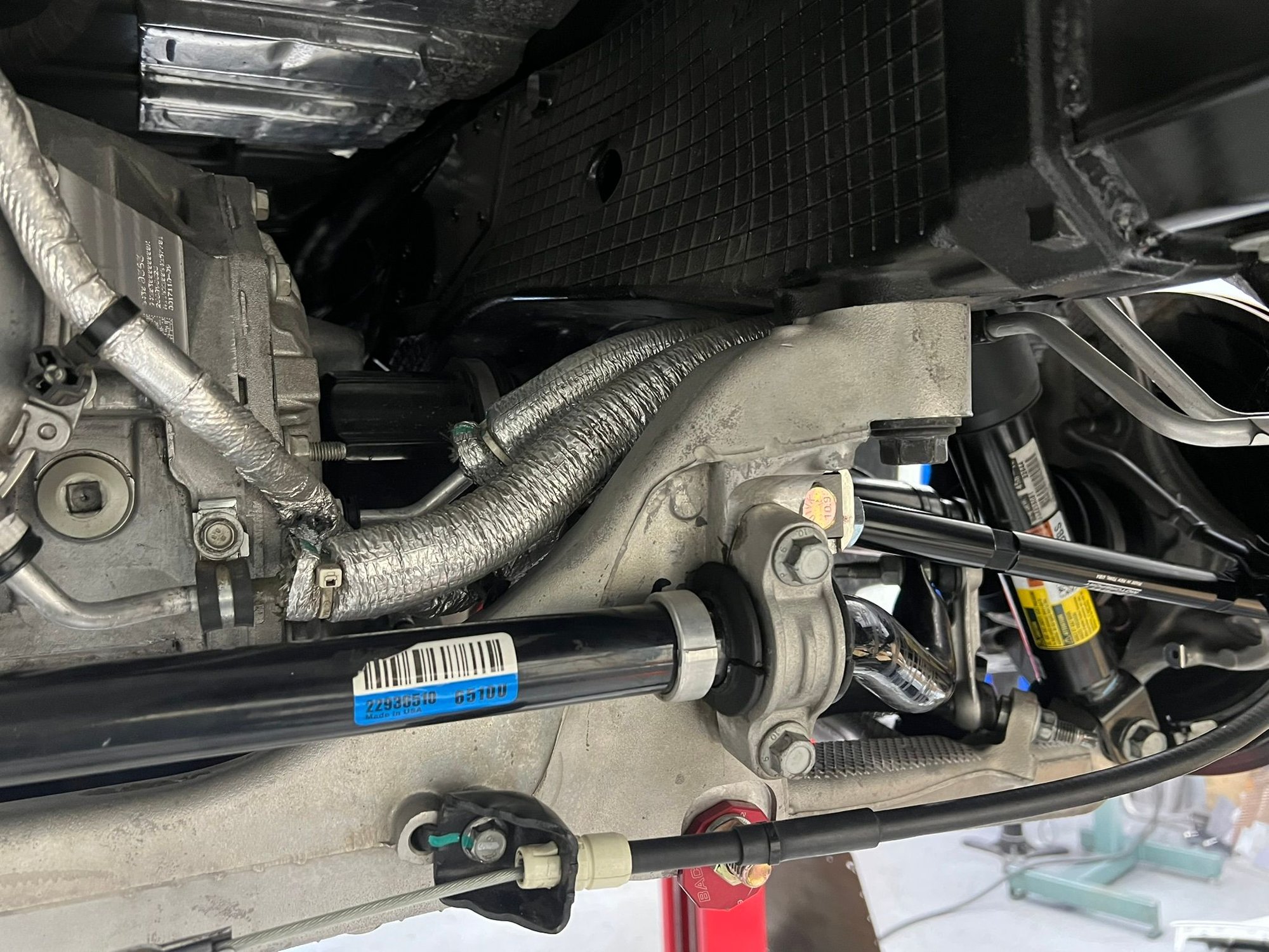

Look at the system operation before jumping to conclusions that the problem is in the brake drums. Observe the bare cable running horizontally across the rear end above the stabilizer bar. It is tightened by the actuator which I remember is in front of the right rear wheel and accessed by removing the fender liner. Obviously the cable should move when the parking brake is set or released. Trace the cable and see it there is any obvious place where it has slipped out of a cable guide, pulley etc. or is obviously binding or sticking.
BLOCK the wheels before going under the car or use a mirror! Have someone actuate the parking brake while you observe the cable. You may just need a spot of lithium grease on any pivot points or guides.
If you see slack develop in the cable it may indicate a sticking brake shoe. If the springs in the parking brake assembly are working, there should never be obvious slack in the cable.

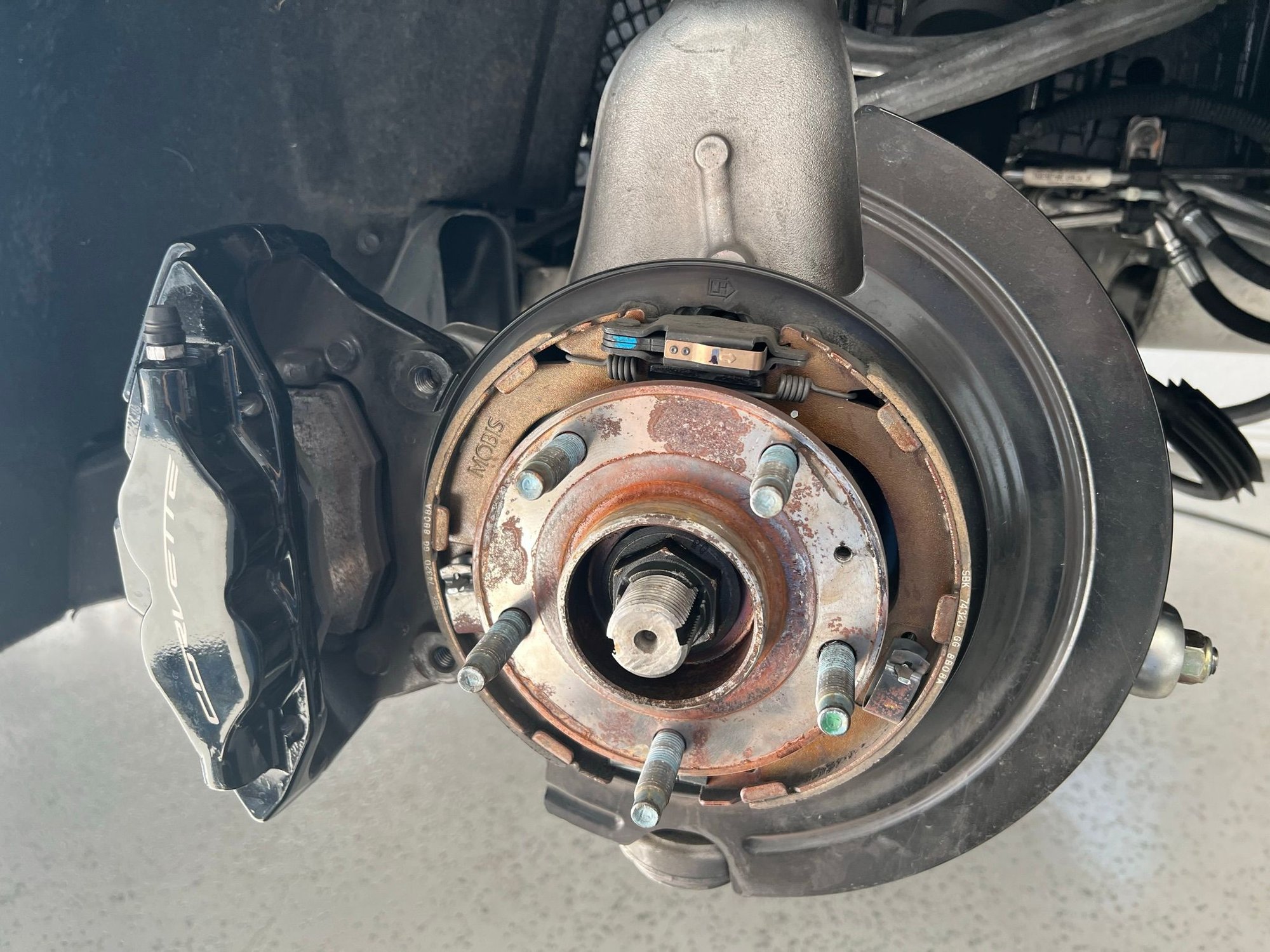

e-brake shoes (driver's side), just like old style drum brakes.
In the pic below, you can see a bracket at the bottom with the parking brake cable. There are two....one per side. They've been known to come loose and rather than releasing the parking brake, the cable just sort of rotates around with the loose bracket.
If the shoes are adjusted correctly...and with near certainty they are....and the brackets are tight, then that leaves the electric motor that pulls on the cable.
Thanks for the photos and description.

Did they replace the module or only clear the codes? Could have been a sporadic issue, check the cables. It's a rather simple system, switch tells module to engage or disengage. Module has a motor which pull or releases the cable. That's it. The single cable goes into a bracket on the rear sub frame that splits it in two and those go to each wheel which pull the "drum hat" parking brake (or release it).
