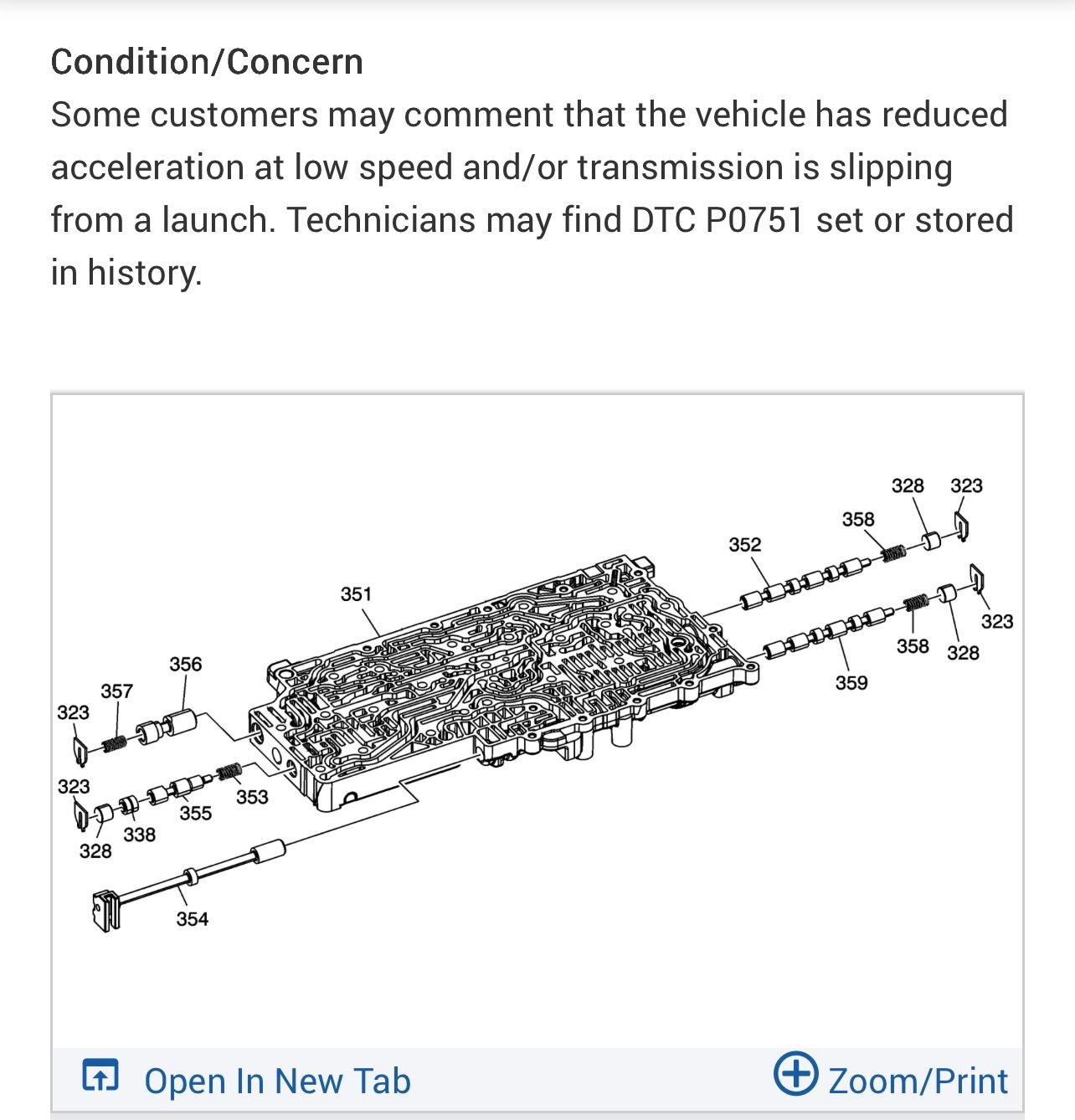

It is also a good idea to look at TSB to see if anything related to your concern…so the RPM’s suddenly increase during this flair ??…unfortunately not a blown fuse so you may need to seek out a transmission shop.

Thanks for the reply. I'm quite confident the TSB is not my answer. As originally stated, the problem occurs once or twice ONLY after I manually downshift while in Drive Mode during a downhill run, followed by a stop sign and then a start going forward. I have NEVER experienced this issue under any other circumstances. I have never had this issue when coasting downhill in Drive Mode without first manually changing to a lower gear. The shifting is flawless in all other circumstances of normal driving, even following some occasional spirited canyon driving.
