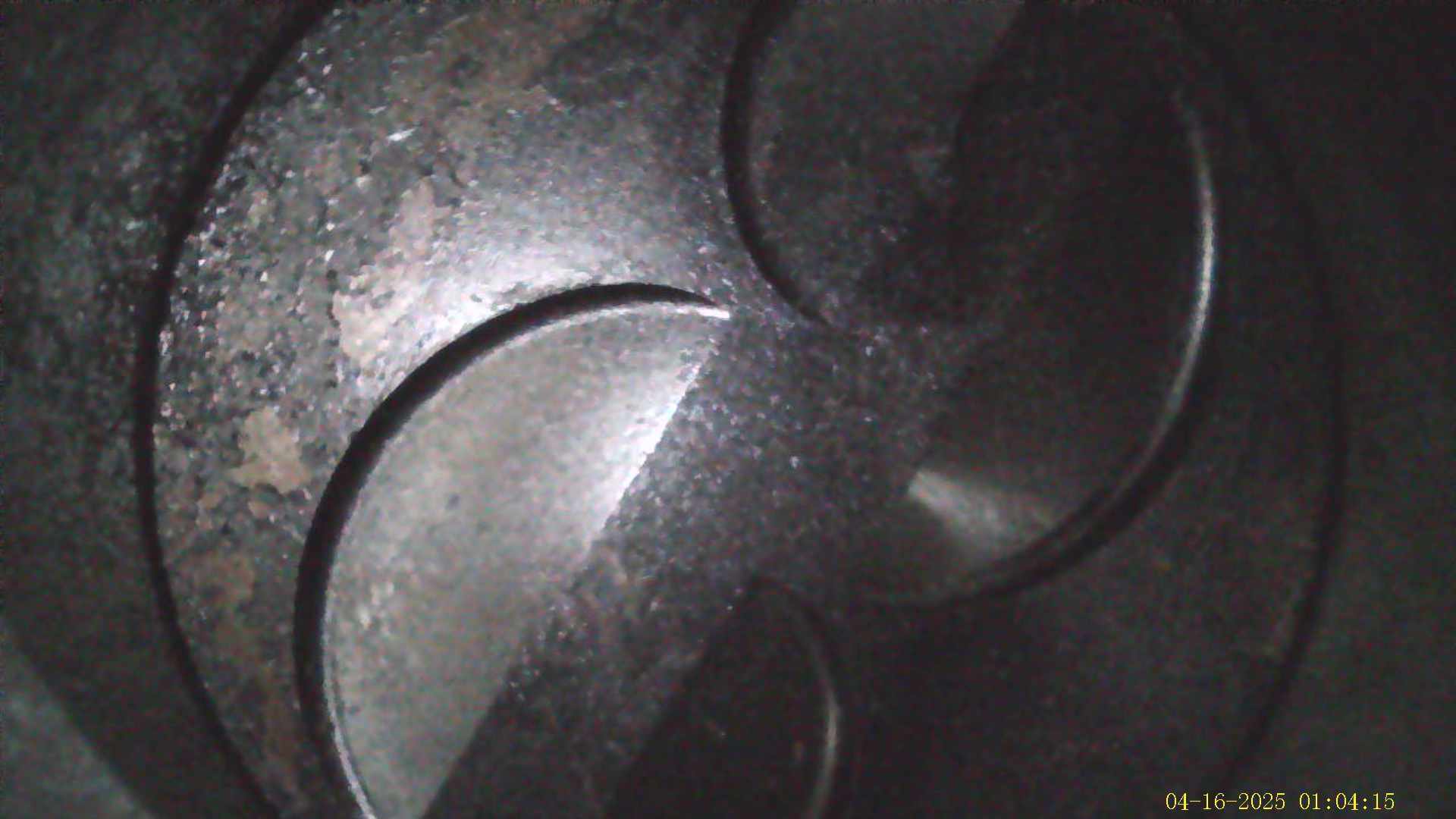

Bad day today, was cruising to a stop light and all the sudden the car just started studdering and shaking, lost all power and died, started it back up and limped it into a parking lot, towed it home found a broken valve spring, what would be the smart way to go about this, what are the chances the valve is bent, I can still move it up and down and appears fine, but want to borescope it. Would it be smart to replace all the valve springs and run it? Thank you

First thing I would do is to put a borescope to see the condition of the piston and valve that is affected. If those are bad, game over. If they are good, depending on how good you feel, I would pull another spring and see if they all have the same range of motion. Can it spin freely?
If I escaped unscathed. I would buy a set of springs and replace that one and run the car for a bit. If all seems well, change all the springs.
thank you for the quick reply, as soon as I can I will borescope it and see what I can see and go from there, hoping atleast the piston is in good shape
I would think both are or none are.

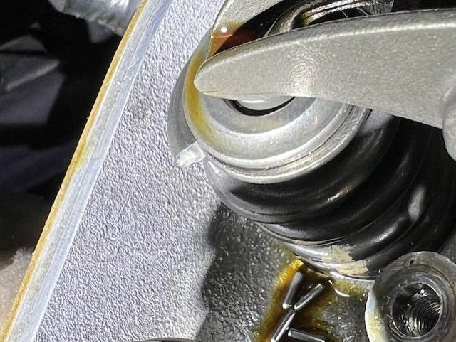

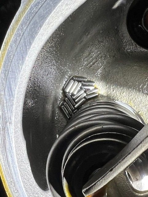

A few pictures of a 2013 with the big LS7 that I had diagnosed a few weeks ago...no damage except for the spring and roller rocker...#8 intake valve.
