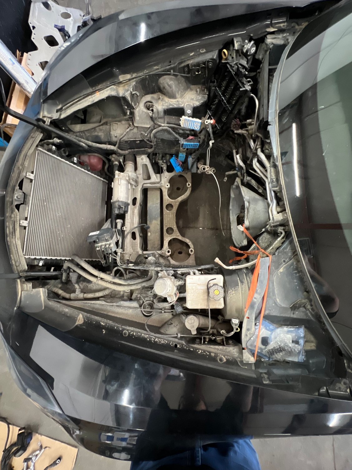

Default Proof in the pics :)
The first photo is right after I got it. You can see how they basically used a sawall to cut back the firewall. This was very tricky to repair, I had to have a Corvette salvage yard send me a complete upper front firewall/dash to graft it back into the original body. The second is with the new harness installed, currently awaiting the front bumper to be repainted. The windshield and the competition seats are in now, just don't have the current photo. But, another week or two, she should be back on the
street!
