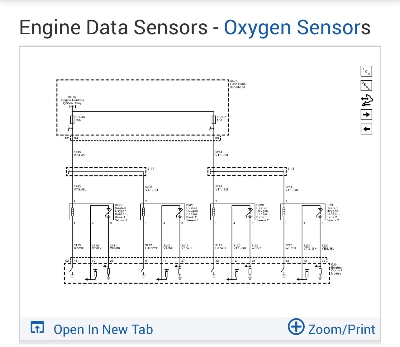

With all 4 at 1.89 volts sounds like all 4 O2 signal wires are shorted to power…never seen that before…with a DMM if you have one see if the violet/gray for bank 1 and violet/white for bank 2 show near 12 volts at the harness connector…you can also remove the 15 amp fuse upper left of the wiring diagram and see if that 1.89 volts disappears on the scan tool…if you have headers check the O2 wiring harnes…a scan tool will only show 1-2 volts and not 12 if shorted to power.

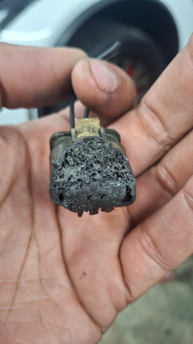

Thank you for all your help, when you said both are shorted to power I figured it out. The shop didn't secure the plugs for rear 02 sensors and one melted. It was bad enough that the wires inside were touching. I cut off the plug and it immediately fixed it and I was able to get my emissions testing done today.

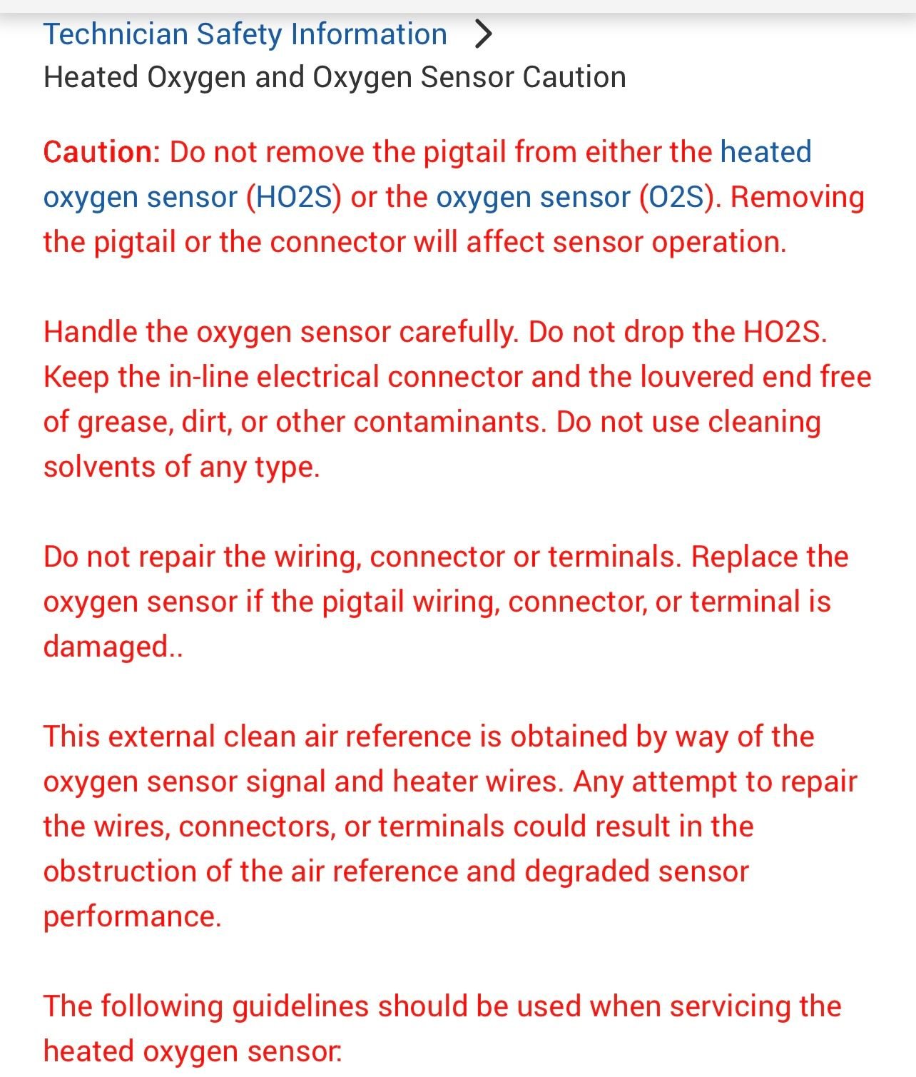

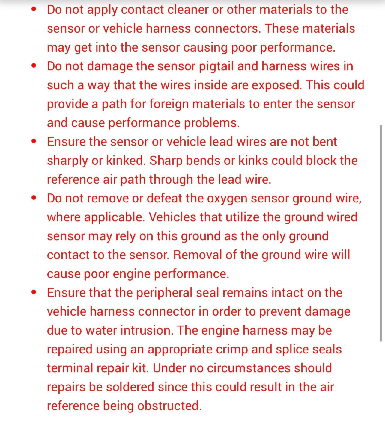

Great !!…just remember the harness side wiring can be repaired but not the sensor harness wiring…below is from Factory Service information.
