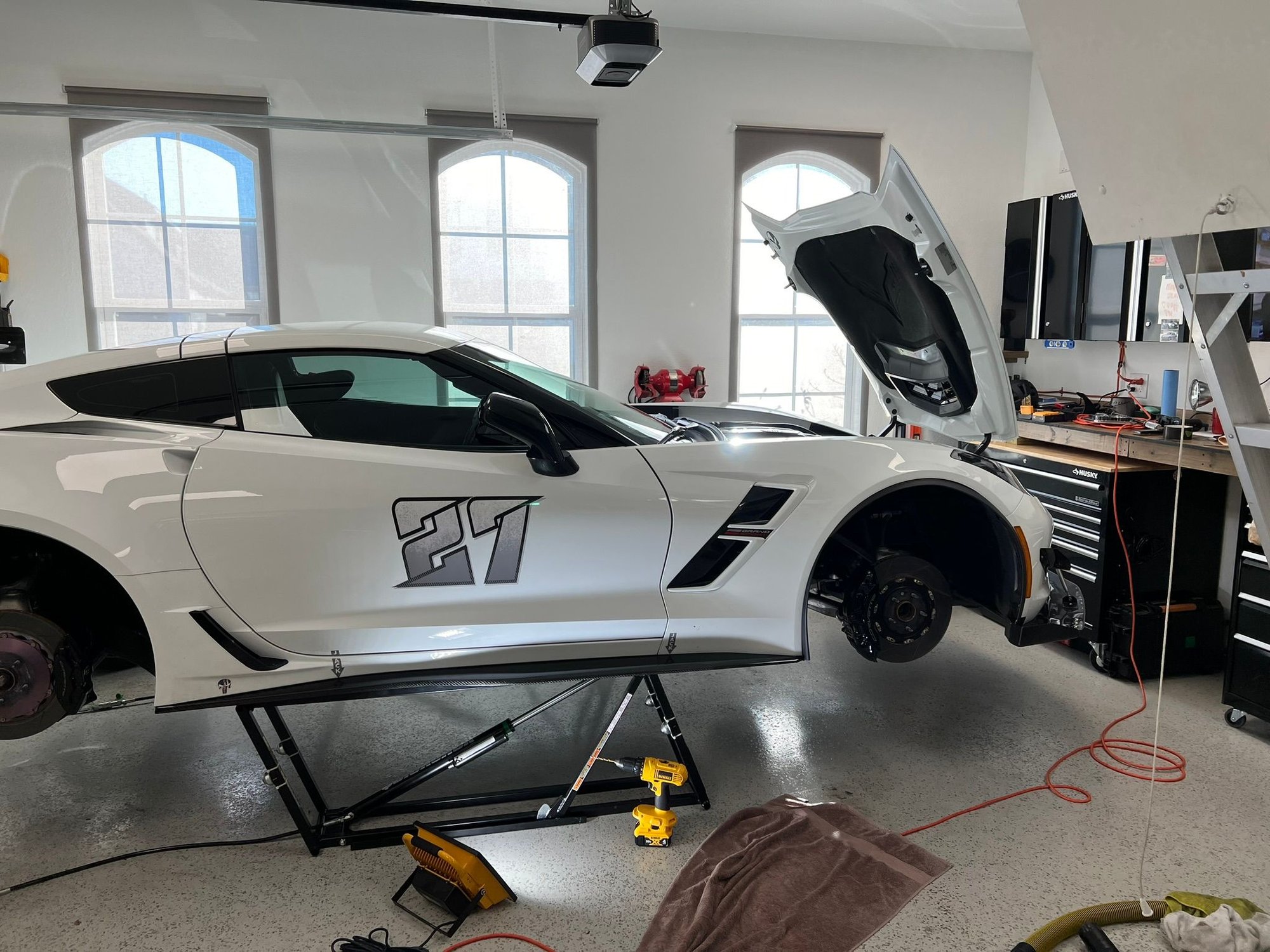

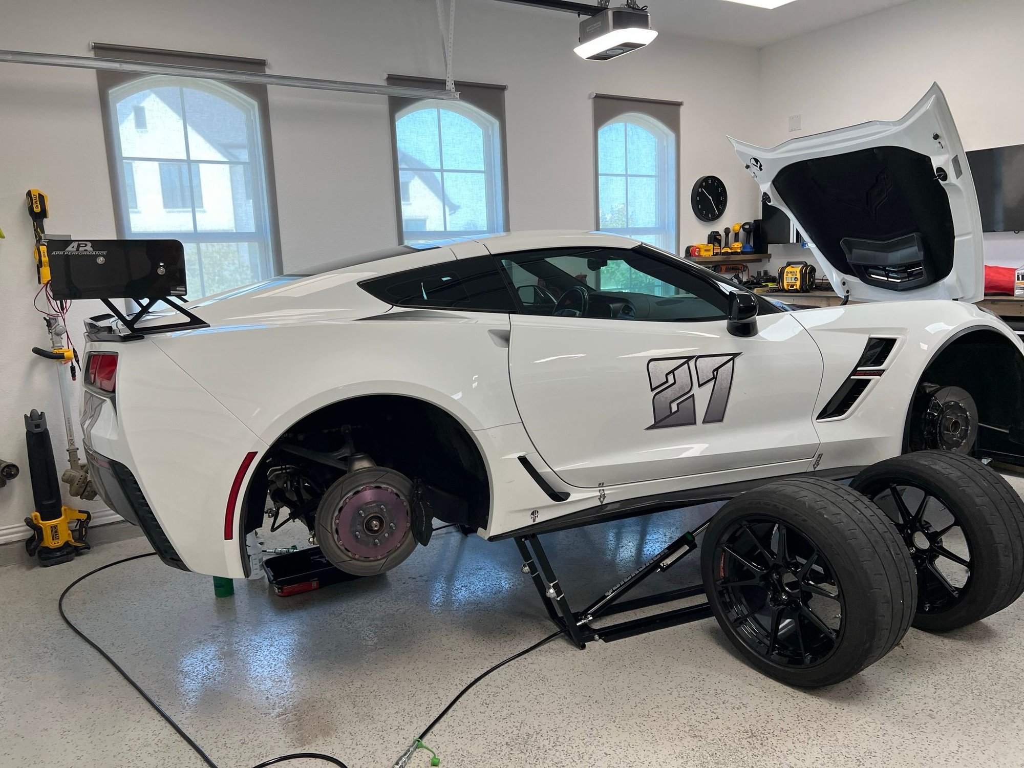

Z06 and Grand Sport have the same brakes, both the standard J56 iron brakes and the optional J57 CCB brakes that are part of the Z07 package. The Stingrays....base and with with RPO Z51....have smaller brakes.
The GS brakes will last a loooooooooooooooong time unless you plan to be a track rat. "huge expense" is a relative term. New front rotors will be in the $700ea range for iron brakes unless you feel compelled to go to a dealer and pay full MSRP of ~$1200ea. CCB front rotors are around $1500ea....or >$2400 at a dealer. Z51 rotors are about $150 each.
Mine on my GS
