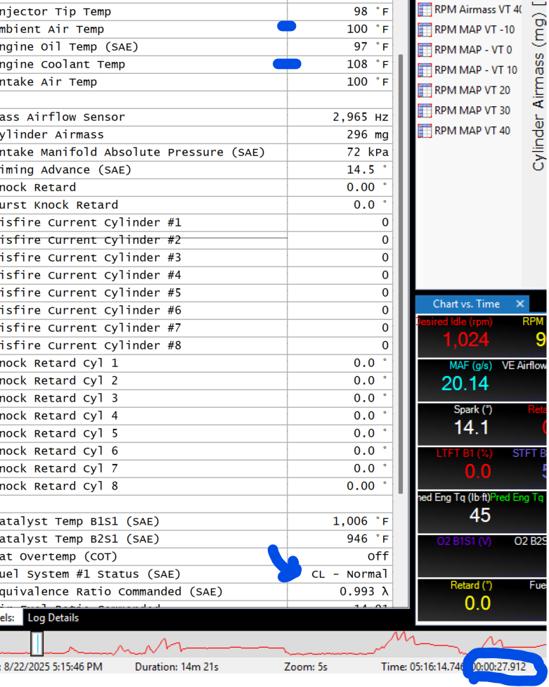

One things that I noticed is that it doesn't happen within the first 10 minutes of car startup.
it goes normally, also at WOT.
after around around 10/15 minutes of usage, it starts to cut at wot.
I'm thinking of some sensors at this point, reading some bad values, and preventing the car to go wot properly, and cutting instead.

All interesting but unless you've checked all the plug wires and logged data, that's all it is....interesting.
Coils sometimes show these symptoms....fine when cold and fail when hot. Ditto injectors.
Well before the 10-15 minute mark, the car is warmed up, it's in Closed Loop for probably 7-8 of those minutes (unless it's 0* outside), it's been using all the sensor inputs. None of that points to a sensor issue.

I was doing some idle testing but this gives you an idea of how quickly it can go into closed loop....not quite 28 seconds after startup. Yes it's hot outside so that matters, but the point is that unless you're in late fall or winter type of weather, the PCM is running closed loop well before you're seeing issues.
Old Aug 24, 2025 | 02:35 PM
Thanks for the info, it's definitely hot in here around 86° Farhenite, so that's definitely the case.
tomorrow will change all the spark plugs and post a LOG.

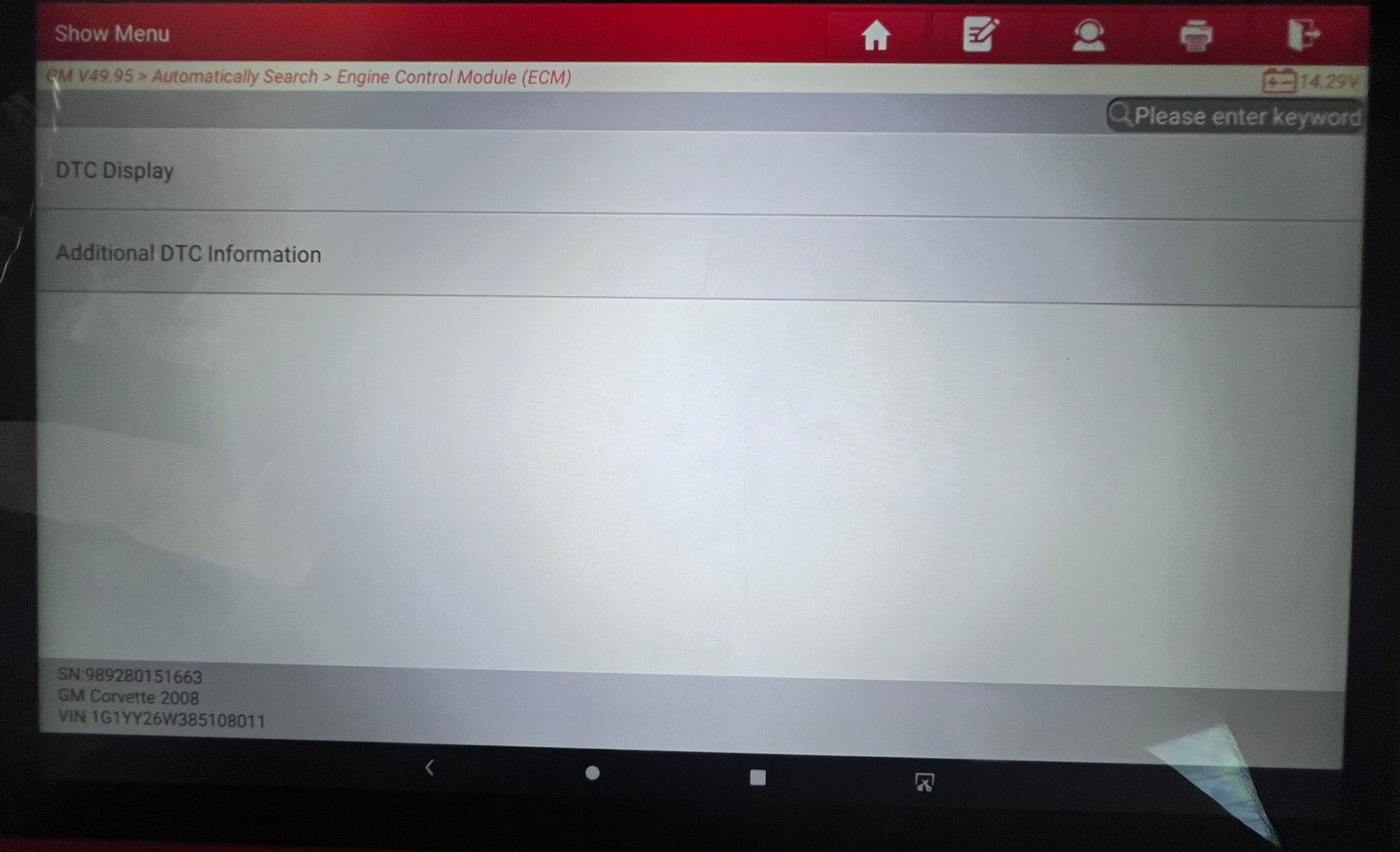

It is impossible to have these many DTC’s stored from the last “start cycle”…are you reading these in “scanner or “editor”…the DTC’s should be read in the scanner…maybe you can post a pic...I don’t use this tool for other than adjusting some parameters like fan settings so I don’t know where you are reading this…if you had these many the car would not run…if you want to diagnose this yourself you need the proper scan tool and HP Tuners is not it.
I have other tools like Launch and GDS2 that both give the exact same errors. Both of them not showing it in any moment in current DTCs, i have no CEL and if I scan the car I have no DTCs.
but if I go on previous cycles or from last DTC erase it has that list that you see.

This is from my Launch…are you looking at “Additional DTC Information” ??…if you are don’t !!…those are not the current or pending DTC’s…under not ran since codes cleared are the tests the ECM has not run…those are not your DTC’s.
Old Aug 25, 2025 | 10:10 AM
Will be sending Launch screen pictures once i get home.

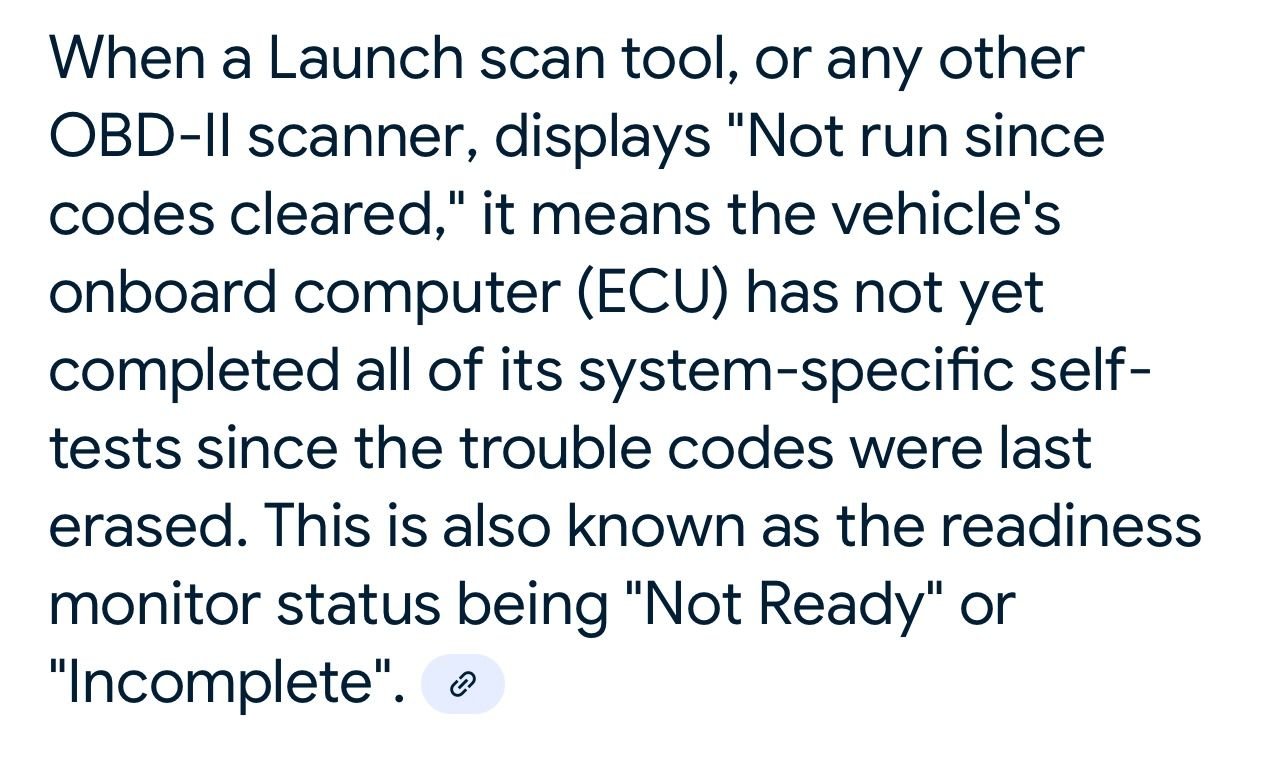

If you are looking at Not Ran Since Codes Cleared…
