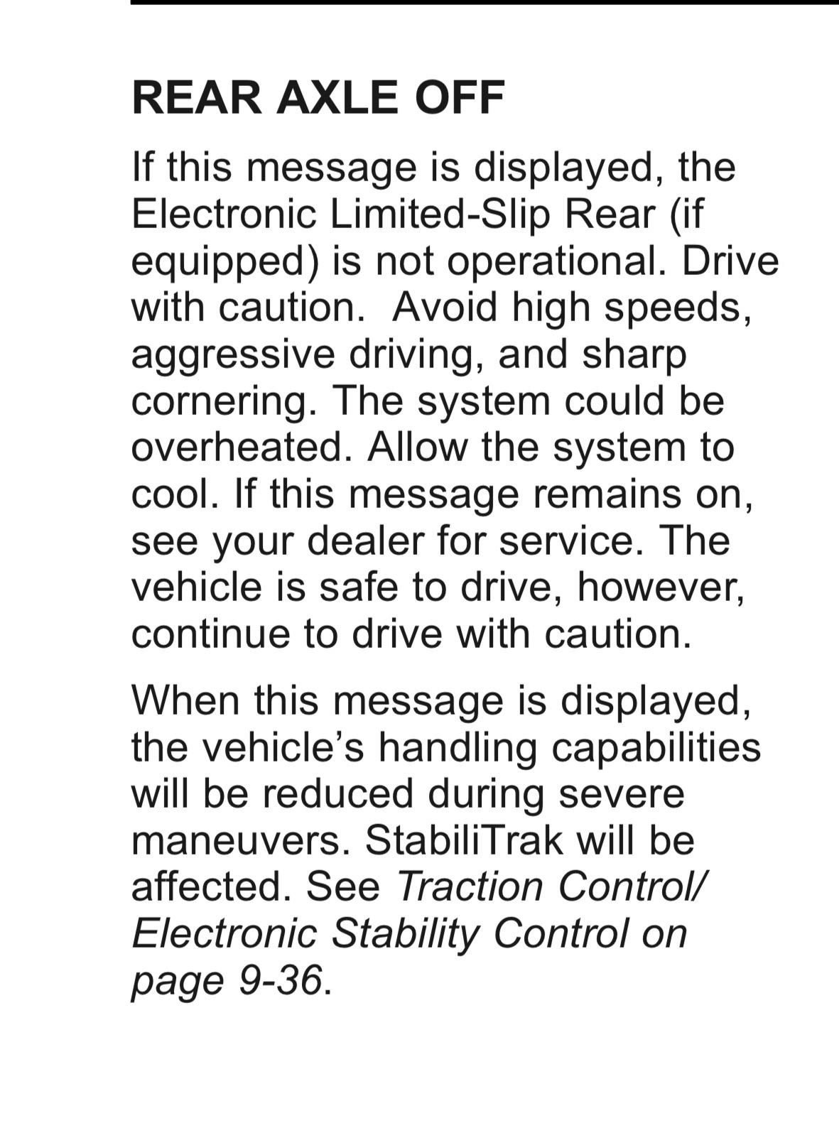

Rear Axle Off refers to the Electronic Limited Slip Differential. This is the system with the electronics and hydraulics that continuously adjust the differential clutch engagement. The hydraulic system is not typically serviced. The gear lube that CAN be replaced has nothing to do with the ELSD function.
So - changing the differential gear lube may be a good idea in general, but is not related to this issue.
