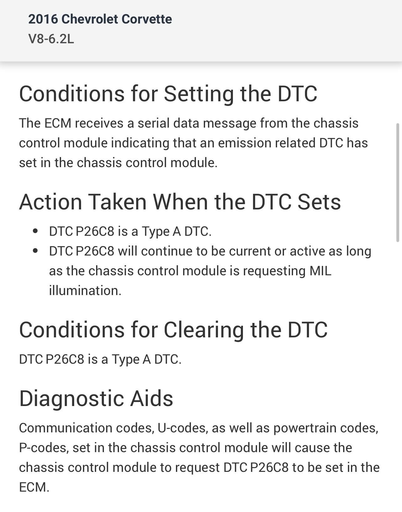

This is what sets the DTC and also diagnostic aids…can be a communication or “U” code or a “P” or Powertrain DTC…dealerships and general repair shops only replace parts…a diagnostic shop is where you should be bringing it…they can diagnose any car…you only bring your car to a dealership for oil and brake changes…that’s it !!…also “Performance” shops are clueless with diagnostics…they just install performance parts.
Hey , so are you saying only certain Scan tools can clear that type of code ? Wouldn’t that be the dealer ?
I’m not sure what you mean by a diagnostic shop ? I’ll do that , that would be great but not sure on my area who that is -
the code is odd , I was wondering do you think it could bring the module itself ? Just need to be replace ? Or could it be spark plugs did it misfires or something just throw a weird code as some cars-
i just feel like the shop didn’t really do a good job checking the valves , my fault for bringing it there but not sure where to bring it next ??
crazy

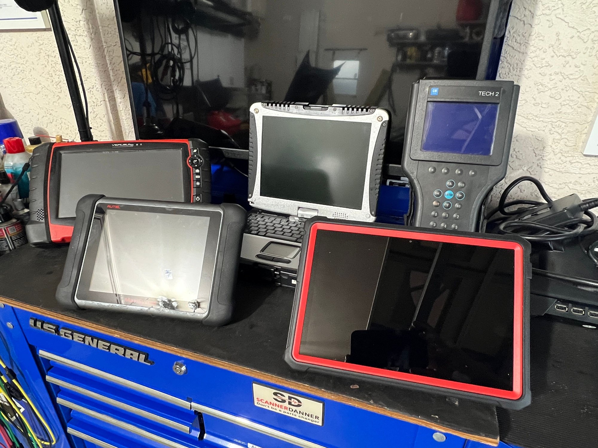

Don’t know what you mean by “manufacturer specific” ??….any factory level aftermarket scan tool will work for any platform not just GM…Autel, Launch, Bosch, Topdon and a few others…the dealer will and should inform you of the DTC before diagnosing the car.
Many 3rd party tools, and some OEM specific tools will not work with other OEMs unless you have them "unlocked".
I know you are thinking of the BOSCH VCI tool which you connect to a laptop, which with any OEM software will work (it's also like $2000). I'm talking about some fully self contained tools which have various OEM Libraries. Foxwell for example requires you to spend $50 to open additional OEMs on their tools (you only get one OEM when you buy the tool which the basic scanner costs only $150).

Stellantis, Nissan, and Mercedes Benz each require a subscription to Auto Auth to bypass these manufacturers “secure gateway modules” to access their data…even your Foxwell will not have most of the special functions and data PIDS as my factory level aftermarket bidirectional scan tools will have and mine by Snap On, Autel and Bosch are well over 2K…I run GDS2 on a separate laptop…basically the more these scan tools cost are the more they can do.
