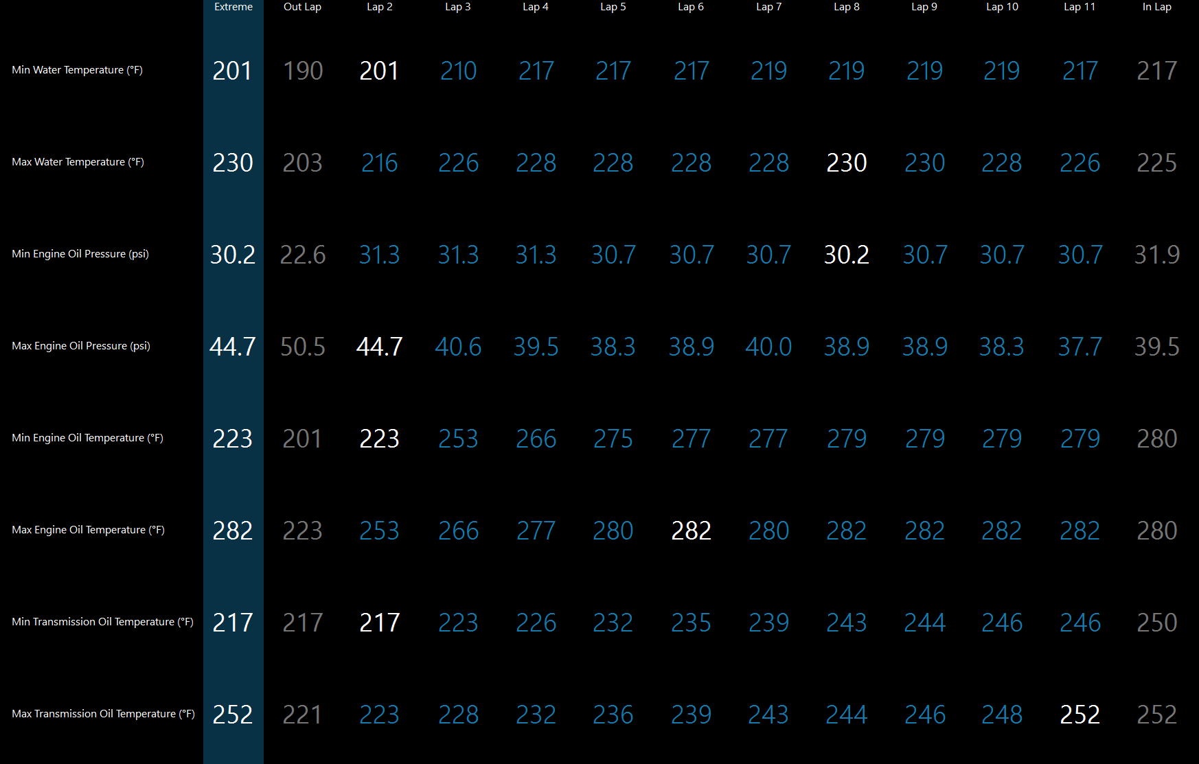

Looking at minimum oil pressure readings from the PDR file. Oil temp 275, minimum oil pressure on
in-lap is 8 to 12 psi. This was running 0-40 Mobile 1 oil. Again this was at VIR air temp in the 90's and oil temp in the pdr data file is 275 for the same lap. Pressure during the first 7 laps was 35 to 42 psi and oil temperatures were as high 283.
This is a 2029 GS, stock LT1. Any one have the PDR data for thier car?
Not getting any low oil pressure lights or codes.

Never saw oil pressure that low. The below is representative from when my car was stock. This was at the now torn-down Auto Club Speedway in CA. 150 top speeds, very fast track overall

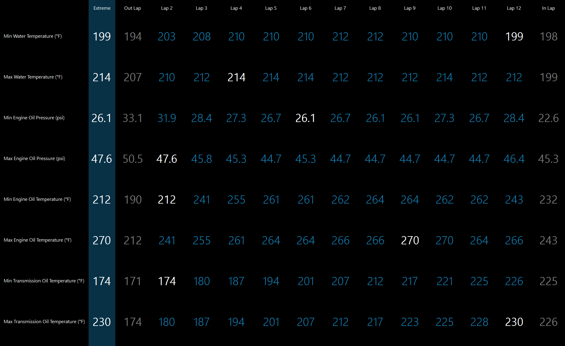

I'd think about a better oil and a larger radiator. Driven or Amsoil. I use Amsoil. The second pic is from this past Wed at MSR-Cresson in TX. 95*+ outside temps. Not as fast but lots of 3rd gear >6000rpm. Fully built 416, larger radiator, 570whp
