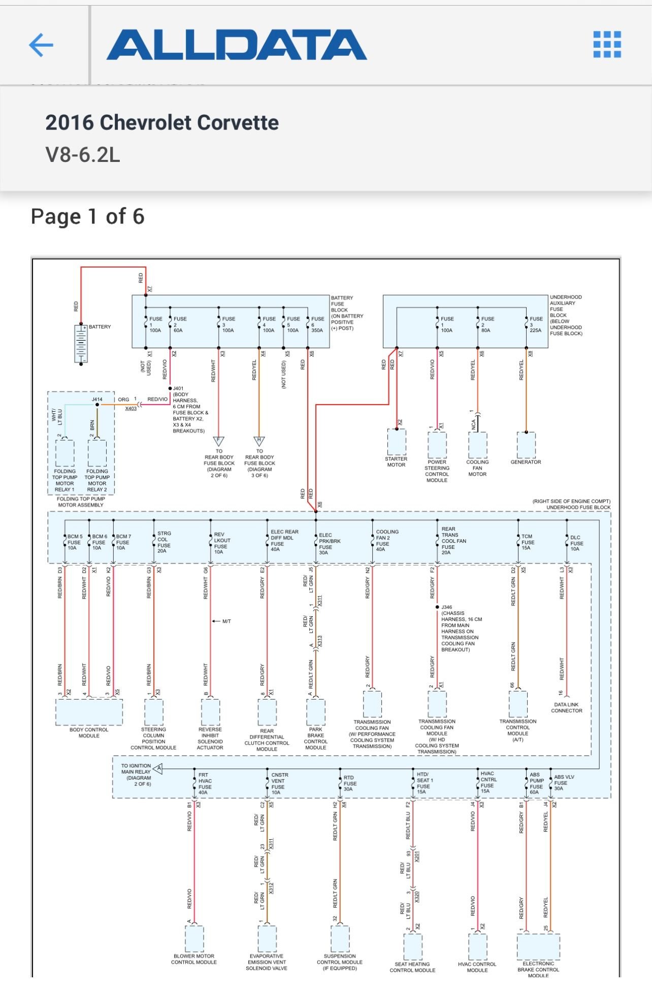

Here are some fuses powered by the battery…if you have a 12 volt test light start checking the fuses…if this checking is over your head seek out an auto electrical shop…unfortunately we can’t diagnose this for you !!

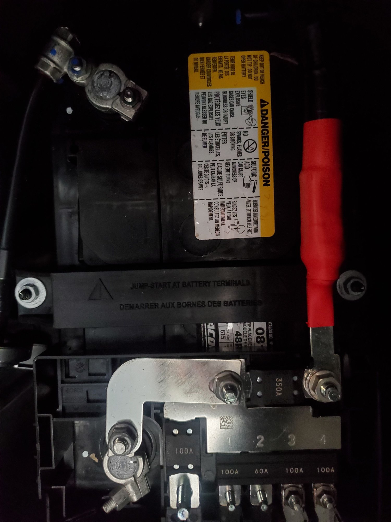

Go back over the battery installation. You may have a bad or loose connection or a blown 350 amp fuse.

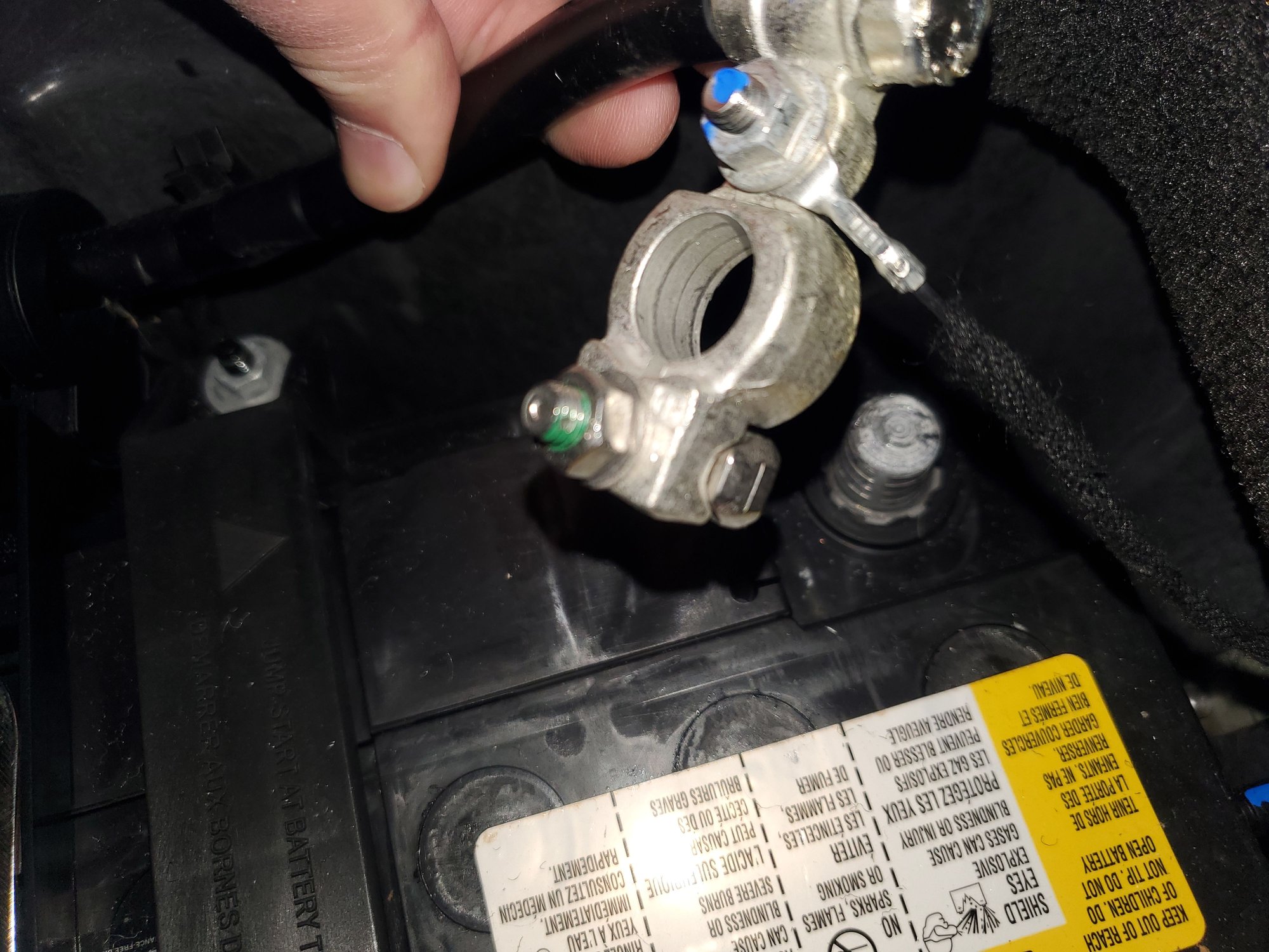

Make sure the battery cable clamps are pushed down, horizontal, and tight. Make sure the red cable ring lug is firmly attached to the 350 amp fuse - good mechanical contact, flat, and tight (see pic below). There have been lots of frustration with these connections when changing a battery - something may have come loose. Again, the ring lug on the red cable attached to the 350 amp fuse must make good mechanical contact with the fuse tab, then tighten firmly. The cable fits down into a notch in the plastic frame of the fuse assembly. There's also a small black sensing wire on the negative battery cable clamp that can get broken - important for charging, but not your current problem (see pic - bolt is painted blue).
Check the fuses on top of the battery. I would measure voltage from ground to positive battery terminal, then to downstream side of each fuse for comparison. Obviously the voltages should be the same. If all is good, measure at the front fuse box input terminal on the rear side of the fuse box to ground. There is some kind of small panel below the fuse box with fusible links for the starter and power steering - but if you have no lights, dash, or anything I doubt you have power to the front of the car.
There is also a fuse panel under the rear deck where you can check for power if there is power at the battery fuse.

Small black sensing wire connected to negative battery cable.  See blue paint spot.
