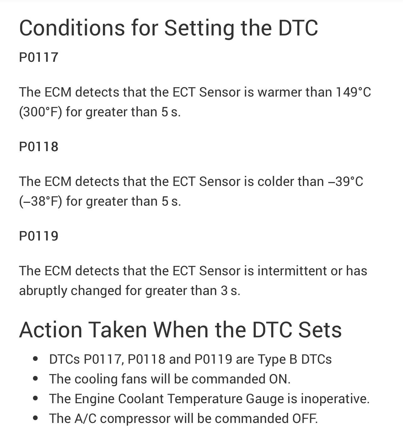

A broken current sensing transformer wire will not cause what you’re seeing…also not all P or Powertrain DTC’s will illuminate the MIL so you will need a scan tool to check…type B DTC’s have to fail two times in a row for the MIL to turn on…for a P0117, 0018 or 0119 you can see what happens when either of those 3 DTC’s set…cooling fan commanded on, ECT gauge inoperative and AC will be off…seek out an automotive electrical specialist in your area to diagnose this.
