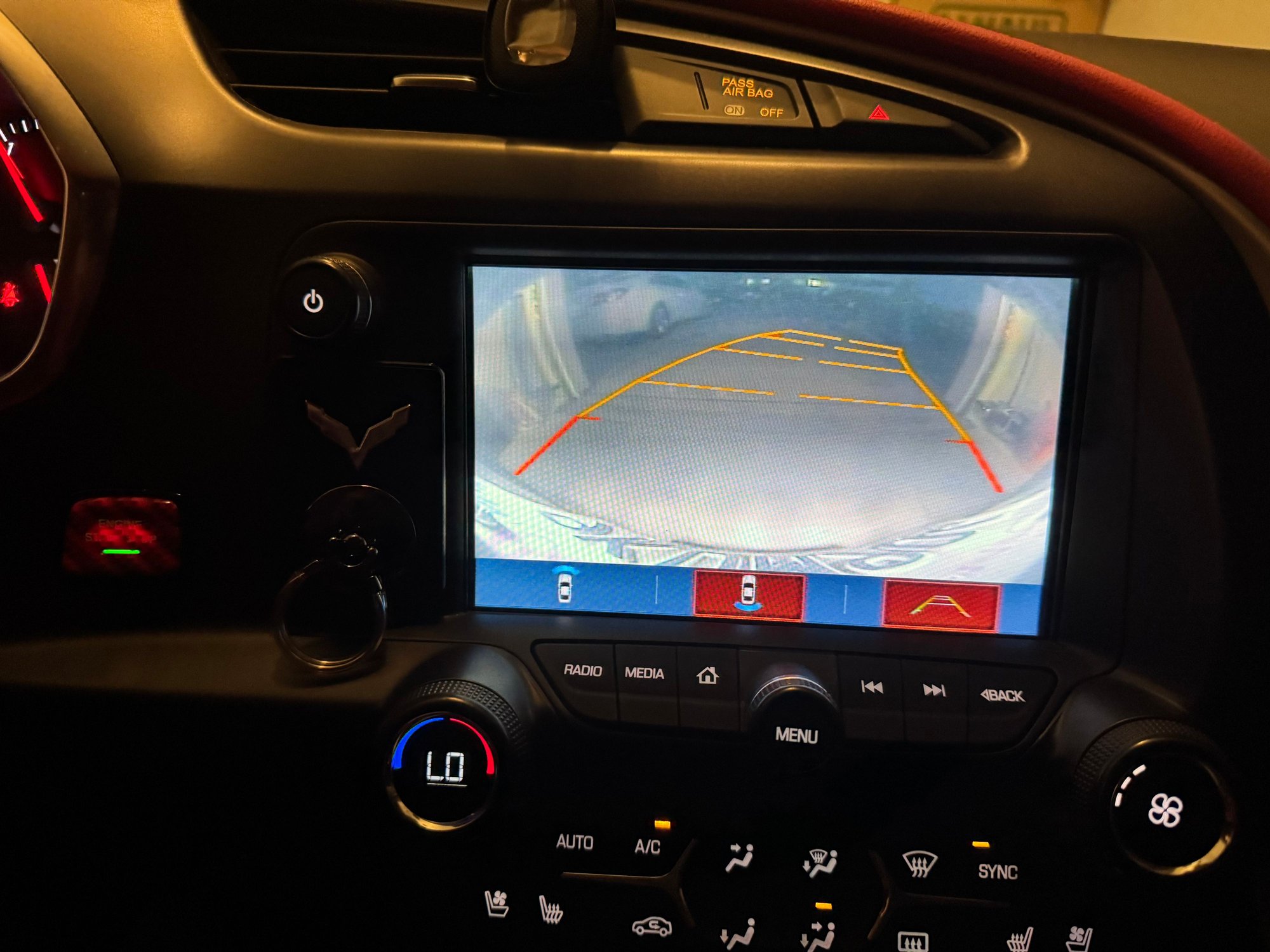

I installed an aftermarket carbon fiber steering wheel. Completed the button swap & RPM display. I buttoned everything up and started the car no problem. All buttons worked but noticed wheel was saying it is turned to the right when it is straight, even though I put in correct direction of key slot.

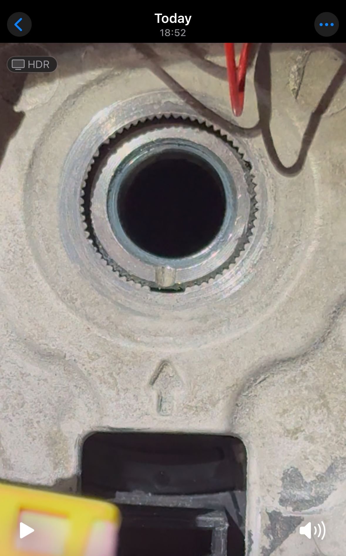

I figured out how to correct this by slightly adjusting the wheel on gear click on 2nd time taking apart wheel. However after installing it was in the wrong direction.
As I wait for the battery to drain a 3rd time, my question is; can I plug everything in except the airbag, start up the car and be able to test the wheel alignment? In the event that if I need to remove again, I can faster? I will unconnect battery when installing airbag correctly. Removing the airbag is the hardest part. I have an Inova 3000 OBD reader for codes that may pop up after everything is set correct.

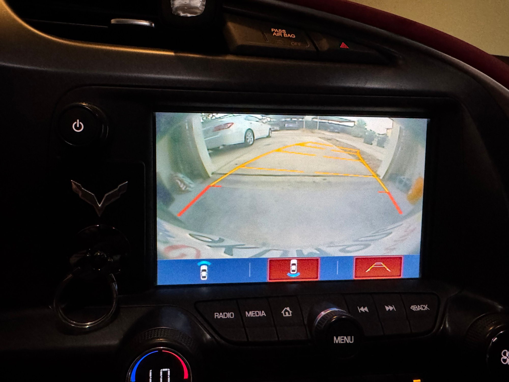

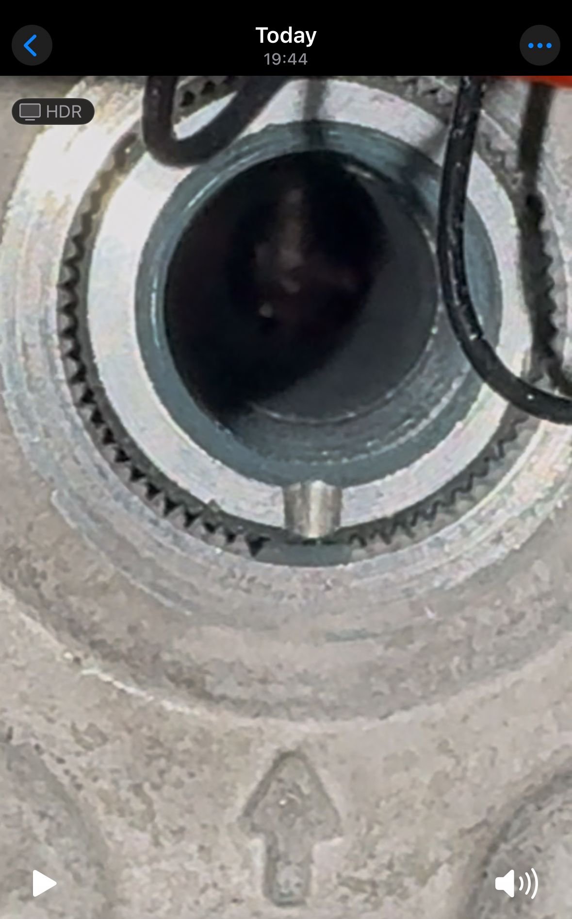

Here are some photos when I reinstalled the key slot location. I don’t know what wrong. I uploaded the images in order of attempt & what the backup guidelines show me

Issue was my clock spring. It was one rotation over to the right. I centered it and the backup guidelines work as intended and I have full steering capability in both directions. I noticed plastic crumbling/clicking noise when turning but there is no warning sign on my dash. I’m assuming the wiring inside the clock spring needs to get adjusted but I’m hoping it’s not damaged.
