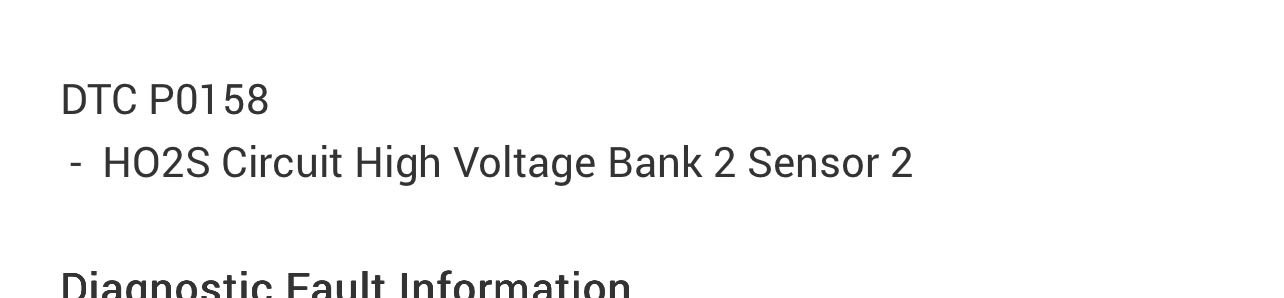

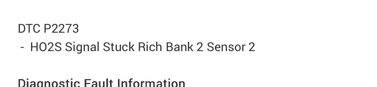

Below is what sets those 2 DTC’s…with the car running at idle and at operating temp the Bank 2 Sensor 2 should be fairly steady between 600-800mv’s…if you see something close to 1 volt (1000mv’s) disconnect that sensor (passenger rear) and see if you see the 450mv bias voltage reading scan data…if you see 450 the sensor is bad…if you see close to 1 volt you have a wiring issue…possibly the 12 volt heater circuit wire is shorted to the signal wire…the scan tool will only show a little over 1 volt but you won’t see 12 volts…there is NO programming for an O2 sensor and PLEASE don’t go to a dealership for a diagnosis…they’re IDIOTS !!
