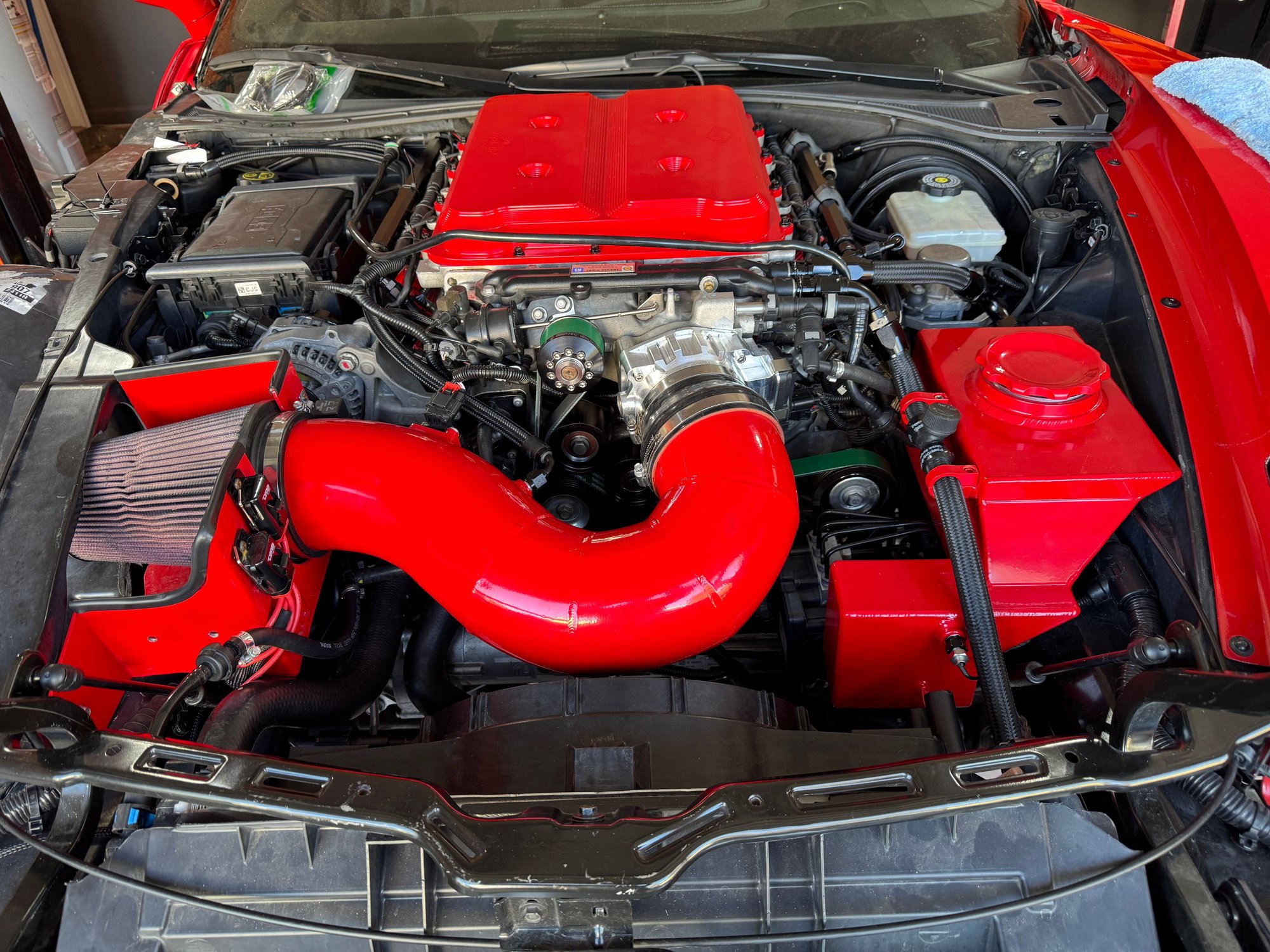

recently built motor. cam lifters springs pushrods vvt delete and dod delete . motor is in the car fully assembled z06 lt4 blower port injection all pulleys belts etc exhaust everything is assembled. I have now come to the realization that the motor is completely dry and it's a dry sump. fill the dry sump oil may get to the oil pan but not the critical parts on initial start up.
low profile valve covers I do have access to ports but doubt it will drain down to the cam and parts
how can I prime the
motor before start up?
