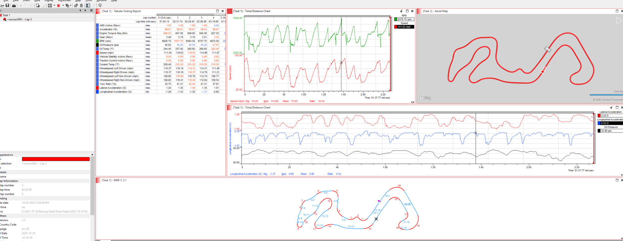

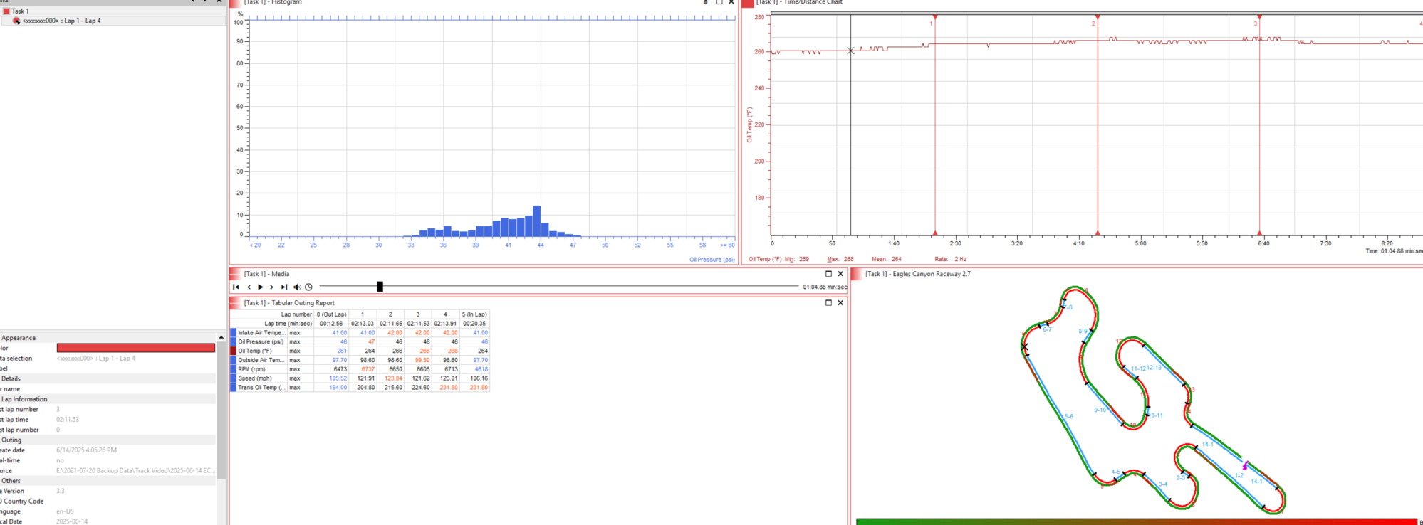

Use Pi Toolbox which is also made by Cosworth. They have a free version. Total crap regarding the user interface but once you get the hang of it, it does a lot. You can graph, chart, etc all the data the PDR captures and sync it against the PDR video as well as GPS created track maps.
1% of what you can do with it.....
I was looking at some temp and pressure data on a different track
