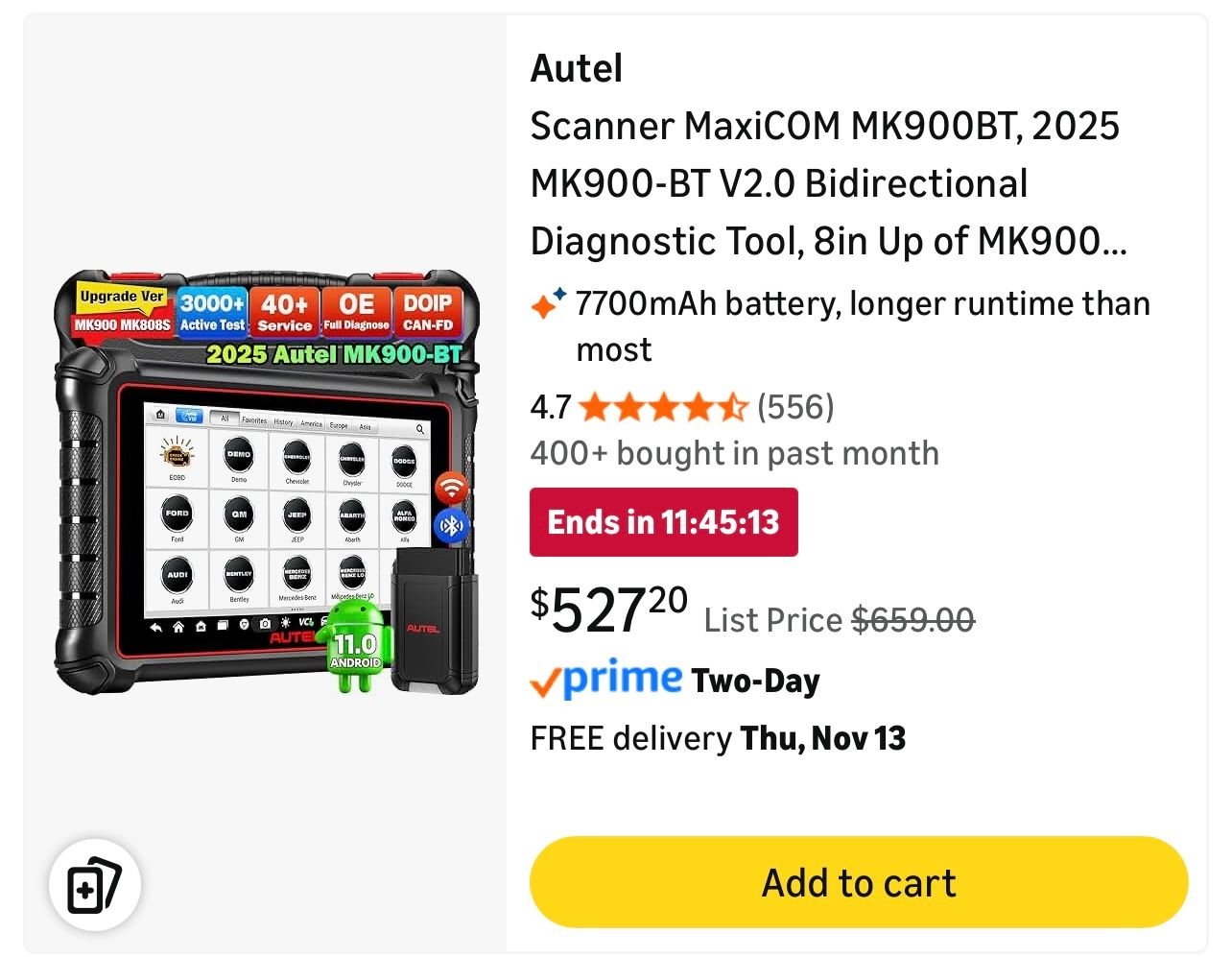

Any suggestions on a GOOD scanner?
Old Nov 11, 2025 | 08:22 AM
C5 Diag's Avatar
C5 Diag
Moderator, Tech Contributor
Posts: 15,435
Likes: 3,982
From: Cape Coral, Florida
This Autel is good and has a Bluetooth VCI.
