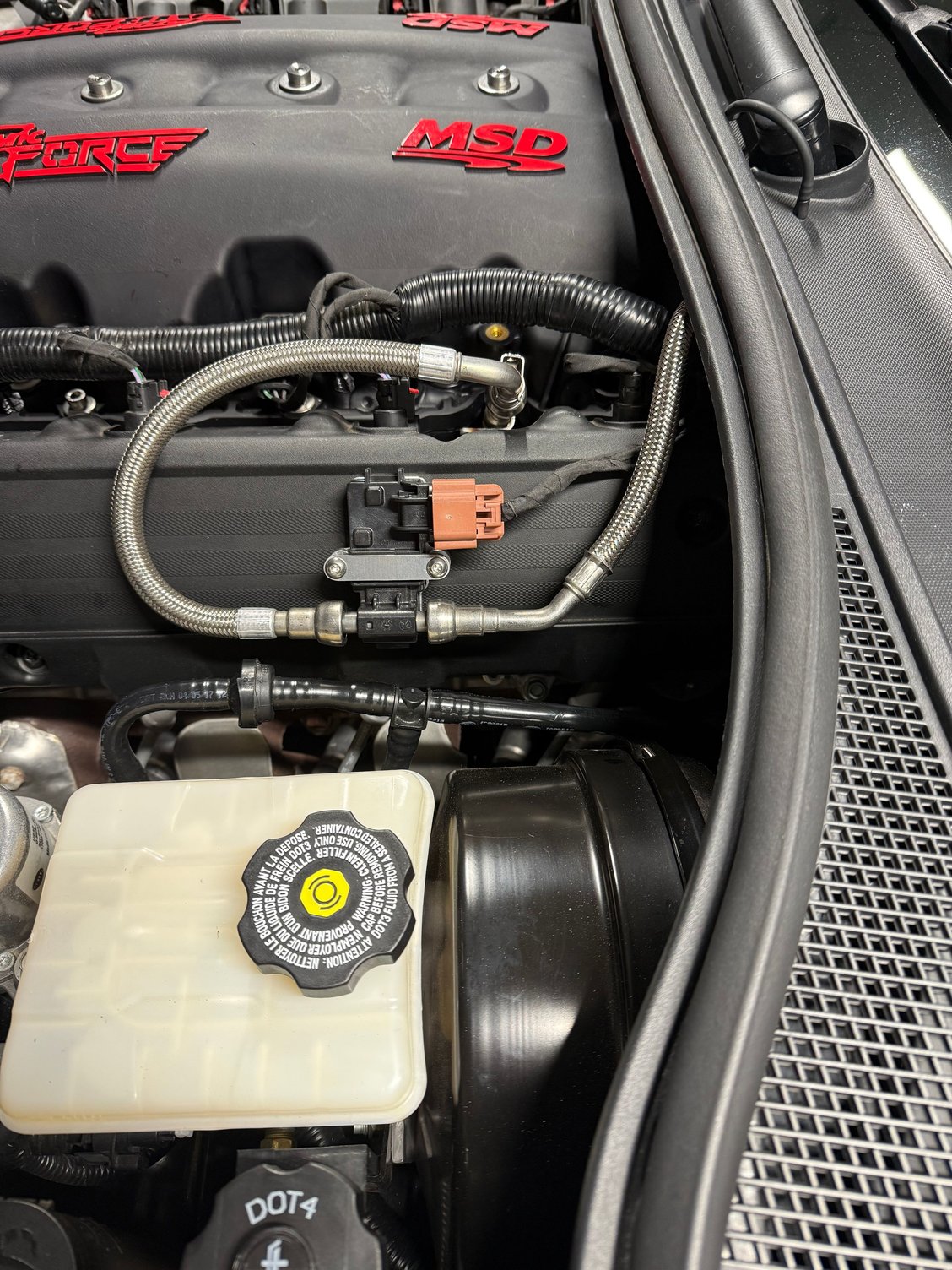

I also installed the lethal garage flex kit on my ‘17 GrandSport. I wasn’t a fan of stuffing everything behind the engine like their YouTube video show, floating around back there.
I tried to do it that way and It seemed to put a lot of strain where it connects to the hard line by the firewall. I wasn’t comfortable doing it seeing how it’s a fuel line.
I ended up buying a nice little aluminum bracket off eBay for $20 and attached it to the coil cover. I’m still not a fan of how the stock fuel line is but it should be fine for now. Seems to have less stress on it now. It looks like their website picture of a C7.
Also getting to the ECU to pin it was a project. It’s in an awkward spot to remove especially with the lower side skirt. And the harness they provide is just barely long enough.
Im just waiting for the weather to clear so I can get it tuned March timeframe. (ARH Longtubes, catted X, MSD intake, Tony Mamo TB, and E85. Hoping for 475hp.

Do you have a link to this bracket you used? Looks like a perfect fit for the sensor.

The bracket worked perfect. It was made for the GM sensor. The picture in the ad doesn’t show it, but it also came with two screws and two nuts to mount it as well. I just added two bigger washers to the back of the coil cover to help distribute the load. See link:
https://www.ebay.com/itm/256500647774

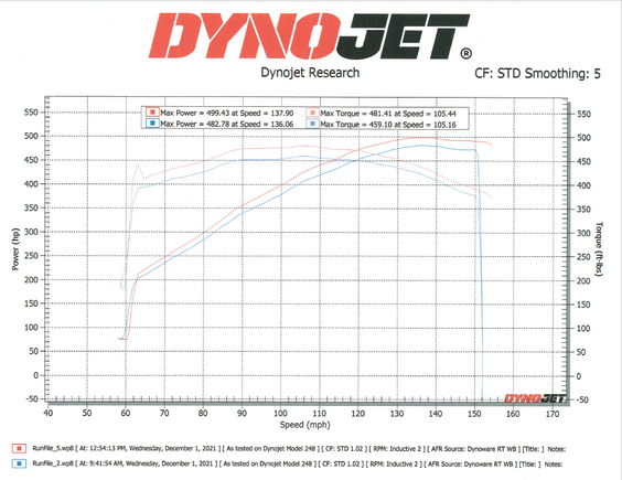

I had a little baby cam (unknown specs or manufacturer), soler tb, lth, this was mine when i went e85. Without cam, you might be close to what you are thinking

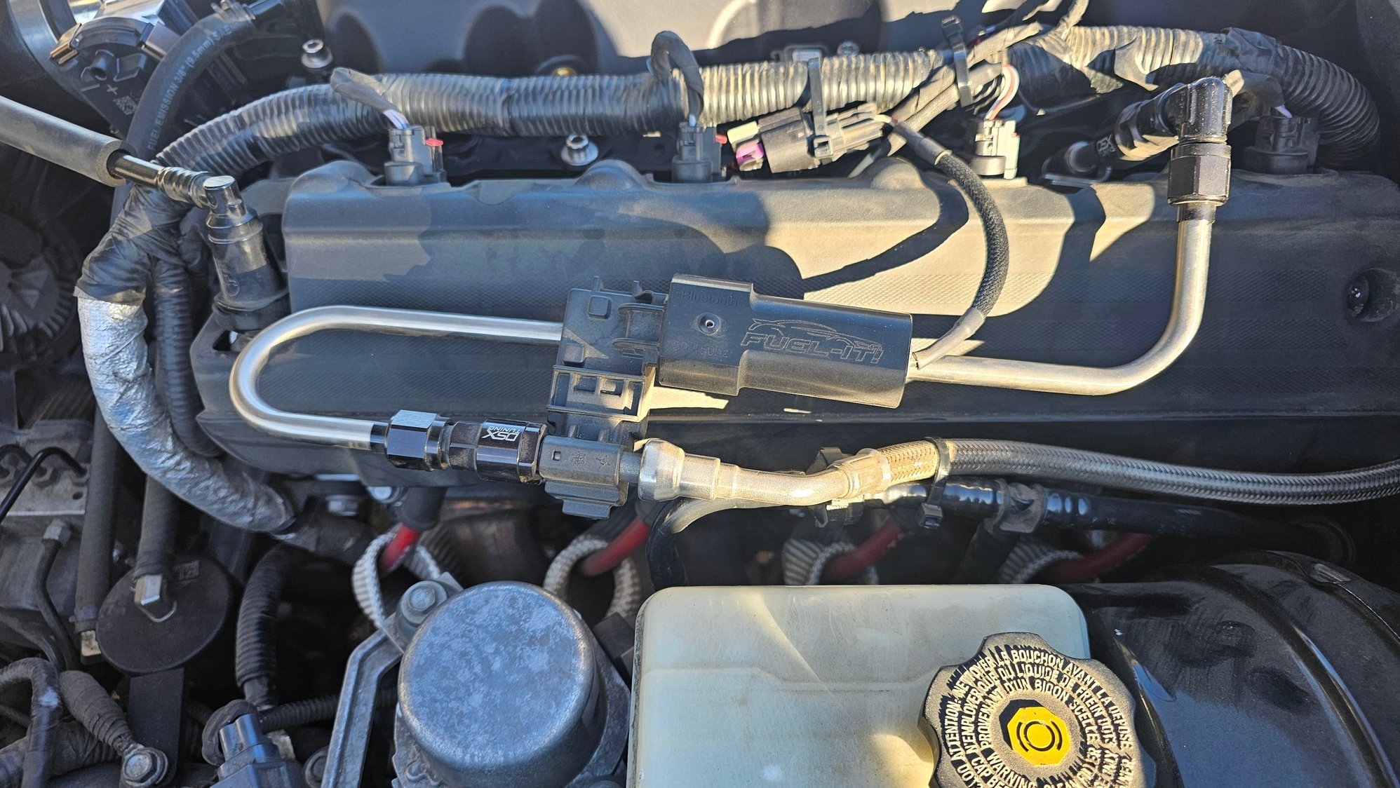

I get what you are saying but its what my shops uses/used at the time. Actually now I am curious to how much it moves, after I finish my adult beverage at the bar will pop hood and see

My shop likes DSX stuff also and I'm sure it's good stuff. It just didn't sit well with me how they it is out in the open like that. From a visual standpoint I like things a little more tidy and less likely to be bumped/hit if working on the engine bay.

Ignore dusty engine, its on hit list. So it moves about half an inch
