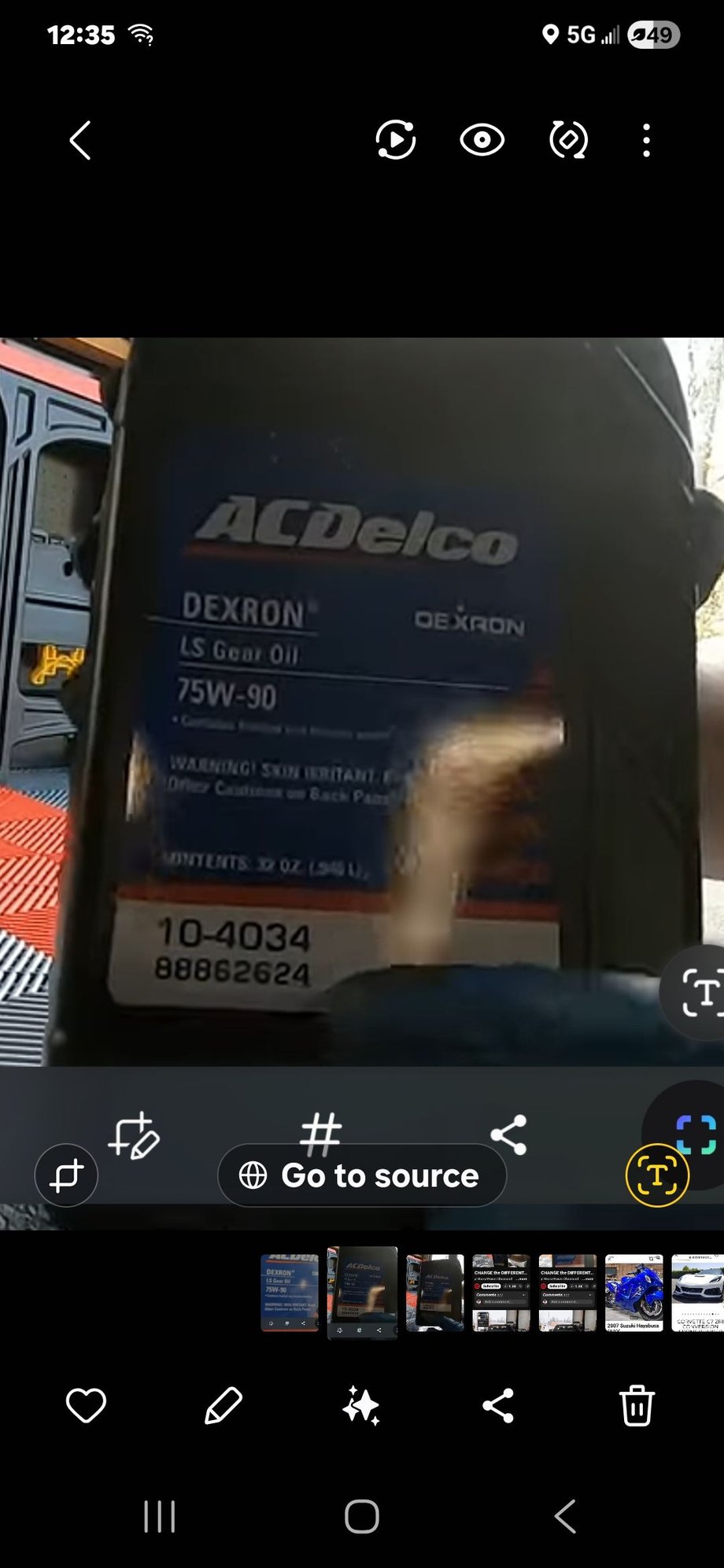

Shopping for rear diff oil and came across the ac delco brand 75-90 and it's $36 a quart.
I've found some mobile 1 brand that's way cheaper that has the limited slip additive in it just like the ac delco brand. My question is, will the mobile 1 work?
