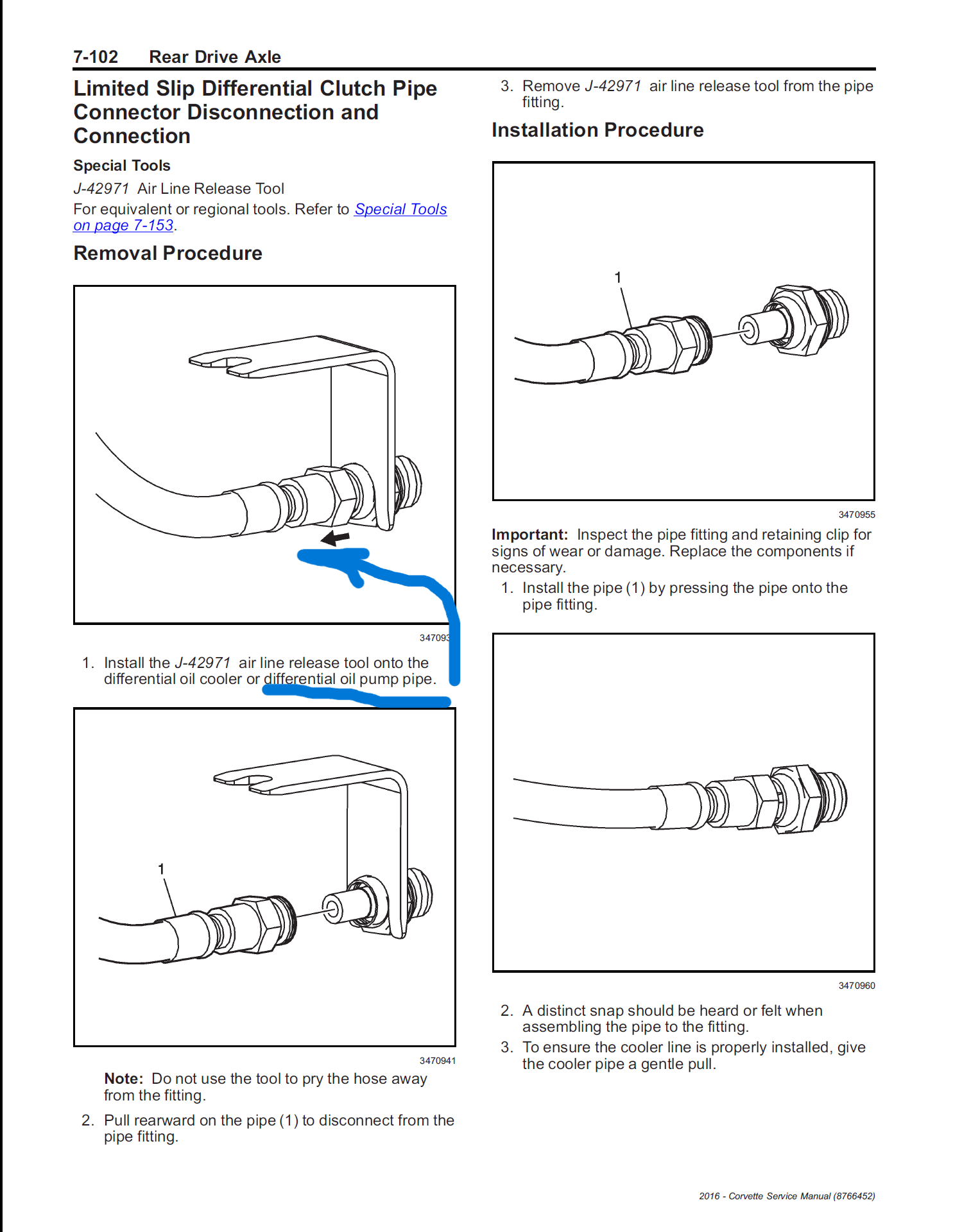

If you can find a stock Differential Oil Pump Pipe, all you need to do is install the pipe in place of the original and do not connect the other end of the pipe so fluid can drain out of it. The tool is the connector used on the pipe and some tubing to permit draining. Another way of doing it may be to disconnect the other end of the stock hose from the oil cooler and collect any drained flud dripping from that end.
