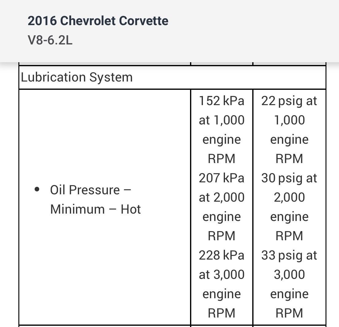

What is the lowest oil pressure allowed for a 2016 Corvette Z51? Just finished a complete rebuild and tech wants to tear it back down to bare block cause we're only getting 20psi oil pressure at warm idle.

You don't need a GM Tech....you need to look at Service Information !!...info below.
