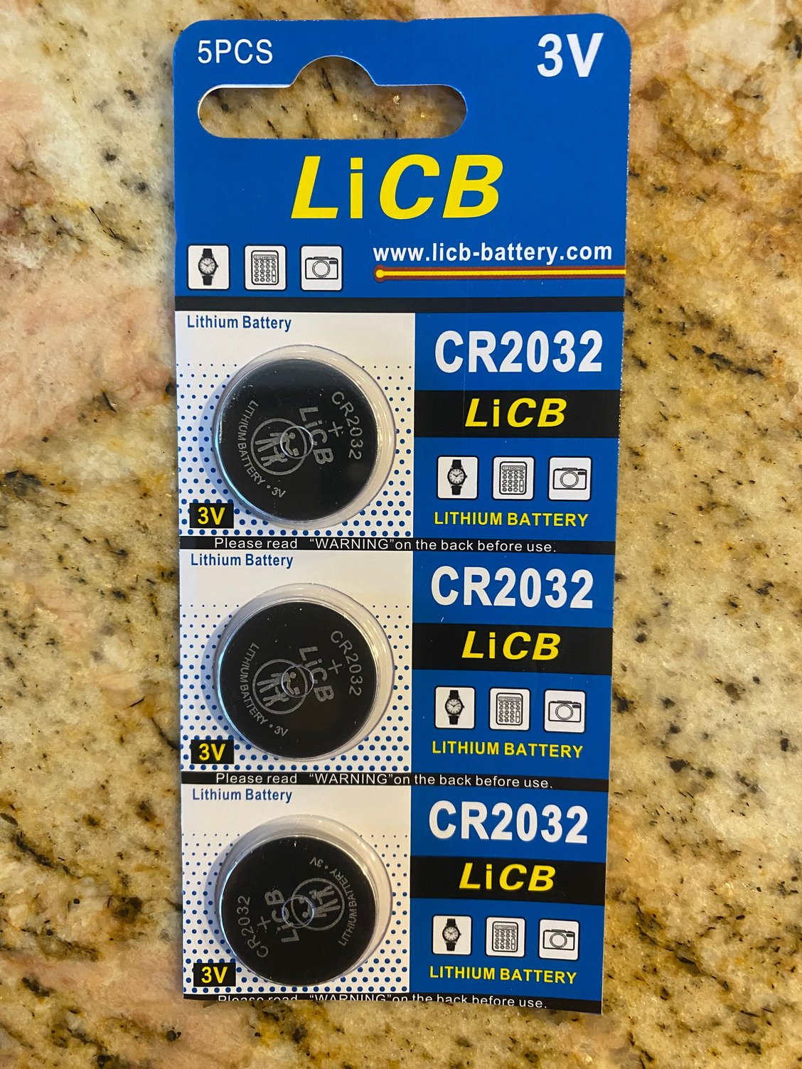

Ordered new LiCB batteries on Amazon.
Checked voltage and 3.13-3.22 voltage.
Installed just now and the remote feature still doesn’t work, just lights blinking.
