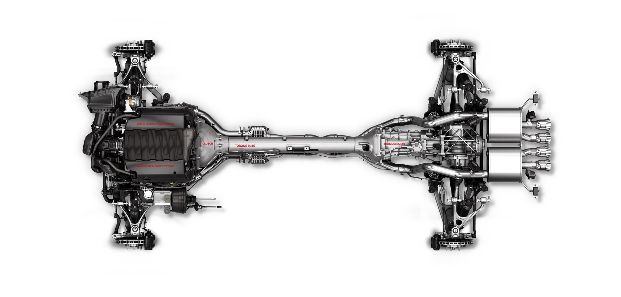

The clutch is on the back of the engine. The transmission is in the rear, bolted to the transmission differential. The torque tube connects the two. Almost zero chance of transmission fluid leaking into the clutch. Have you ever checked the clutch fluid? Changed the clutch fluid? Search for Ranger method and at least do a partial clutch fluid change. I use Prestone DOT4 brake fluid. Not sure this will calm down the clutch but will improve clutch engagement / disengagement.
