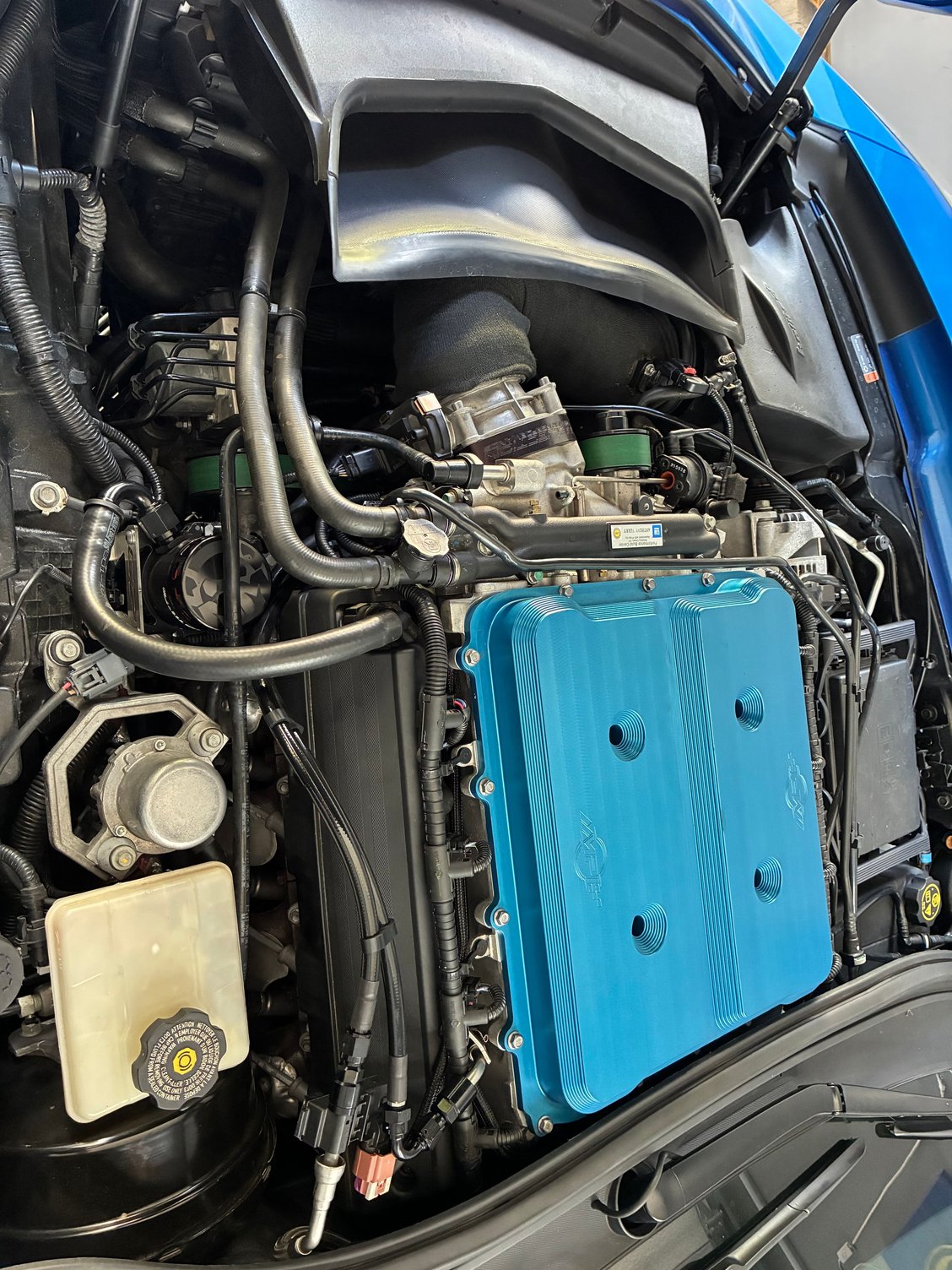

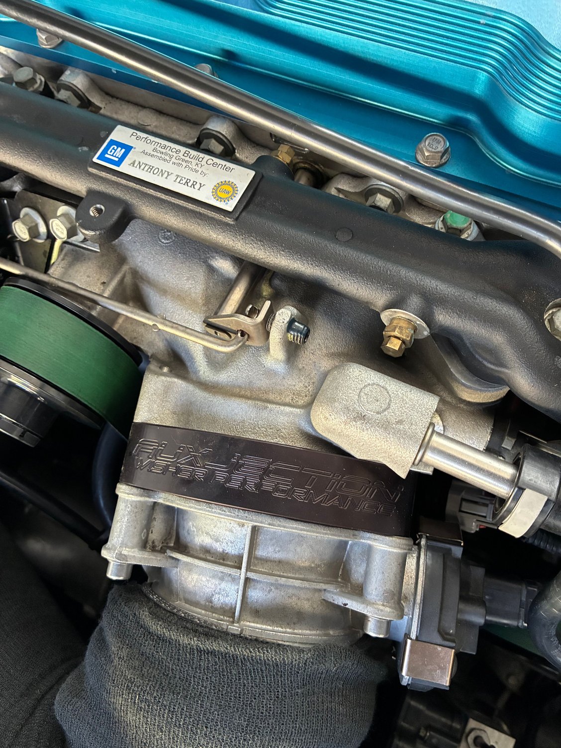

I have had the AuxJection installed on my 2016 Z06..so far it has been a perfect mod. I had already done a BTR stage 2 SC cam, supporting mods, ATI lower, MPI sc lid, Halltech intake, MM catch can, x pipe with AWE touring exhaust, DOD delete, etc…car made right at 650 whp before. After AuxJection and a DSX low side fuel system, and and revised tune for the system and full E85 she make 750 or so whp. This is without headers and with stock cats! I wanted a road beast but don’t track it do any racing..this was the perfect mod to be able to run full E85, engine runs cooler, and runs much better!! Love this Wisher Performance and AuxJection!! I highly recommend it and the guy behind it!! Check out their web-sight and social media for all the testing that was done!!
Fuel lines leading to AuxJection
AuxJection spacer at throttle body
