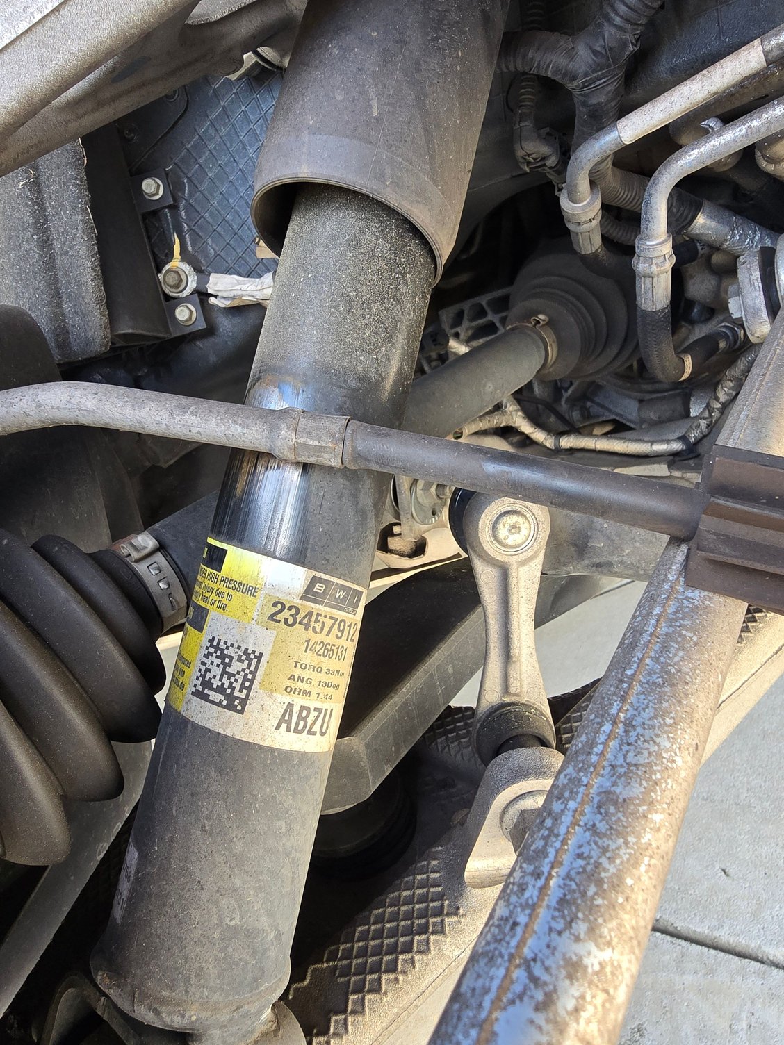

Do this look like a bad shock to you all. 2015 Z51 I continue to hear noise when I hit a bump

you mean other than the rubbing?

Who has worked on your Corvette? Noise from the line rubbing on your shock, probably.

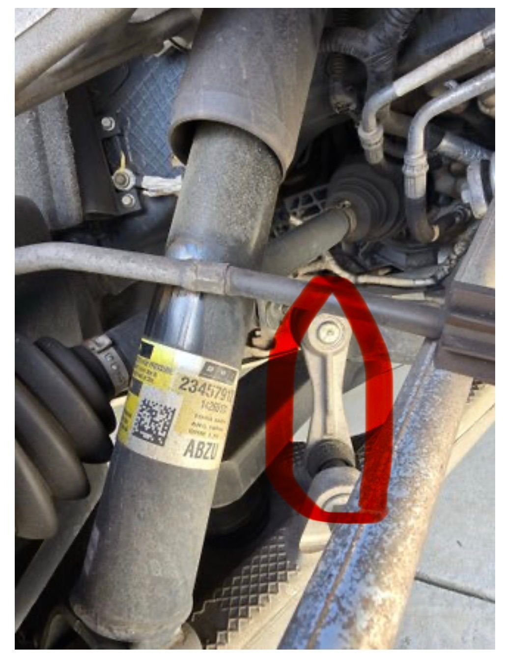

What kind of noise? Is it a a knocking or clunking sound? If so, the swaybar end rod links are notorious for this kind of sound.

Is the park brake cable touching the shock? If so, bend it slightly to get 1/4" clearance. It is also possible that the hard plastic protector up above is contacting the shock when the car is at normal height and going over bumps. They are a pretty tight snap into position fit at the top where the fasten to the aluminum black top mount. Maybe it is a little out of position at it's very top.

The wetness on the tube is within acceptable parameters of a good shock. I think 1/3 the way down is acceptable IIRC? I agree with the two possible causes mentioned above.
