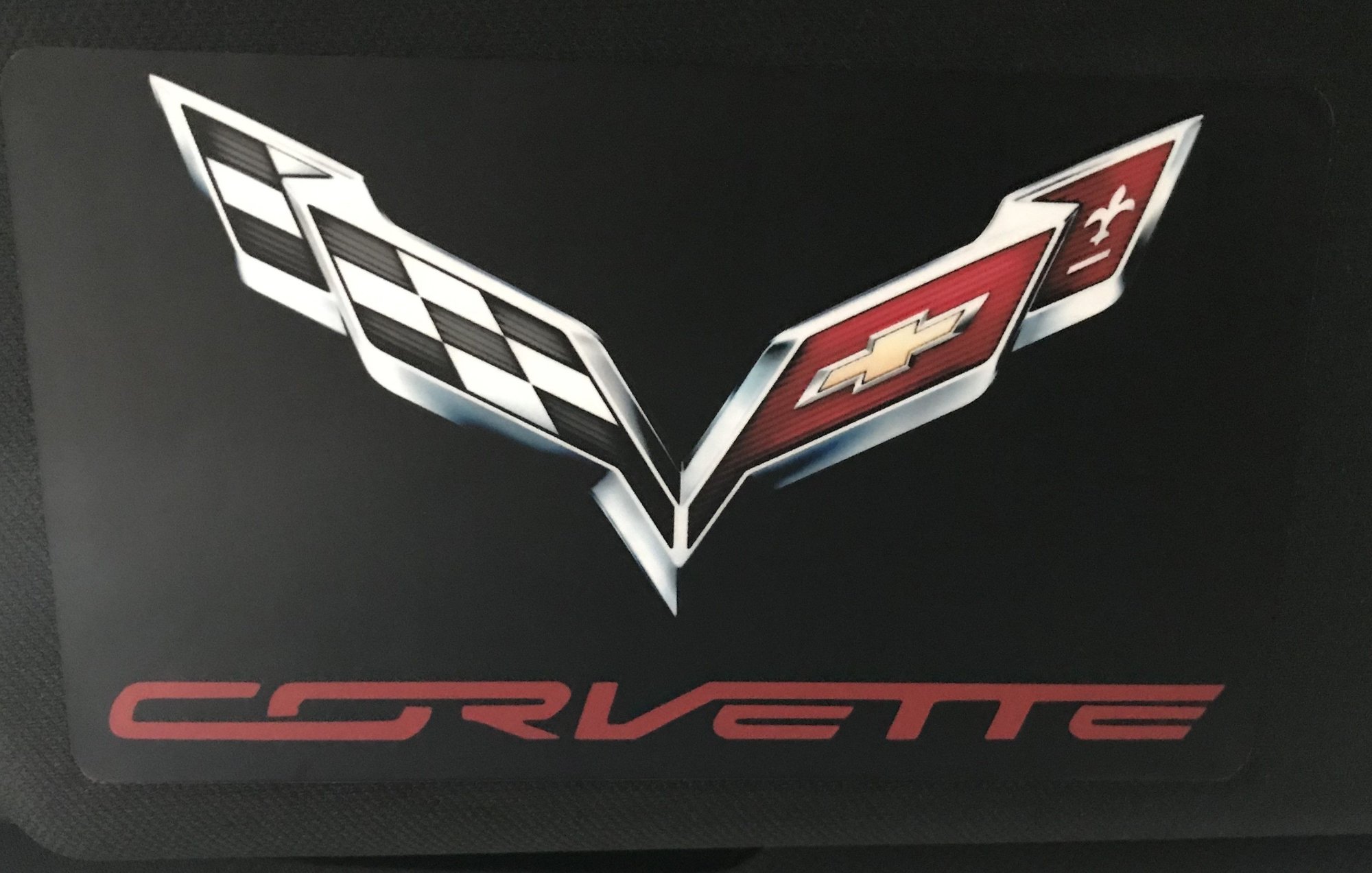

Old Apr 16, 2026 | 09:40 AM
kodpkd's Avatar
kodpkd
Joined: Jun 2019
Posts: 5,541
Likes: 2,219
From: Loveland
These are the visor stickers, you will never know they are there. The picture is way worse than they actually look.

Old Apr 16, 2026 | 11:02 AM
M61A1MECH's Avatar
M61A1MECH
Active Streak: 90 Days
Joined: Jul 2021
Posts: 824
Likes: 471
From: Edgewater, FL
Here is the decal I installed, I think I got it from Drew's Decals from Ebay.

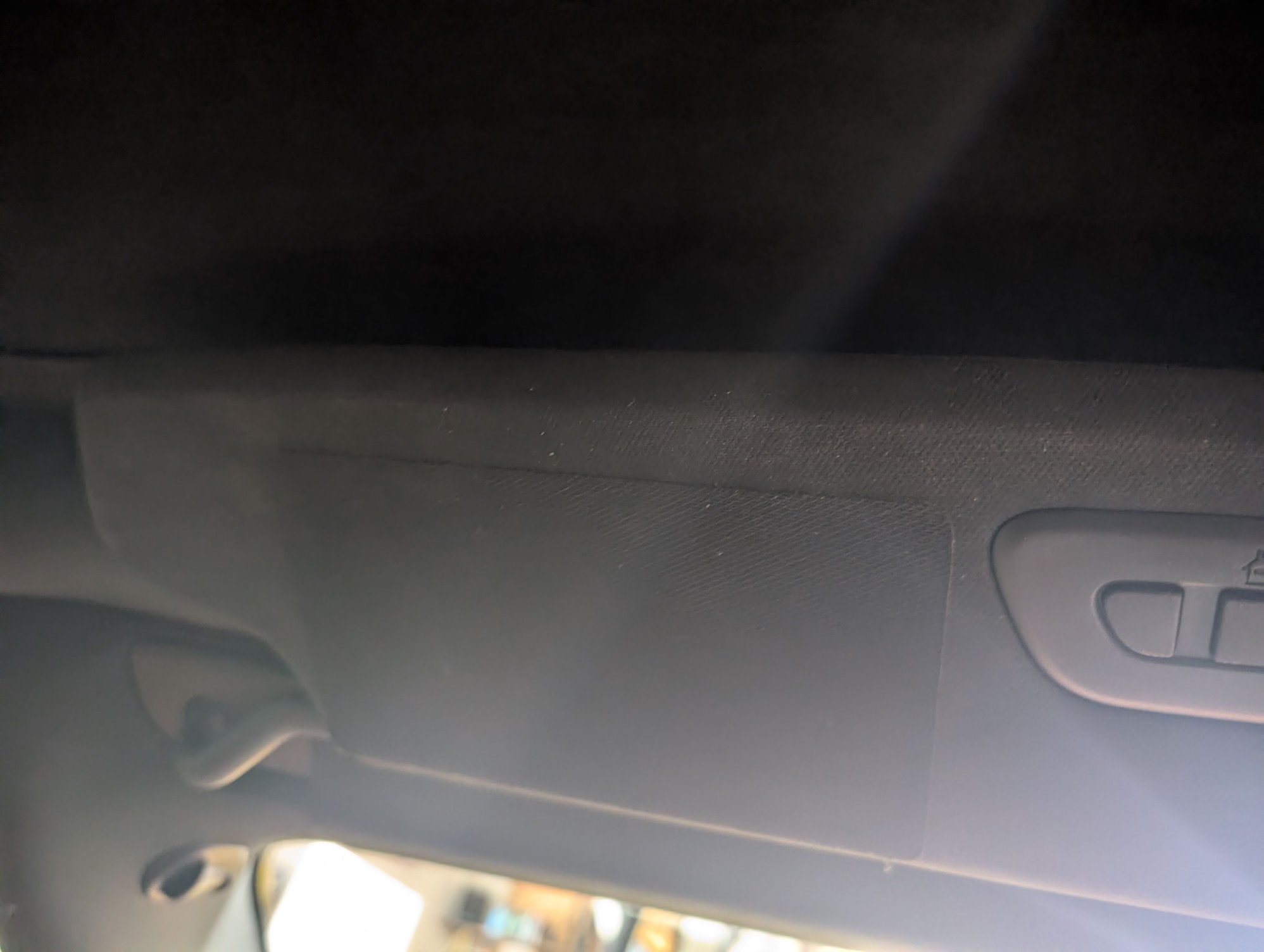

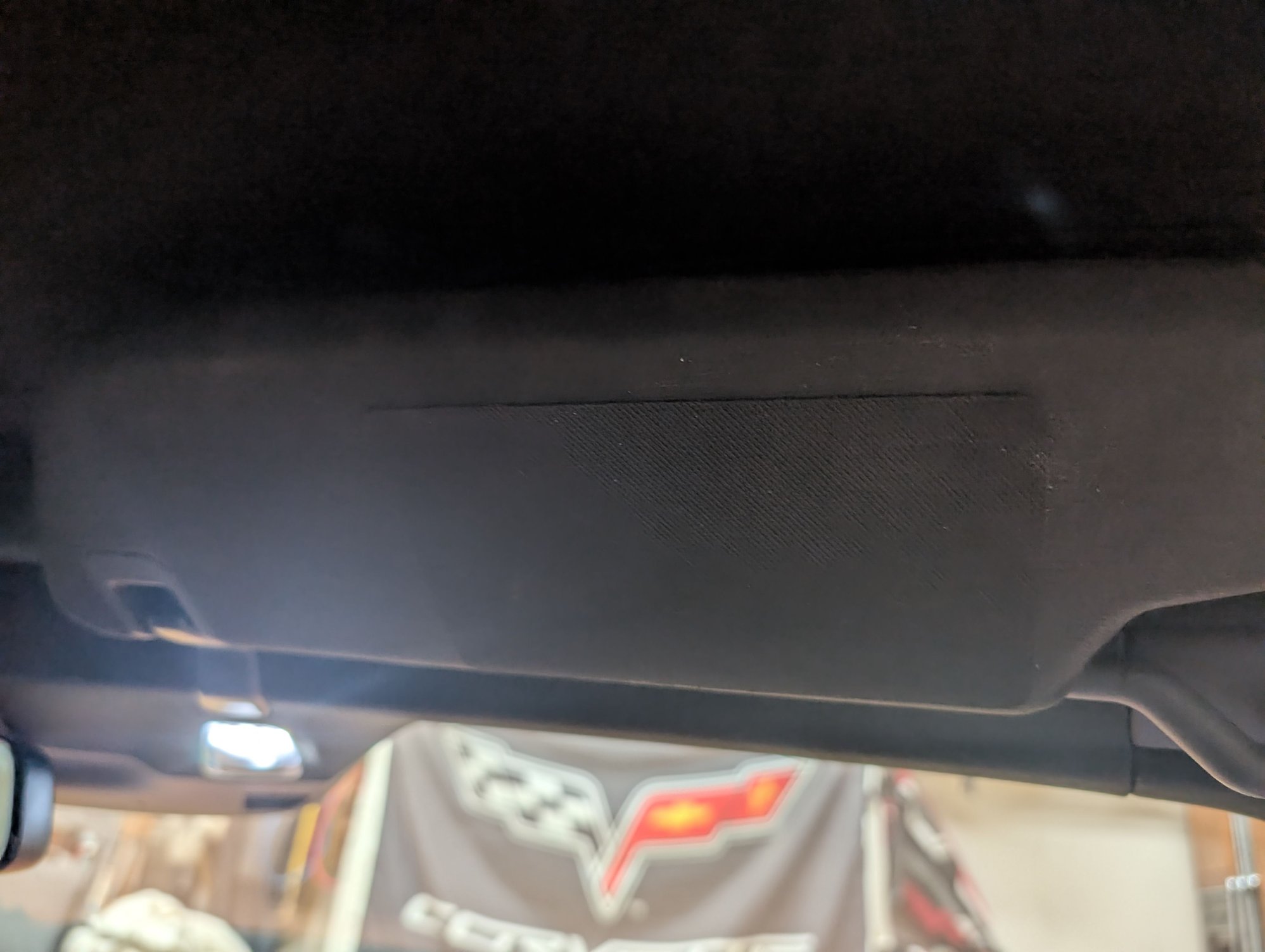

Old Apr 18, 2026 | 02:09 PM
mmartinez's Avatar
mmartinez
Joined: Sep 2008
Posts: 3,143
Likes: 803
From: Espanola New Mexico
Closing out the thread, I was able to remove most of the adhesive using Goo gone, sprayed it on a cloth and dabbed it on, waited about an hour and then rubbed it of with a textured cloth towel, way better then those stickers.
