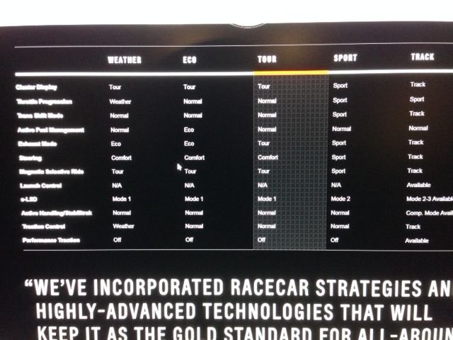

Trying to understand all the drive modes here. My exhaust and steering are set to track. As for the drive modes, beside exhaust control what changes from Turing to sport to track. Power? Suspension? Traction?. I have been in sport but I don't know why? I assumed the only difference was the level of traction control. Am I wrong here.

According to the manual, the driver mode can affect cluster display, throttle progression, Trans Shift Mode (if equipped), AFM, Exhaust Mode, Steering, Stabilitrak, Electronic Limited Slip, Mag Ride, and traction control.

Here you go:
To Drive mode settings - what changes?
