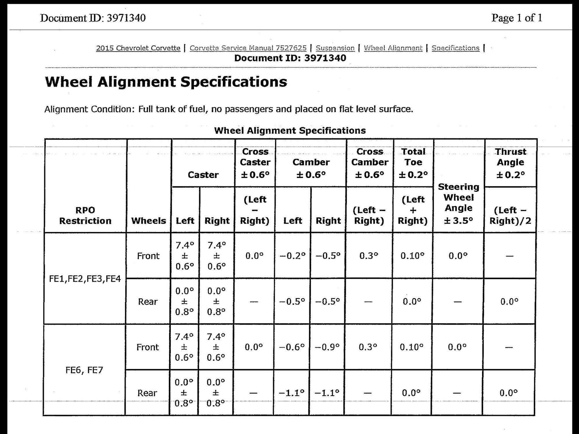

I had difficulty finding the street settings - funny that the manual provides the track settings only AFIK. I did find this on the other vette forum I recall, and it looks to be legit.
I had mine checked and while slightly off nominal, it was still in tolerance - they did not recommend adjusting unless I noticed uneven tire wear or the car pulling (not yet but only 1700 miles).
They pulled up the 2013 Z06 settings from their software and these 2015 values were slightly different.
