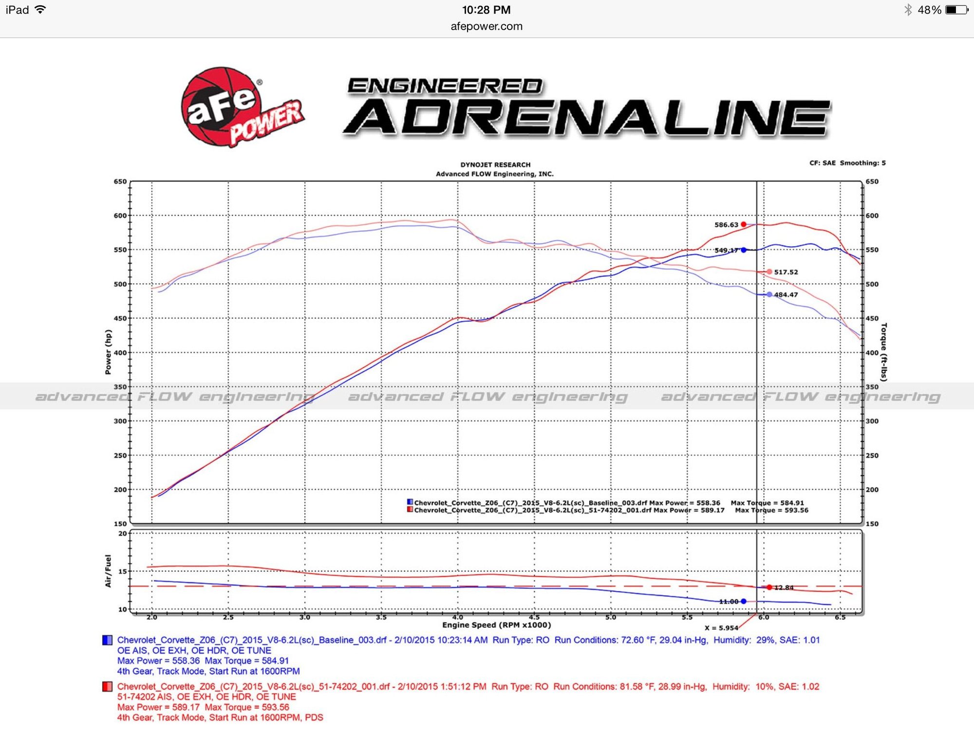

Put a AFE Kit today, you can feel the difference in "throttle response", also you can hear the "sucking air" of the intake too
PS stock tune!
Here is the dyno run from their website....that is an easy 30-40 hp for $600

I am no expert but does it seem that the increase in hp and torque only exists for a span of 1,000 rpm between 5,500rpm-6,500rpm?

Yup, so don't come out of that range...

But I also see an A/F ratio change from 11.0 to 12.84, how much power is due to the leaner A/F? and how much due to flow? Anyone have an apples to apples comparison? I'm looking for the upgrade and as usual want the best solution (with data of course).
