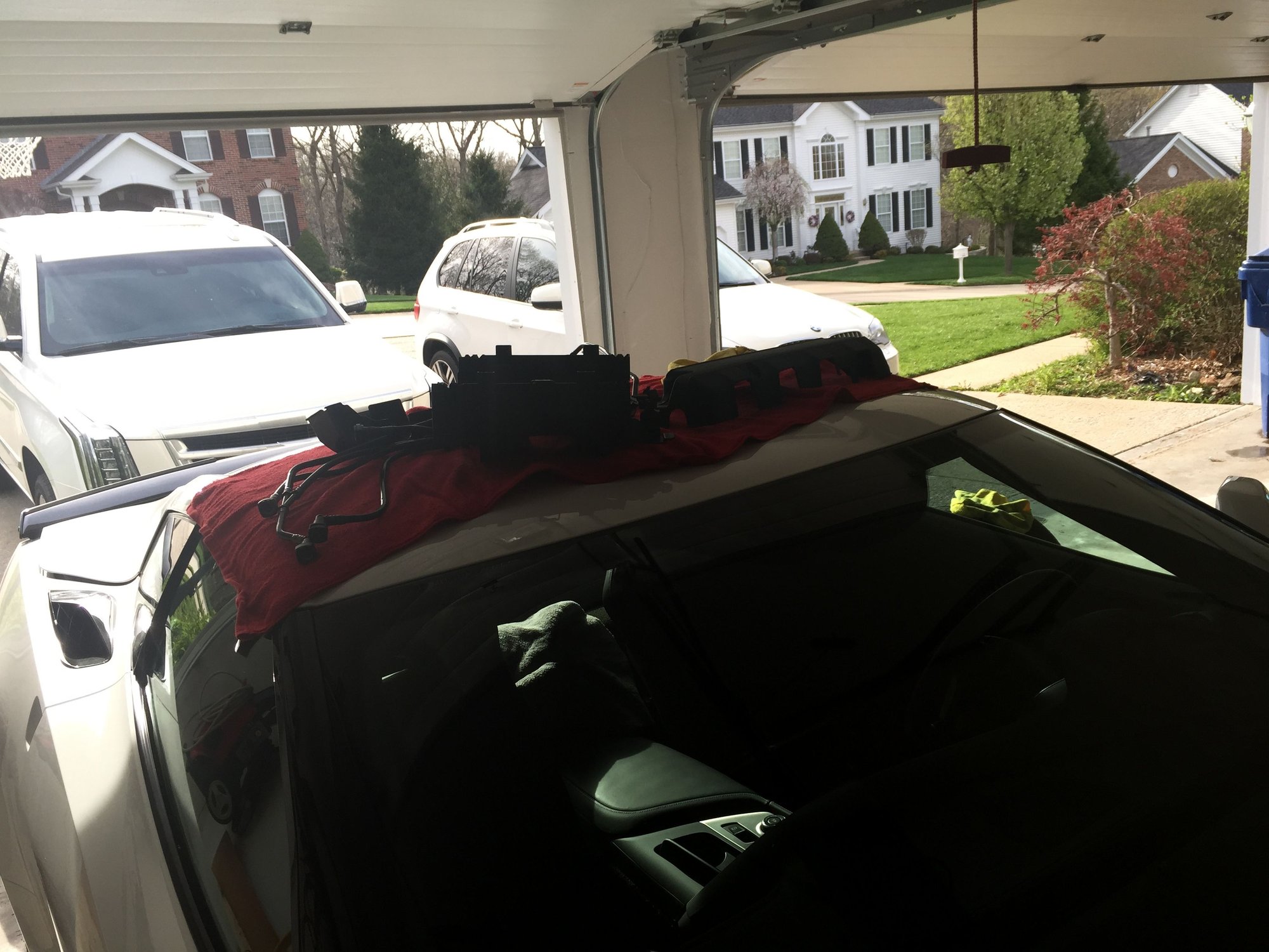

Got all the performance parts removed ready to go on the Z06 - was a beautiful day here's what I started with
Had a bunch of stuff to put back on the Z51 - luckily I had every single bolt and part for the job

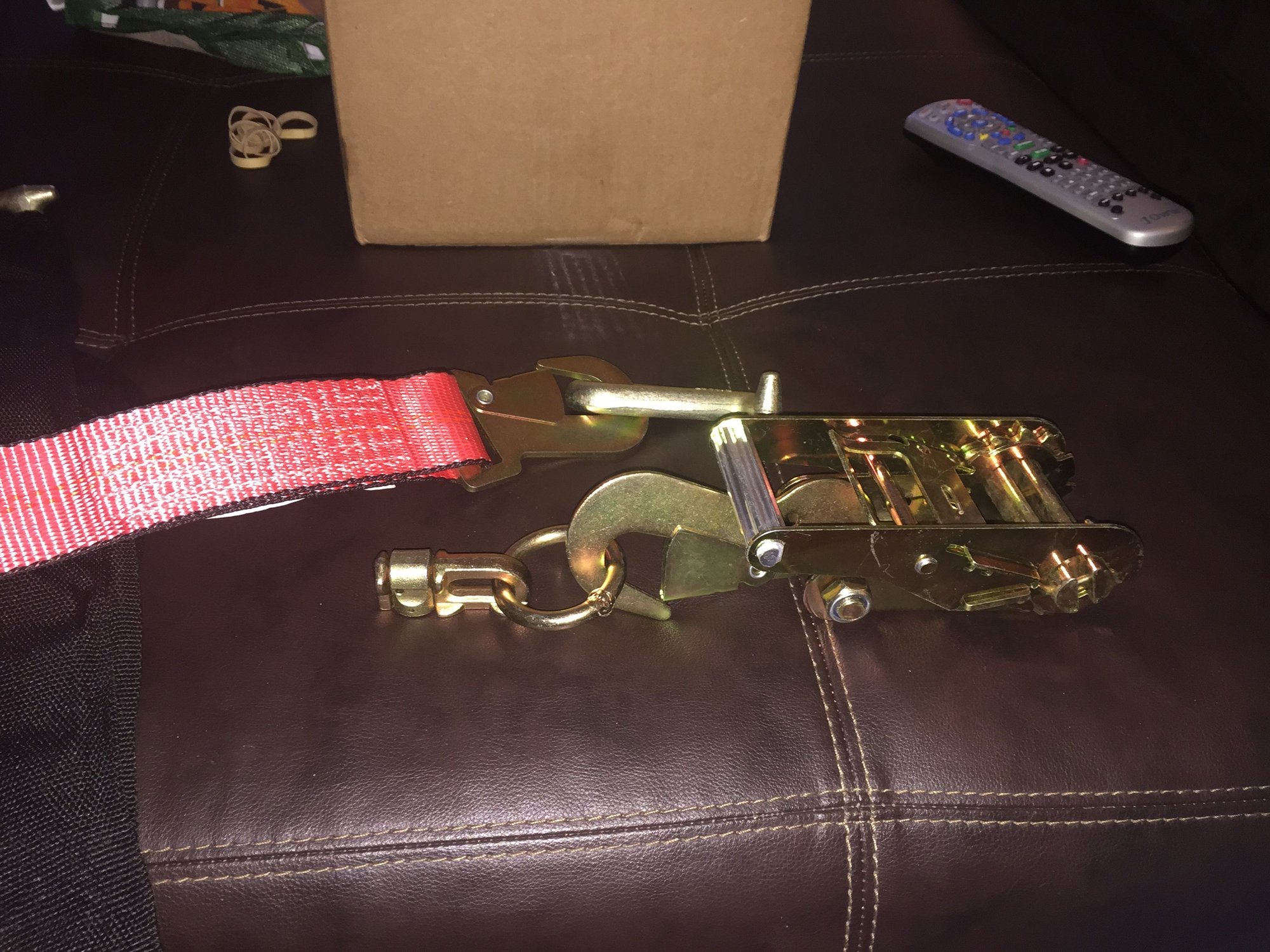

So I had these done up for trailering - I was going to strap the car through the wheels, but went to a wrecker truck parts wholesaler who told me that wheel straps (through the wheels) will cause strap marks on the wheels.
These will mount to airline recessed tracks in the floor (rated at 6000 lbs) - they are shielded with nylon - so once installed they won't chafe the frame and keep everything pristine - and really easy to hook on.
More to come.....
