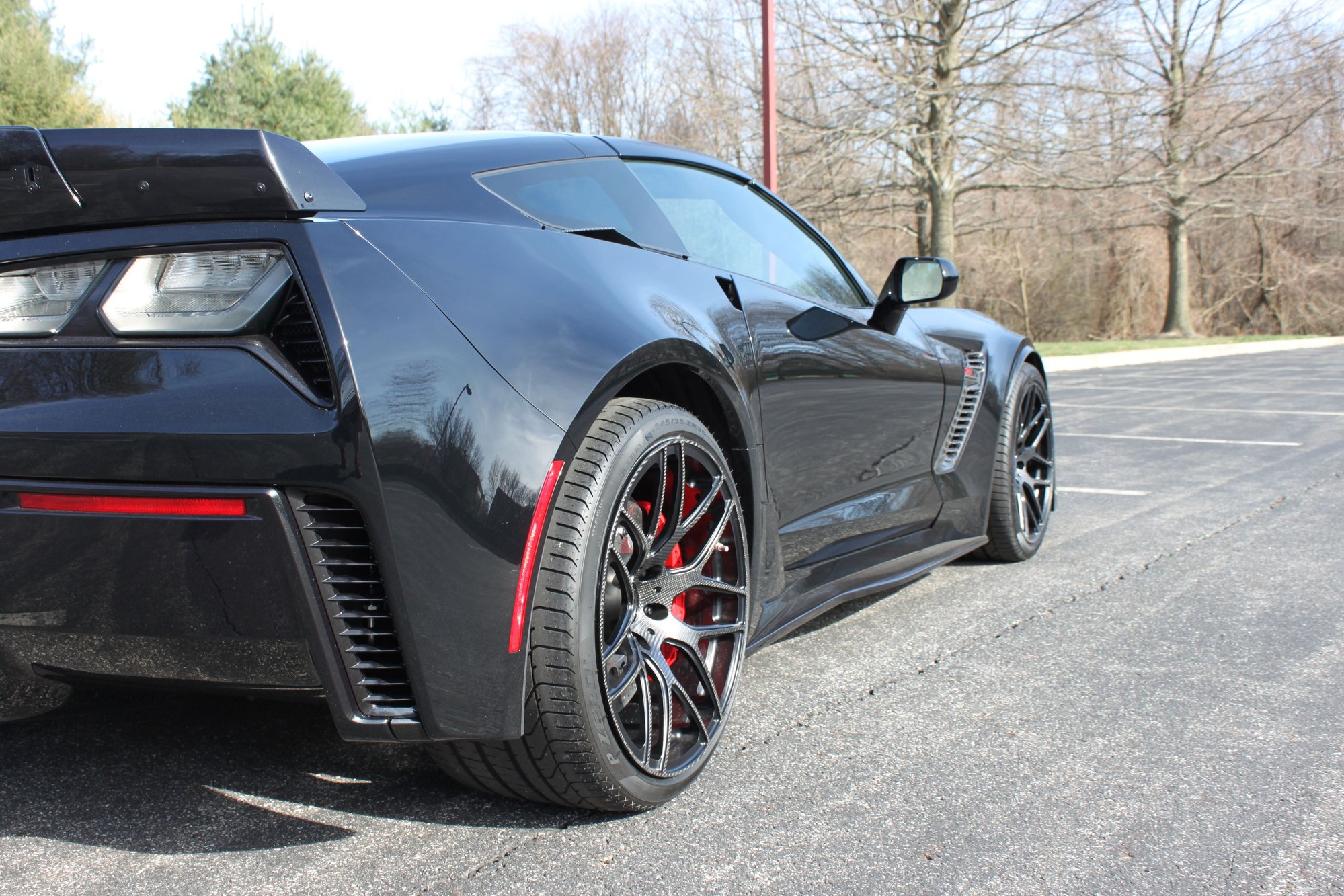

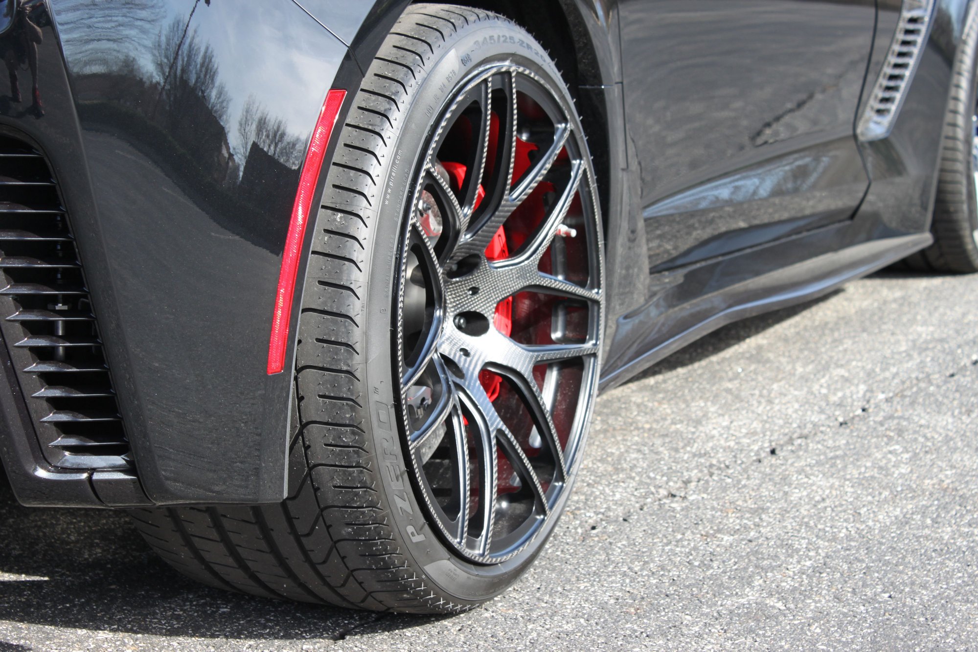

Check out the new shoes. Lowered but won't go down Z07.
