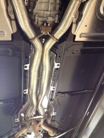

Ive posted pictures of the Corsa installed on my car (see below). It has perfect bends and double X welds. This is what Corsa and Borla do for a living. And they are good at it.

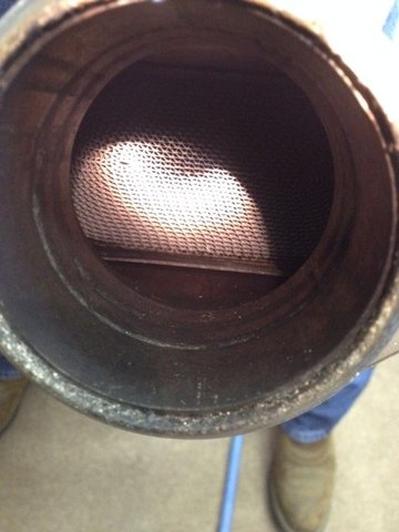

This is what the inside of the stock Cat looks like:

No CEL with the X pipe? Can you post picture of stock pipe? Thanks!
I agree with Brian. No sense in trying to reinvent the wheel when it already works great.

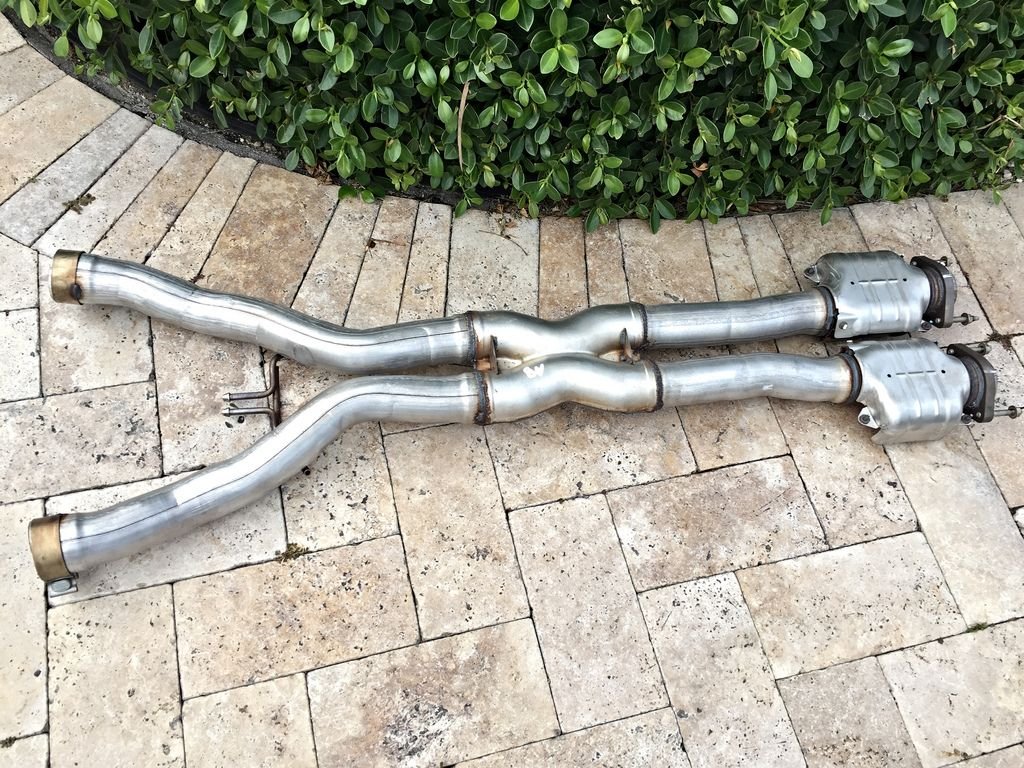

No CEL. There's no O2 band sensor to worry in the secondary cats. Everything is bolt-on/swap and clamps are also provided... and you just use the existing pair of doughnut flanges by transferring it from the old stock unit to the new Corsa.
Old stock mid-pipe removed:
