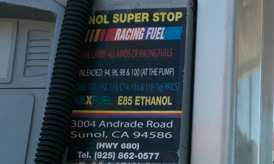

I filled up 94 grade E85 flex fuel about 14 gals, will it cause any problem to the engine without a tune or any system installed. please help....

If it runs it is way too lean and will melt down. If your running a new Corvette it is not Flexfuel and would need the capacity for over ~25% or 30% more juice.
Anyway, it ran?

I drove abt 50 miles, i felt little less power but smooth drive compared to 91, will drive a few more miles so that i can blend in more 91 regular gas to minimize damage if any, engine temp was abt 200 around 65Deg outside.

I'm not sure if you put 94 in or E85 though as they are different. The E92 PCMs are populated with flex fuel timing maps; however, you do not have a sensor and thus it is not turned on. While you're not running ideal timing for this and fueling will be off some due to the different stoich value, it is higher octane fuel. Regardless, just stay out of boost and run it out of the tank blending 93 octane if you can to dilute the ethanol content.

The pic on the pump says FLEX FUEL E85 , i selected 94 grade, So Im assuming its E85 with 94 grade. Im driving at low rpms and blending the tank with regular 91 grade fuel (only 91 grade is available in my area).

You pumped 94 octane unleaded fuel. Not E85. Their sign advertises several high octane levels from 94 to 100 available at the pump. Two rows down in yellow they also advertise E85. There is no such thing as 94 grade E85 which as others have said is comparable to 105 octane, allows very aggressive timing advance and burns cooler. BUT a specific tune is required to allow enough fuel delivery.

Thanks for the info, I guess you are rite the price was also $4.99/gallon (higher than E85), will check with them when i stop by there again, I was confused by all those labels advertised together.

If you filled up 94 octane gas, you will have no problems. Drive how you want.
If you actually filled up E85 on $100k car, please drain it ffs. Just siphon out as much as you can, and fill it up with regular gas! Do not drive this car on E85, you will ruin it.

You did get 94 octane, your good.... floor it and enjoy :-)
There is no such thing as E85 94 octane :-)
